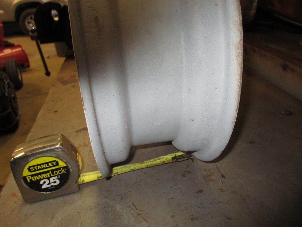

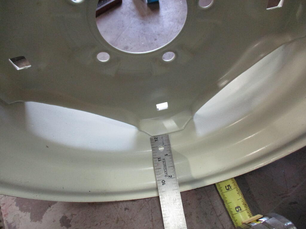

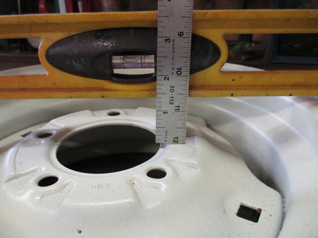

pfrederi 18,180 #8 Posted March 25, 2024 (edited) For 6.00x12 tires wheel horse used a 5" rim with a 1-3/8 inch back set (viewed from the outside the center flange ends just about an 1/2" from the drop center. Edited March 25, 2024 by pfrederi 1 1 Share this post Link to post Share on other sites
