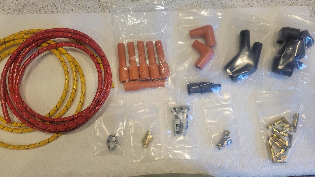

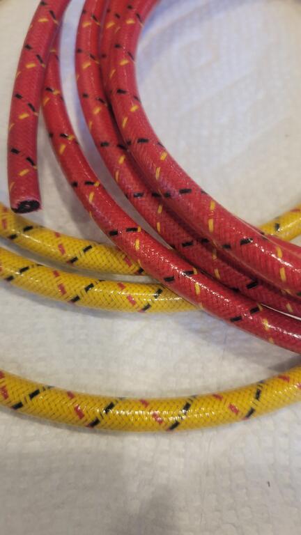

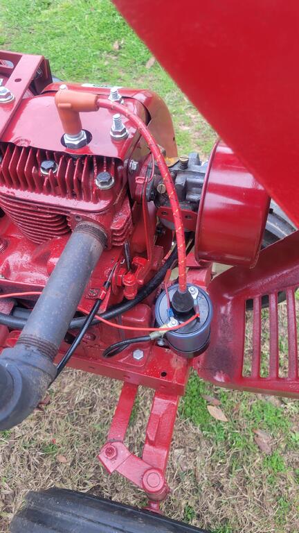

RED-Z06 2,479 #1 Posted February 15, 2024 Ive got 3 onans, 2 Kohler Ks, and ive never liked the selection of plug wires, ive been using V-Twin kits and shortening them down but most options i find are 'supressor' cored. I found this company called Tons Performance, they sell old style copper cored, cotton wrapped, with a scuff cover, and a variety of colors, patterns, boots and connectors. I got enough to do 5 tractors (8 wires) 12ft of wire, for $53 with shipping, and a few extra boots and ends. Cant wait to get it all made and installed. 4 8 Share this post Link to post Share on other sites

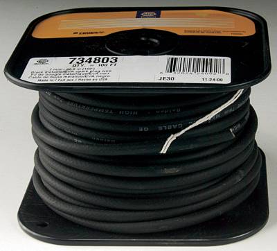

squonk 42,522 #3 Posted February 15, 2024 (edited) I use Belden 7MM Steel cored high temp wire Edited February 15, 2024 by squonk 1 Share this post Link to post Share on other sites

WHX?? 50,713 #7 Posted February 16, 2024 3 hours ago, squonk said: I use Belden 7MM Steel cored high temp wire Is that what you made me at the BS? The one that misfires? I've seen the cloth plug wire at show flea markets but they wanted 5 bucks a foot for it. Me thinks they were catering to the hit n miss crowd. 1 Share this post Link to post Share on other sites
ebinmaine 70,723 #8 Posted February 16, 2024 15 hours ago, squonk said: I use Belden 7MM Steel cored high temp wire Yep. Same here. I like the look of the cloth covered wire though. Share this post Link to post Share on other sites
squonk 42,522 #9 Posted February 16, 2024 I didn't see where the cloth covered wires were high temp rated. I imagine they are but would like to be sure. They would also cost me a buck a foot more plus shipping 1 Share this post Link to post Share on other sites
RED-Z06 2,479 #10 Posted February 16, 2024 2 hours ago, squonk said: I didn't see where the cloth covered wires were high temp rated. I imagine they are but would like to be sure. They would also cost me a buck a foot more plus shipping I dont think they are rated to exhaust manifold temps, id think they would burn through on direct contact with exhaust, that said, silicone jacketed wires are only rated to ~450⁰ contact protection. Ive never had a small engine wire burn though. Share this post Link to post Share on other sites

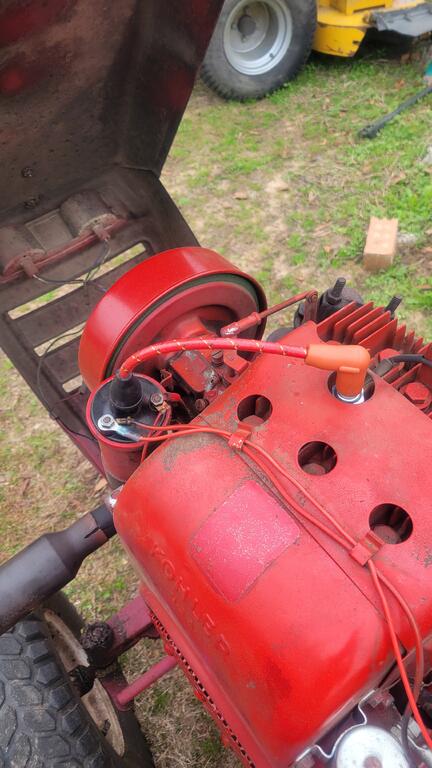

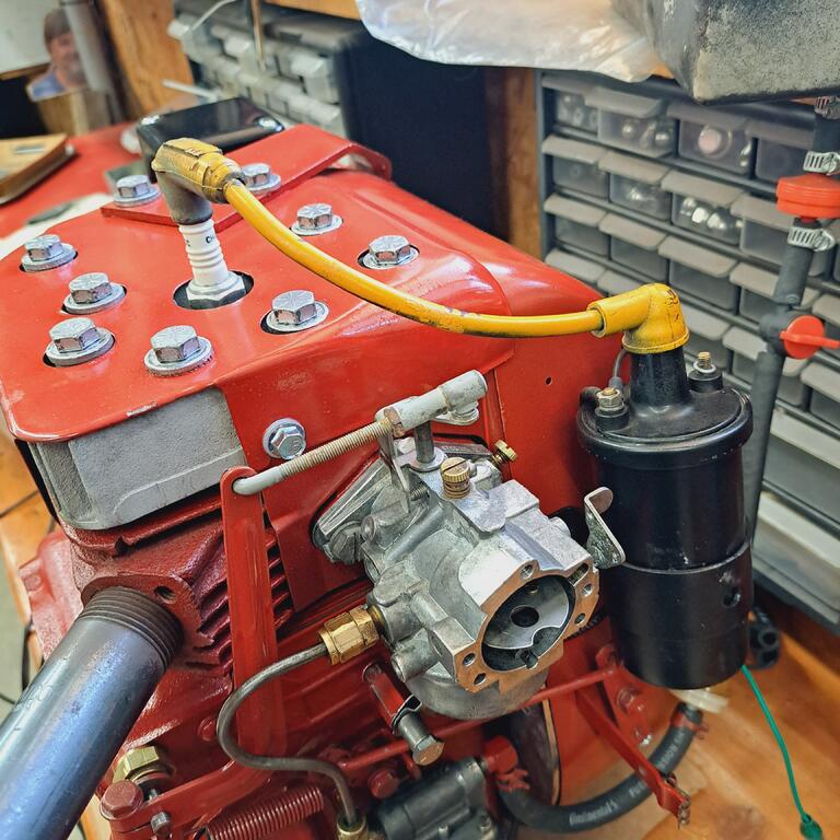

RED-Z06 2,479 #11 Posted February 16, 2024 Went fine on 3 so far, i really need to get a plug and crimper, the ratcheting crimper i have is good enough but not ideal. I put dielectric grease in the boots and so far all 3 are starting easier,the 416 will usually kick back once but it didn't. 3 Share this post Link to post Share on other sites

RED-Z06 2,479 #14 Posted February 16, 2024 I did a crude heat test, took one of the old wires and a section of new wire, ran the onan at 3600 for 5 minutes then held them against the header, after 2 minutes both were pretty badly damaged, i don't think either would have made it to 3 minutes without the core being compromised. I held both wires about ¾ inch off the pipe for 10 minutes using a wire, the silicone jacketed wire was compromised in that the outer layer was cracking off, the cotton wrapped wire had discoloration of the lacquer coating and just started to bubble but no nothing that would cause immediate problems. Long and short, don't let plug wires sit on the exhaust manifold and keep it an inch or so away. My car has 1-⅞ stainless longtube headers, high dollar hear resistant wires and fiberglass boot sleeves, one wire got twisted towards a pipe and it burned through the fiberglass sleeve and wire...🫠 1 Share this post Link to post Share on other sites
RED-Z06 2,479 #15 Posted February 20, 2024 My onan P216 on my 416H has never started as easily as it does now, it used to have to kick back then choke off to start...now its effortless hot or cold 1 Share this post Link to post Share on other sites
