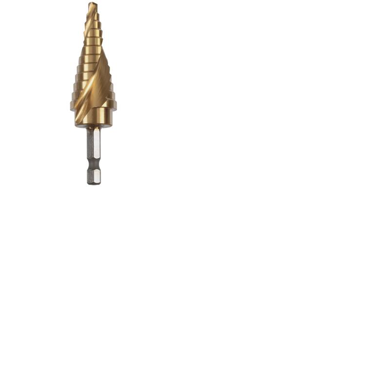

wallfish 17,343 #2 Posted February 8, 2024 (edited) The one I had trouble with was kinda like that. The rubber just wouldn't go into the tube right like it was swelled a bit or something. If that's what you have, I cured the problem by removing the plastic tube from the trans and using a step bit to ream some material off. Do just a little then test fit, little more each time. Rinse and repeat as necessary. Edited February 8, 2024 by wallfish 8 Share this post Link to post Share on other sites
