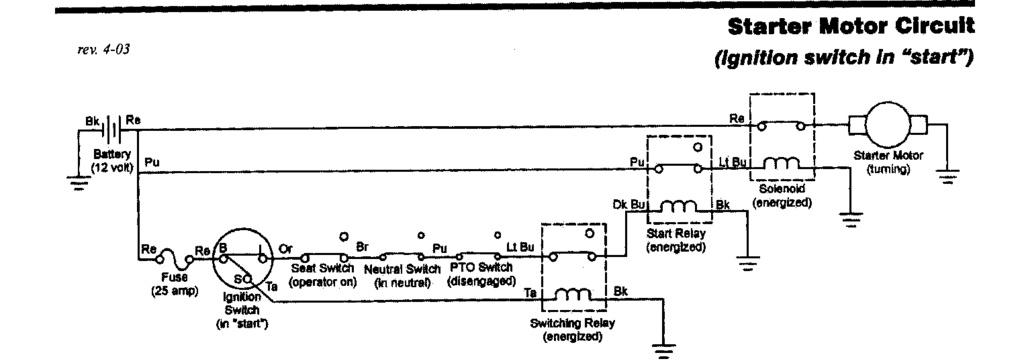

lynnmor 7,557 #2 Posted February 2, 2024 The Demystification Guide can be a big help, here it the simplified diagram of your starting circuit: As you can see the three safety switches need to pass current. I would start by checking for 12 volts at the light blue wire on the PTO switch while sitting on the seat and trying the ignition switch. Work up or downstream depending on the results of the test. 3 Share this post Link to post Share on other sites

Handy Don 13,340 #6 Posted February 2, 2024 13 hours ago, Thomas Moroney said: Does anyone have any idea what I should try next? You mean besides a smarter mechanic? 😬 @lynnmor, got you covered! Share this post Link to post Share on other sites
squonk 42,515 #7 Posted February 2, 2024 That wiring diagram doesn't show where the wires pass thru the 9 pin connection which I think is a load of crap Share this post Link to post Share on other sites
Handy Don 13,340 #8 Posted February 2, 2024 20 minutes ago, squonk said: That wiring diagram doesn't show where the wires pass thru the 9 pin connection which I think is a load of crap The demystification guide does not, but the wiring diagram in the OM does. I get that might be hard for some, but for most of us it is not difficult to mark up the demystification diagram with the additional info. Share this post Link to post Share on other sites

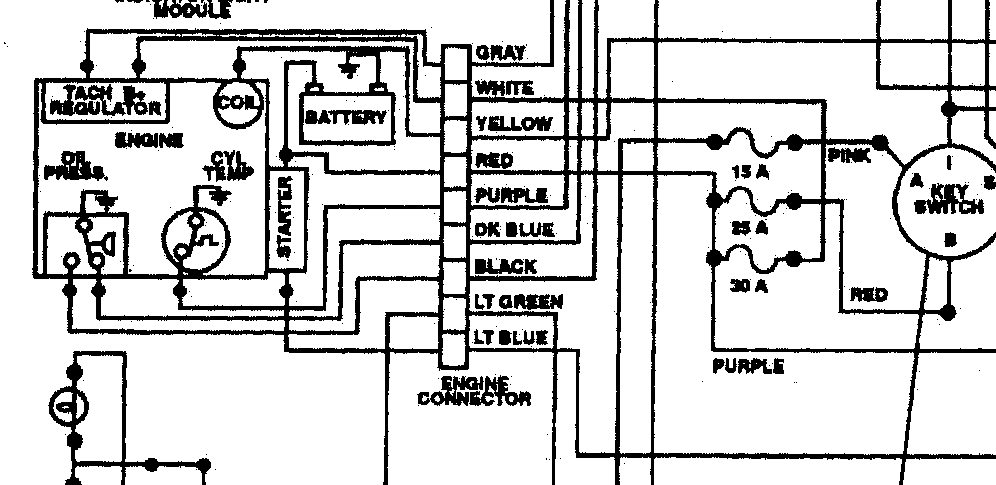

lynnmor 7,557 #11 Posted February 3, 2024 4 hours ago, squonk said: That wiring diagram doesn't show where the wires pass thru the 9 pin connection which I think is a load of crap Page 7-98 in the Demystification Guide has the complete diagram, here is a portion of it showing the 9 pin connection. Share this post Link to post Share on other sites
squonk 42,515 #12 Posted February 3, 2024 That's wonderful, but the connector should be referenced in the other diagram as well. Share this post Link to post Share on other sites
Handy Don 13,340 #13 Posted February 3, 2024 (edited) 19 hours ago, squonk said: That's wonderful, but the connector should be referenced in the other diagram as well. Gee whiz, this is something we all got for free! You could go through the guide and create modified versions that show the connector and assemble into a supplemental version of the guide! I’m sure @gwest_ca would be happy to upload it. Edited February 3, 2024 by Handy Don 1 Share this post Link to post Share on other sites
squonk 42,515 #14 Posted February 3, 2024 Someone who is unfamiliar and not proficient with working on electrical circuits would benefit greatly if all the info was in the diagram. I use wiring diagrams all the time and know about the 9 pin connector. I have spent a lot of time diagnosing a problem, quite often under a gun (walk in freezer thawing for example) where info and changes are left out of the diagram. The first diagram posted is a nice shortcut to the starting circuit. But it sure would be nice if that connector was shown so the person working on it knew it was there. Whoever wrote the guide did a great thing, but it could have been even better. The main thing with me is the 9 pin connector was the most likely problem (At least on all of the Onans I worked on with starting issues were) and it's not even on the diagram posted Share this post Link to post Share on other sites
