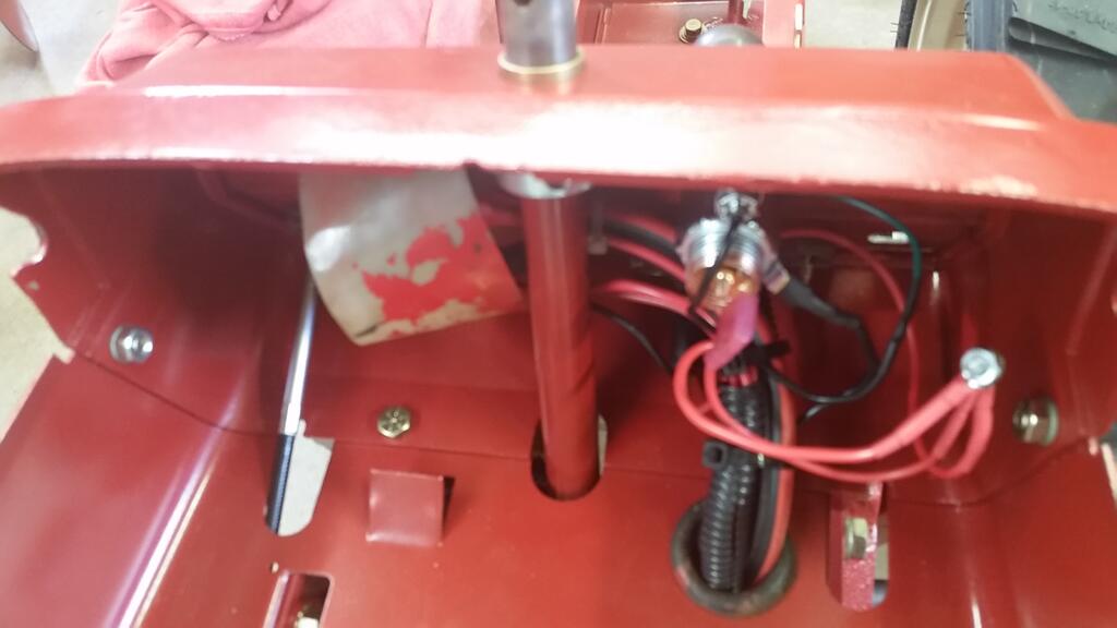

WHX?? 50,703 #8 Posted January 31, 2024 15 hours ago, Handy Don said: lighter gauge wires attached to the switch will last longer One of pains of the original setups is finagling heavy gauge wires to the switch & getting proper ends soldered on and connections tight. The heavy wire can put some stress on the switch terminals. But they did it at the factory sooo... I use trolling motor wire which has many fine strands and is quite flexible. It also allows use of 8 gauge wire which I have done a few times with no issues on an easy starting motor. Motors with no ACR get 6 gauge. Plan the wire routing carefully. Share this post Link to post Share on other sites

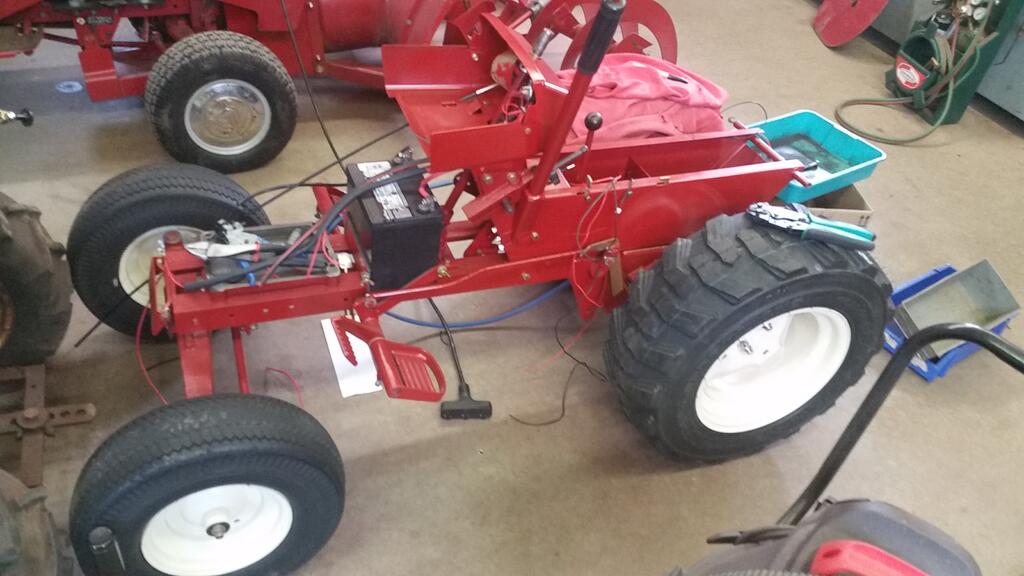

Mike'sHorseBarn 3,132 #9 Posted January 31, 2024 3 minutes ago, WHX?? said: One of pains of the original setups is finagling heavy gauge wires to the switch & getting proper ends soldered on and connections tight. The heavy wire can put some stress on the switch terminals. But they did it at the factory sooo... I use trolling motor wire which has many fine strands and is quite flexible. It also allows use of 8 gauge wire which I have done a few times with no issues on an easy starting motor. Motors with no ACR get 6 gauge. Plan the wire routing carefully. Yea and I need to get some of those wires too. This tractor has literally nothing electrical on it so I'll have to do some measuring and order some cables. Share this post Link to post Share on other sites
Handy Don 13,340 #10 Posted January 31, 2024 (edited) 2 hours ago, Mike'sHorseBarn said: Yea and I need to get some of those wires too. This tractor has literally nothing electrical on it so I'll have to do some measuring and order some cables. My recent experience with the fine-stranded 6ga cables was very good and I can recommend it for flexibility. Jungle site had 3’ of red and 3’ of black as a package and I got six solder-on, closed-end terminators with heat shrink with the right size bolt holes. I did NOT crimp the terminators before soldering, fearing that I might sever some of those fine wires. To make sure the wire would be firmly in place and to insulate the terminator from the vise jaws, I used a couple pieces of scrap plywood with one tall enough to clamp the wire vertically during the soldering operation. The 6ga stuff conducts really fast, so I needed my propane torch to get enough heat to fully fill the terminator with solder (and char the plywood--fire extinguisher close at hand just in case). If I do this again, I’ll use some flashing as a flame guard. Edited January 31, 2024 by Handy Don Share this post Link to post Share on other sites

WHX?? 50,703 #14 Posted January 31, 2024 24 minutes ago, Handy Don said: crimp the terminators before soldering Neither Achto or I ever crimp unless a quick repair and we have professional crimping tools. Pretty much all of my soldering done with one of those cheap but handy butane micro torches. Wow 3200 strands @Handy Don did I read that right? Must be the same stuff @Achto gets from work we use for battery cables... super flexible. 3 hours ago, Mike'sHorseBarn said: Yea and I need to get some of those wires too. This tractor has literally nothing electrical on it That's usually the way I like it. As I said most new to me's I completely rewire anyway. Only thing I am half @ssed at. Clean up connection points. Cut out Dan's favorite scotch locks and wire nuts... 2 Share this post Link to post Share on other sites
