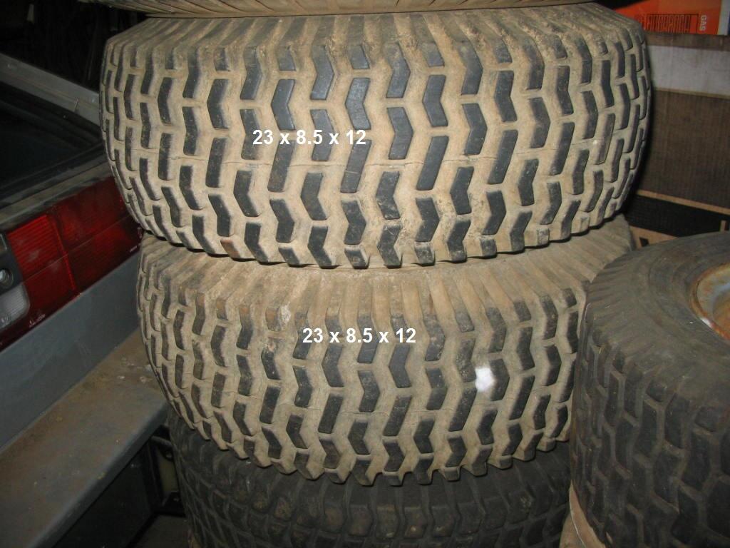

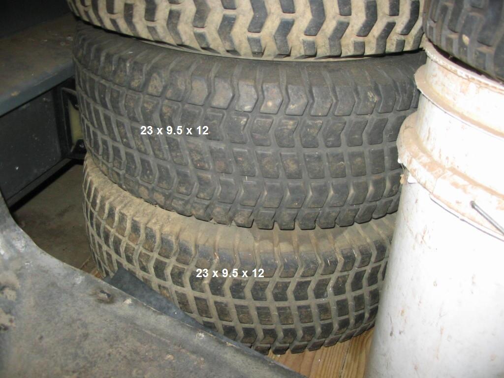

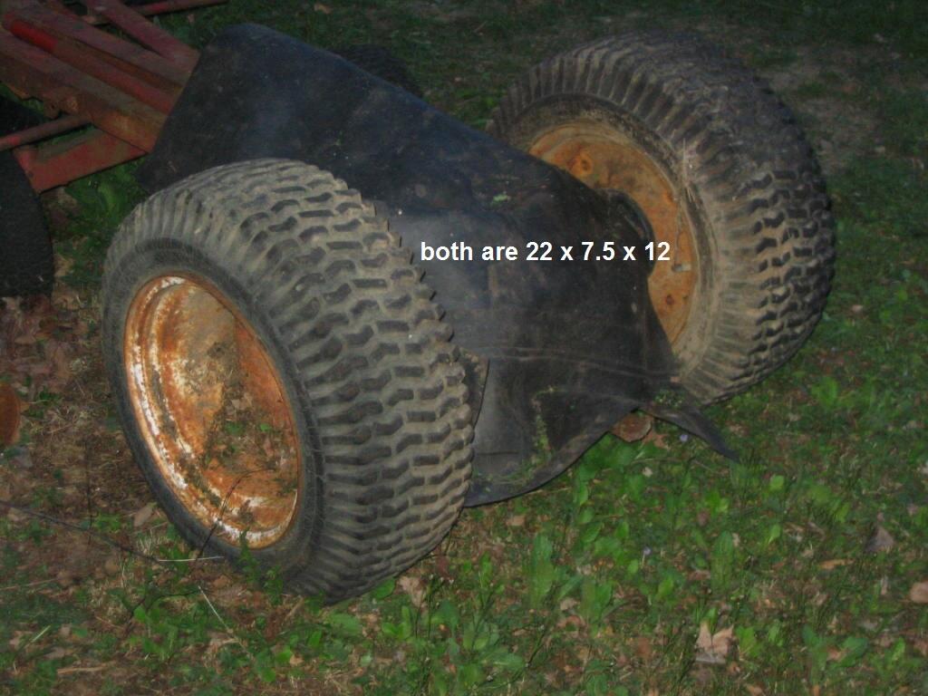

daveoman1966 3,788 #5 Posted January 30, 2024 I have matching pairs of 22x7.5x12 and 23x8.5x12...on rims. Little to zero dry rot---are inside garage. $60 per pair. Come and get them at my home....16729 price rd, Saegertown, pa 16433 (about 40m south of Lake Erie). Probably have a pair of 23x9.5x12 out there too...$70 pair 3 Share this post Link to post Share on other sites
