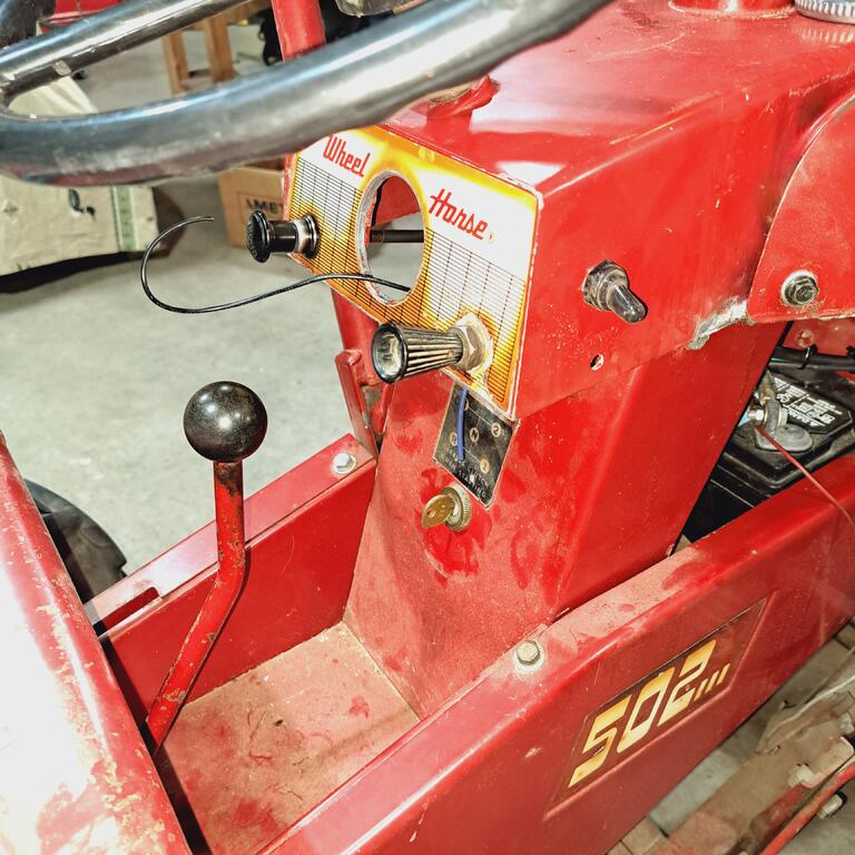

WHX?? 50,699 #42 Posted February 2, 2024 24 minutes ago, 953 nut said: Not a new world record yet but the words amp and volt haven't been used for over a dozen responses to this post. If we try real hard may be able to establish a new record for the most replies to a single post. Come-on, we can do it, I know we can! EB's fault he ALWAYS goes off topic ... yah that's it... EB's fault... OK so back on. I have two of these now and love them. Not exactly orginal but both on customs. Seem to be fairly accurate and holding up well. On a 602 ... a 502 with a H60 repo...the Tecky two diode charging system will run battery voltage up to 16 volts and this gauge monitors it nicely. Just flip on the bug eyes when it does and voltage drops down to 13 volts. Had to relocate the bug eye switch. 2 Share this post Link to post Share on other sites
