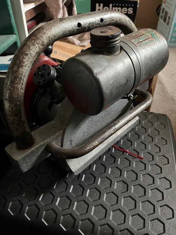

wallfish 17,193 #1 Posted January 25, 2024 This is a strange saw that must have a distinct purpose. I just don't know what that purpose is. It's an early 60s model called JB Power Chipper. Runs just like a circular saw but the blade has chainsaw like teeth. Think it's missing some kind of guide that's goes on the bottom. Dado joints? There's more images online and it's the same saw 4 Share this post Link to post Share on other sites

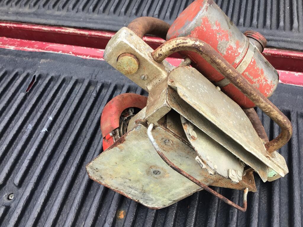

Lee1977 6,920 #2 Posted January 25, 2024 Looks like it runs on a guide, groove cutter may be used in log home construction to install a seal between logs. 6 1 Share this post Link to post Share on other sites

formariz 11,991 #5 Posted January 25, 2024 (edited) Lets see.The power chipper name has a lot to do with its function. Looking at handles and base, saw was designed to be used vertically. Large base only on one side of cutters with two flared ends means that it would be used from side to side while vertical. Absence of any reference marks as to where and what cutters is cutting means that it was not designed for any precise work as name also indicates. Tooth geometry is similar to a ripping chain and not a cross cutting one making it useless for dadoes and therefor only good for grooves.Large chip outlet indicates rough cutting throwing out large chunks. Depth of cut is set and not adjustable. I am curious as to the depth. The two holes in base indicate something missing, either a guide or some type of depth gage.Leaning to a depth gage since a guide would be then limited to one size. As a depth gage it could be driven further into saw's base. Should be something like a U shaped bar. Sometimes in some types of timber framing using metal plates rather than joints to keep parts together, one plows grooves much like a biscuit cutter does and use splines to align pieces while plates are bolted to them. Its a possibility but I think this tool has more to do with thick tree bark . Edited January 25, 2024 by formariz 1 2 Share this post Link to post Share on other sites
Handy Don 13,085 #6 Posted January 25, 2024 Is there a flexible fuel pickup inside the gas tank (a la the ones on RC aircraft) to be sure of steady fuel flow? If not, then I’m thinking it is only runnable in the orientation of the first picture. The big holes in the main frame appear to be for the bolts holding the side handle. The size and positions of those handles tell me that the operator has to exert pretty heavy force to keep the blade engaged in the work. With the inverted “U” guide it’s not intended as a freehand tool. Given also that it is gas powered it’s usable on sites where electric tools may not be available. And I agree on the ripping-style teeth, modest depth of cut, and no depth gauge, that it is not a cut-off tool. So i concur that it's likely for cutting not-especially-precise grooves in wood beam construction. Alignment plates? Splines for mating logs in wall construction? Wiring troughs? 1 Share this post Link to post Share on other sites
wallfish 17,193 #7 Posted January 25, 2024 There are 2 holes with thumb screws to adjust and lock some type of "wire" guide for depth of cut. I've never seen on so I can't make one. The bottom plate is definitely not meant to slide on anything as the counter sunk screw heads that mount the plate still protrude out a little and could catch. It was fired up years ago when I first got it and cross cut about a 3/4" groove into some 2X4s. 2 passes next to each other perfectly fit a lumber 2X4 tight but that may just be a lucky fit. That's why I was guessing dado joint cutter. It certainly isn't meant for finish work but seems more like log or framing or something like that. The weird thing is this is not a home made tool, it was manufactured so there had to be some kind of wide use intended in order to sell them. Share this post Link to post Share on other sites
formariz 11,991 #8 Posted January 25, 2024 (edited) 5 minutes ago, wallfish said: The bottom plate is definitely not meant to slide on anything as the counter sunk screw heads that mount the plate still protrude out a little and could catch. So then missing part is the depth gage. Base would only touch on the very end and then on depth gage. One would sort of rock it side to side. I am sure this is some type of specialty debarking tool on a standing tree. Edited January 25, 2024 by formariz Share this post Link to post Share on other sites
wallfish 17,193 #9 Posted January 25, 2024 9 minutes ago, Handy Don said: Is there a flexible fuel pickup inside the gas tank (a la the ones on RC aircraft) to be sure of steady fuel flow? If not, then I’m thinking it is only runnable in the orientation of the first picture. No. the fuel is fed from the bottom of the tank so it can only be used with the blade down The big holes in the main frame appear to be for the bolts holding the side handle. The size and positions of those handles tell me that the operator has to exert pretty heavy force to keep the blade engaged in the work. Those holes are for a side handle, pic below With the inverted “U” guide it’s not intended as a freehand tool. Given also that it is gas powered it’s usable on sites where electric tools may not be available. And I agree on the ripping-style teeth, modest depth of cut, and no depth gauge, that it is not a cut-off tool. So i concur that it's likely for cutting not-especially-precise grooves in wood beam construction. Alignment plates? Splines for mating logs in wall construction? Wiring troughs? Share this post Link to post Share on other sites
wallfish 17,193 #10 Posted January 25, 2024 6 minutes ago, formariz said: So then missing part is the depth gage. Base would only touch on the very end and then on depth gage. One would sort of rock it side to side. I am sure this is some type of specialty debarking tool on a standing tree. Don brings up a good point about the fuel pick up. Normally a 2 stroke would have that flexible pick up inside the tank to run in any position. Most of these O&R tanks are set up like that but this one has a special/different tank with petcock on the bottom. 1 Share this post Link to post Share on other sites
formariz 11,991 #11 Posted January 25, 2024 Ca that tank can be rotated within clamps ? Share this post Link to post Share on other sites
wallfish 17,193 #12 Posted January 25, 2024 (edited) OK Found a pic of one with the wire guide. It's more like a blade protector but it is adjustable. It doesn't appear like the blade can be sunk into the work. Like it's only meant to use on the edge of the wood but ???? Edited January 25, 2024 by wallfish 1 Share this post Link to post Share on other sites
wallfish 17,193 #13 Posted January 25, 2024 2 minutes ago, formariz said: Ca that tank can be rotated within clamps ? It can. The strap only has one screw so fairly easy to rotate it. Share this post Link to post Share on other sites
formariz 11,991 #14 Posted January 25, 2024 (edited) Very possibly a depth gage. Too close to blade to be a guide. I believe I may be correct. Time will tell. Edited January 25, 2024 by formariz Share this post Link to post Share on other sites
wallfish 17,193 #15 Posted January 25, 2024 (edited) 26 minutes ago, formariz said: So then missing part is the depth gage. Base would only touch on the very end and then on depth gage. One would sort of rock it side to side. I am sure this is some type of specialty debarking tool on a standing tree. You're good Caz! And think you got it as this is what was found before when we were trying to figure it out I've found a reference to a J. B. Bennett Power Chipper, it's described as a mechanical gum harvester, developed by farmer Julian Bennett, the date of 1962 fits with the age of the engine. Link below from the web archive, as the original is offline ATM; http://web.archive.org/web/20210419002330/https://sclfind.libs.uga.edu/atfa/timeline/index.html And a patent for a power tree chipper, a portable unit powered with "one-half horse-power two cycle" engine, for chipping bark from trees to allow harvesting of sap or gum. Date the patent was applied for was also 1962, but the machine shown in the diagrams differs, also has a built in sprayer using the exhaust conduit and a fuel cut-off valve in the handle. https://worldwide.espacenet.com/publicationDetails/originalDocument?CC=US&NR=3121974A&KC=A&FT=D&ND=4&date=19640225&DB=&locale=en_EP# https://myoldmachine.com/topic/6819-can-someone-tell-me-what-i-have/?tab=comments#comment-62813 Edited January 25, 2024 by wallfish 1 Share this post Link to post Share on other sites
formariz 11,991 #16 Posted January 25, 2024 Just finished reading the patent on your link. That is it definitely. The only major difference yours has is the lack of the spray feature. Yours is also probably of a later date due to the improved chain cutter which will make smaller chips than the cutters on patent. The spraying of the freshly debarked wood with an acidic liquid is interesting and new to me. Possibly just for gum trees ? I am somewhat familiar with turpentine or and pine pitch collecting and never heard of that technique with it. Great stuff. That is a rather important tool to own a know from another dying trade or skill. What other little gems do you have in your collection? Share this post Link to post Share on other sites
Handy Don 13,085 #17 Posted January 25, 2024 27 minutes ago, wallfish said: And a patent for a power tree chipper, a portable unit powered with "one-half horse-power two cycle" engine, for chipping bark from trees to allow harvesting of sap or gum. Well, well, nicely done @formariz! So cut grooves in bark for sap to run out. Still puzzled by the fuel feed. Share this post Link to post Share on other sites
formariz 11,991 #18 Posted January 25, 2024 1 minute ago, Handy Don said: Well, well, nicely done @formariz! So cut grooves in bark for sap to run out. Still puzzled by the fuel feed. Thank you Don. Not to cut grooves but just to remove bark and expose cambium layer. Once that is done tree will start “bleeding”. Once bleeding stops one usually keeps going upwards on trunk exposing a fresh area with new full”veins”. A “funnel” was made by inserting two strips of tin creating a V that would drain into container below. There was a special large ax with a curved blade which would follow the tree curvature that one would strike on bak creating a kerf in which to insert tin. Pretty much like when installing flashing. Share this post Link to post Share on other sites
