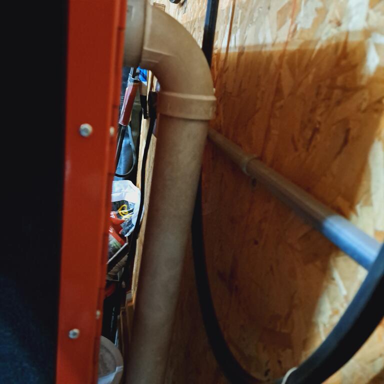

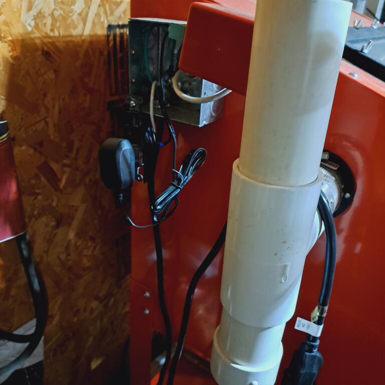

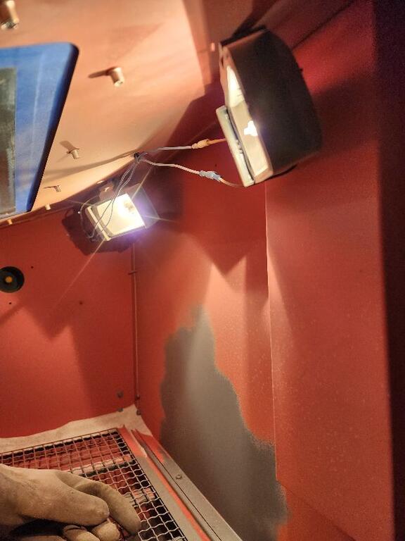

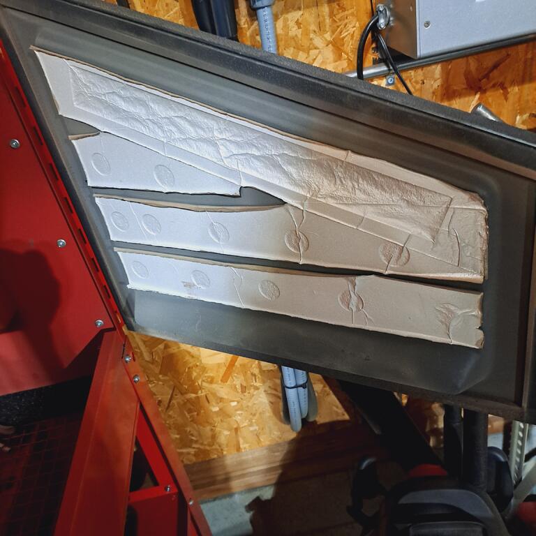

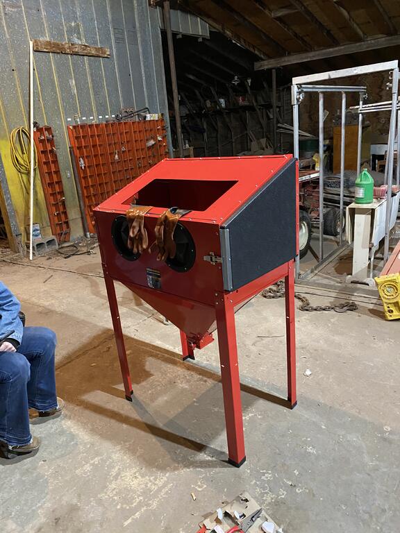

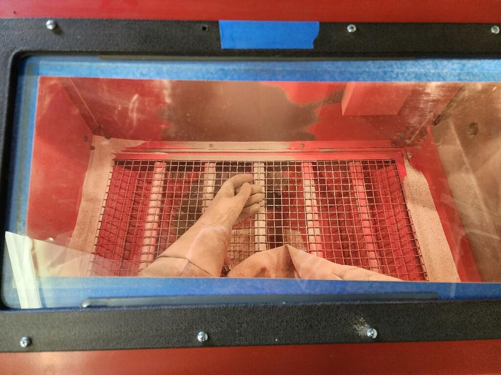

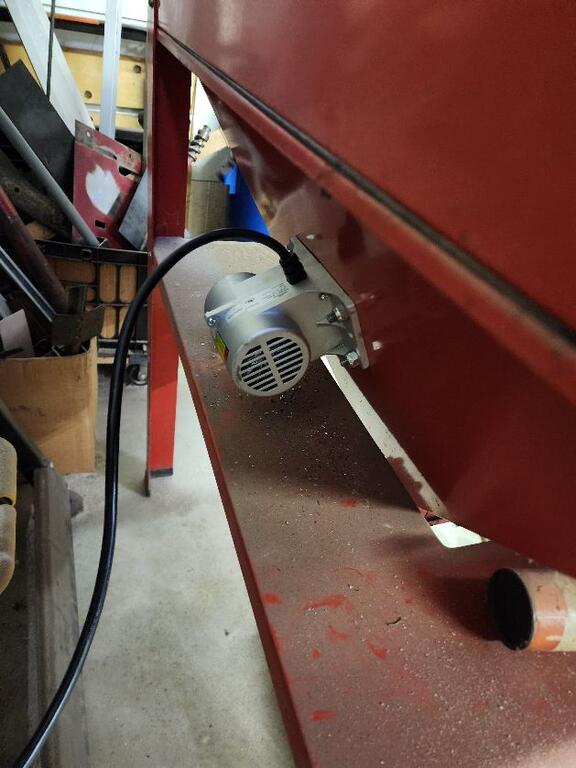

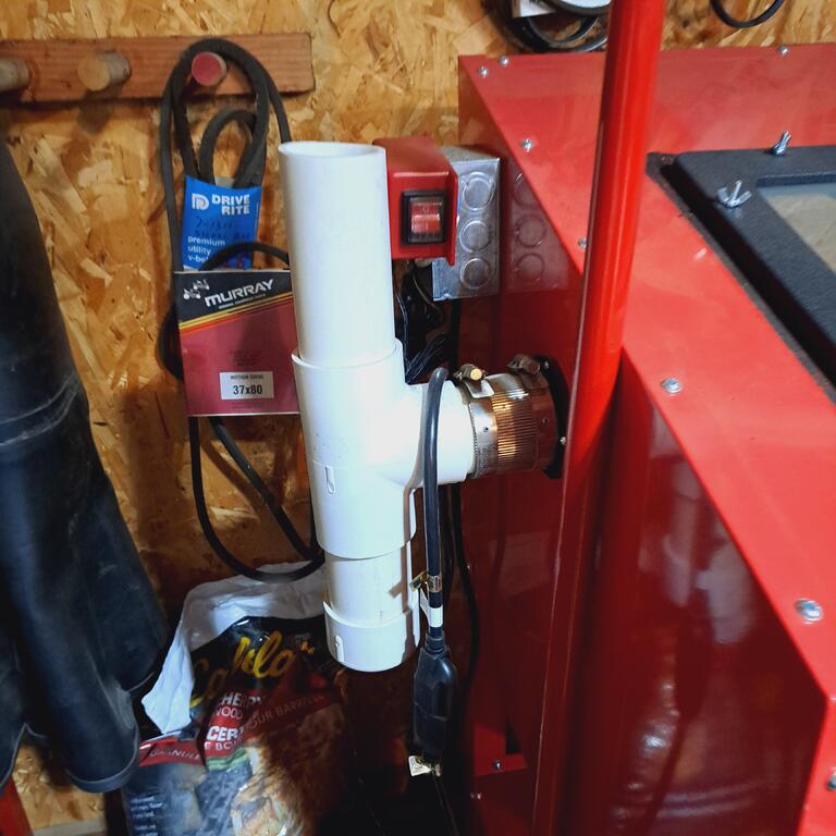

Marv 965 #1 Posted January 25, 2024 Being able to see what I was doing has been a problem. I decided to fix that. I installed new lighting, and a dust extractor. I have always had an issue with the sand flowing down off the "funnel" walls too. Fixed that with a vibrator motor. Sure makes use a lot more pleasant. I also worked on the viewing glass. Removed all the original screws holding the trim. Installed Rivnuts and different screws. Now I easily remove the glass for cleaning and installing new plastic shields. 5 5 Share this post Link to post Share on other sites
oliver2-44 10,351 #2 Posted January 25, 2024 (edited) 23 hours ago, Marv said: I have always had an issue with the sand flowing down off the "funnel" walls too. Fixed that with a vibrator motor. I need to do that to my cabinet. Can you provide any purchase information. Edited January 26, 2024 by oliver2-44 3 Share this post Link to post Share on other sites

Achto 28,756 #4 Posted January 25, 2024 9 hours ago, Marv said: Now I easily remove the glass for cleaning and installing new plastic shields. Nice mods !!! I have switched to using regular glass on the inside instead of the plexiglass. It lasts longer & the local hardware store stocks it in the correct size for much less $ than plexiglass. 4 1 Share this post Link to post Share on other sites

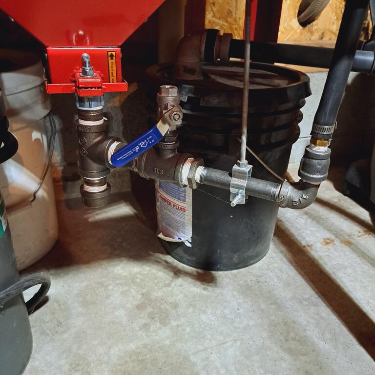

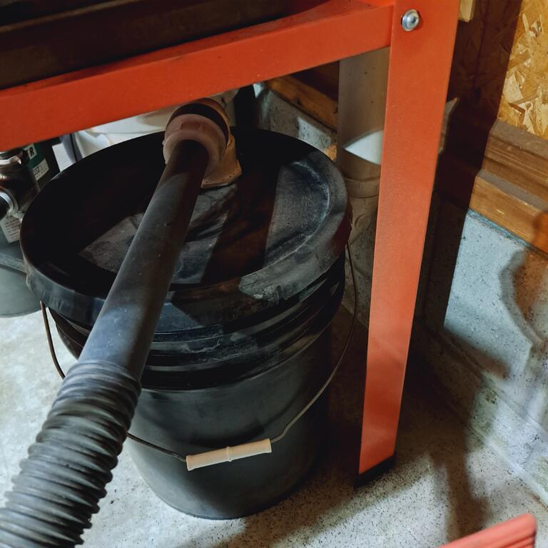

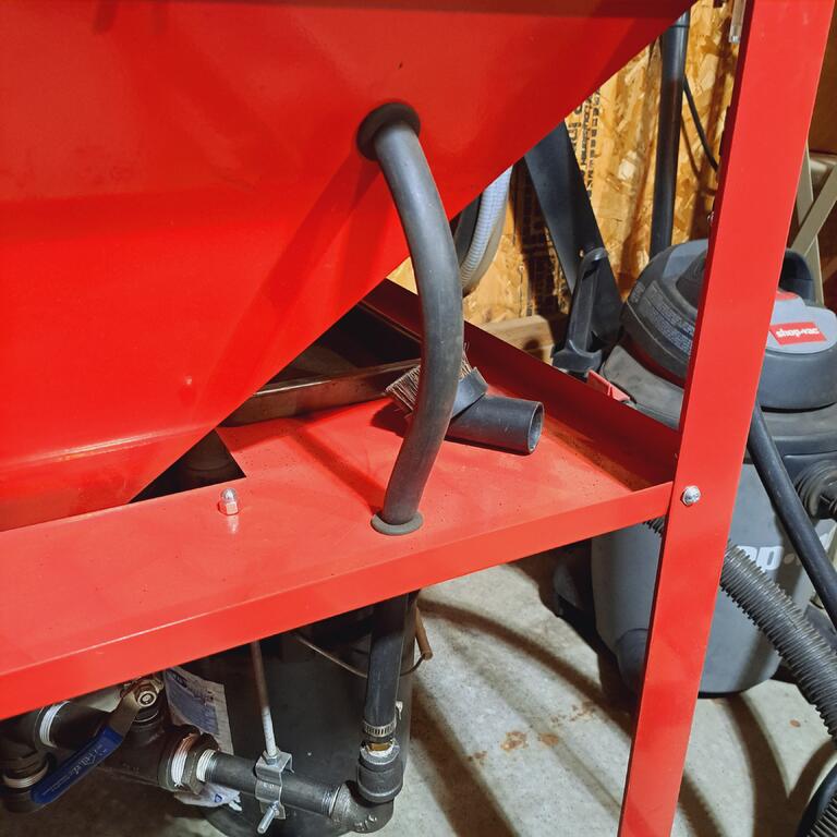

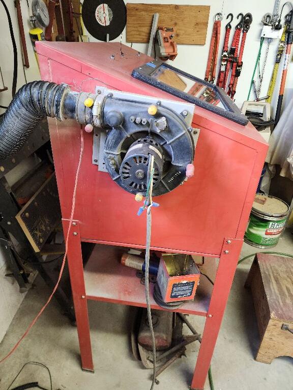

WHX?? 50,686 #5 Posted January 25, 2024 (edited) Interesting... a furnace combustion air blower on the exhaust. I did many mods to mine based on u tube stuff including the glass Achto mentioned. Went the other way on the exhaust. Used the exhaust port for the intake. Exhaust out the back into a cyclone bucket and shop vac. Best mod is reworking the hopper bottom to draw media off the bottom. See if I can find some pics. Edited January 25, 2024 by WHX?? 3 Share this post Link to post Share on other sites

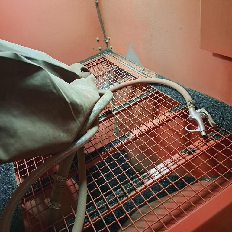

ri702bill 8,951 #7 Posted January 28, 2024 There are a bunch of YT videos on common sense modifications for these cabinets. Best one I did was to ditch the supplied blast gun and upgrade to a domestic one.... Share this post Link to post Share on other sites
WHX?? 50,686 #8 Posted January 29, 2024 My supplied gun plugs up all the time. Blasted a regulator cover that the paint came off in 1/4 inch pieces and nothing but grief in plugging it. Going to go to a dead man's set up eventually. The light... rather hokey but ther is a frosted light cover on it that pops right off and much better. Still warrants an upgrade tho. My mod to the bottom end instead of the pickup tube. Me thinks the YTbers got this from $$ industrial units. Works well.. the valve let's a small amount of air to help media to get up the tube. The hopper fitting is a one inch ridgid conduit fitting. I also added a inside blow gun to blow off parts but more so to blow off the door when done. Helps spillage. Bang on the door before opening helps. Tape those stupid door holes off. They just collect media. Wiring just temporary till I get in my lighting groove... 1 1 1 Share this post Link to post Share on other sites
BBQVultureWings 160 #9 Posted October 28, 2024 On 1/25/2024 at 5:29 AM, Achto said: Nice mods !!! I have switched to using regular glass on the inside instead of the plexiglass. It lasts longer & the local hardware store stocks it in the correct size for much less $ than plexiglass. I watch the free stuff section of craigslist for old windows. go get them tear them apart & cut the glass to size. We have Not bought glass for the sandblaster in Years. 2 Share this post Link to post Share on other sites
