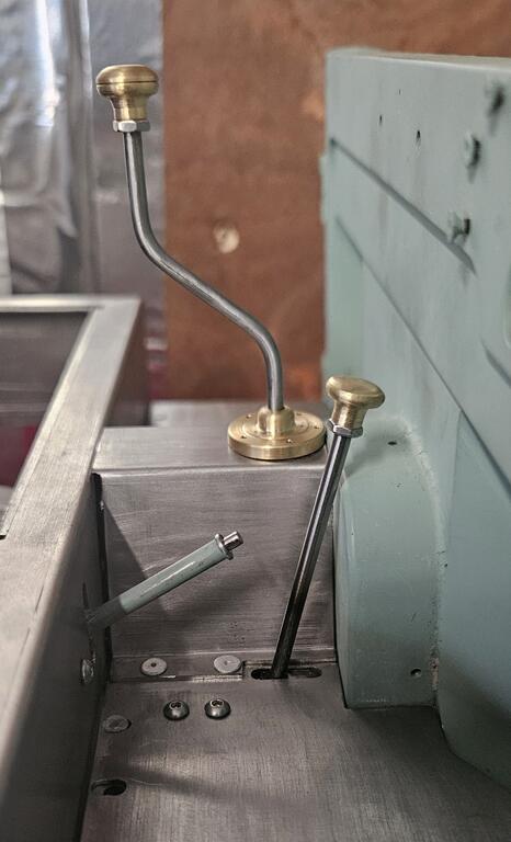

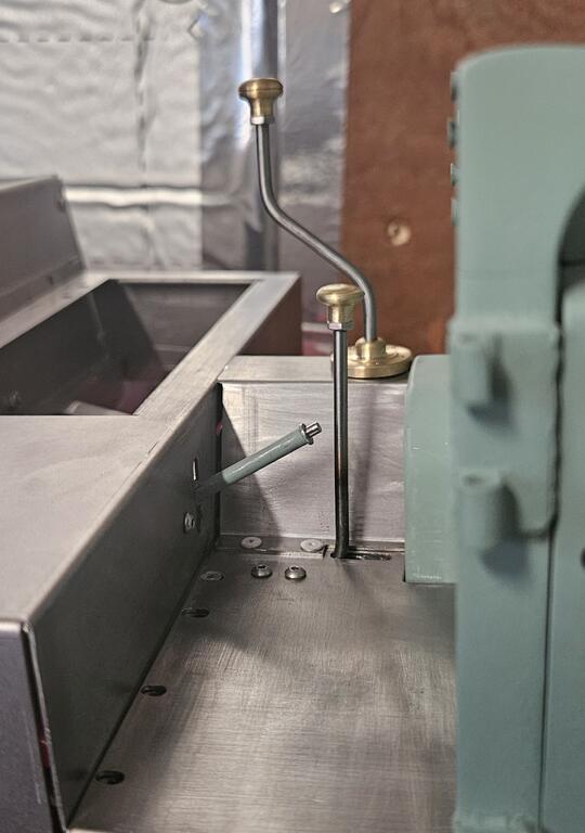

Mickwhitt 5,259 #127 Posted February 18, 2025 Ha ha, I'm not looking to have a little guy sitting in there. Some builders are using animatronic figures in their vehicle, operated by radio control. They look a bit clunky to my mind but whatever floats your boat. I carried on the control work today, making a gear lever and range selector lever. The gear lever is fixed but the range lever moves and will hopefully operate a microswitch to power up the electrical system via a solenoid switch. 1 1 Share this post Link to post Share on other sites

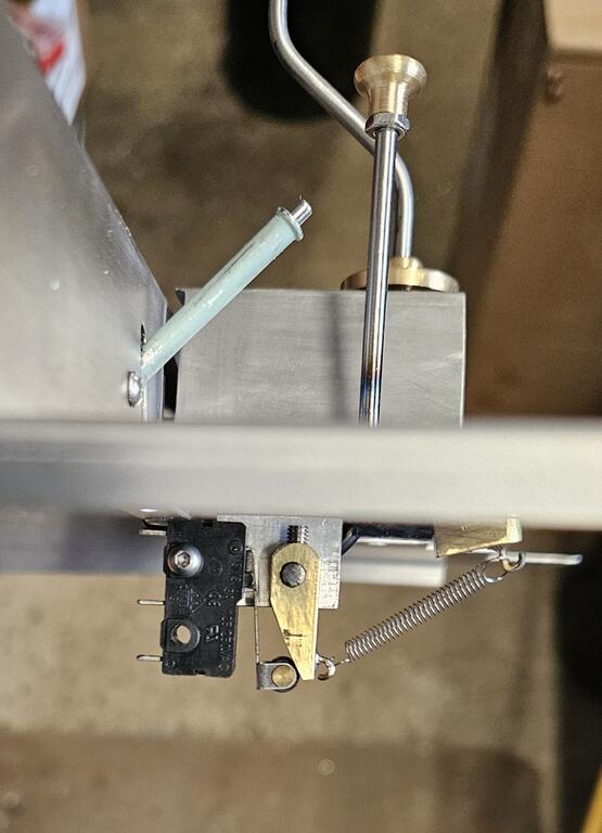

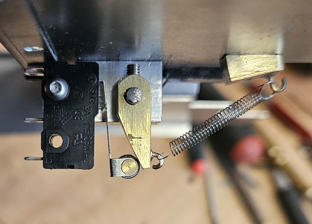

Mickwhitt 5,259 #132 Posted February 19, 2025 Microswitch built into the range selector lever. Not a big job but bit of juggling to get it to fit and work. Hopefully now I can ditch the huge power switch that came with the kit and use a relay. 2 Share this post Link to post Share on other sites

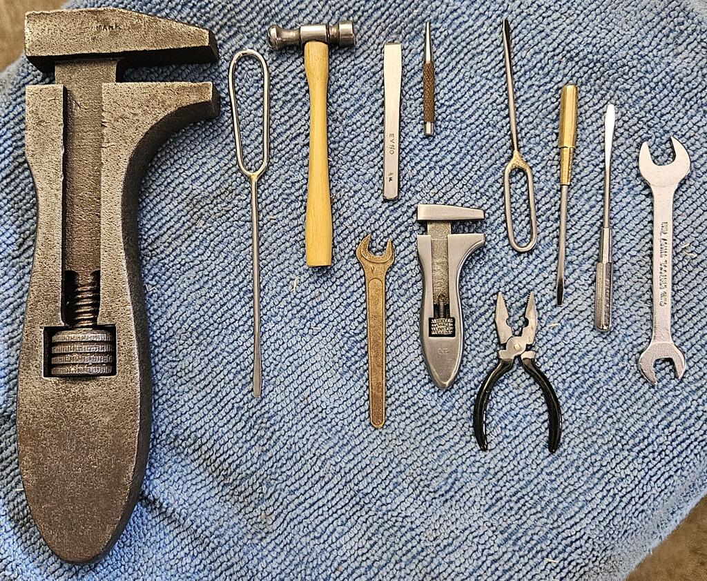

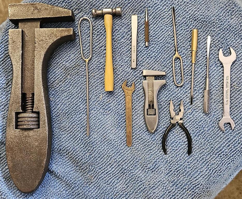

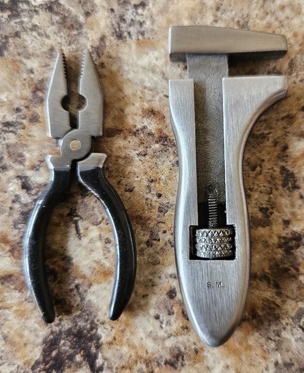

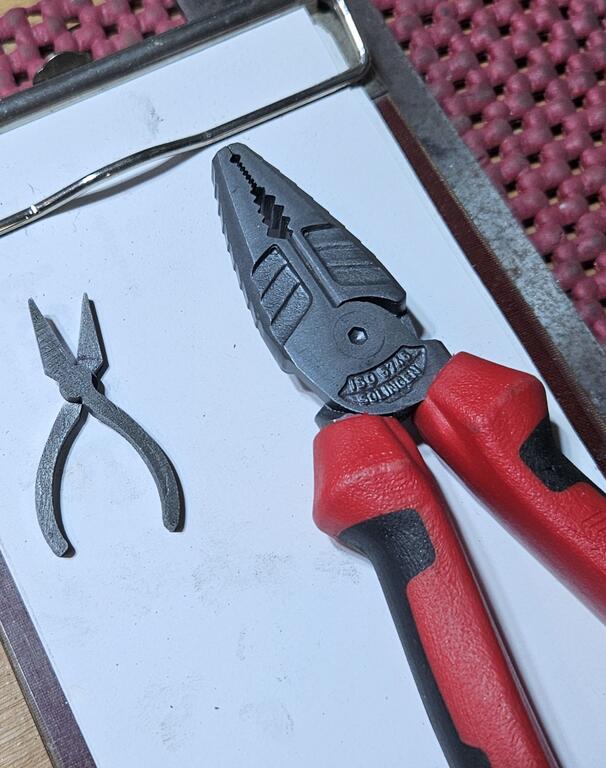

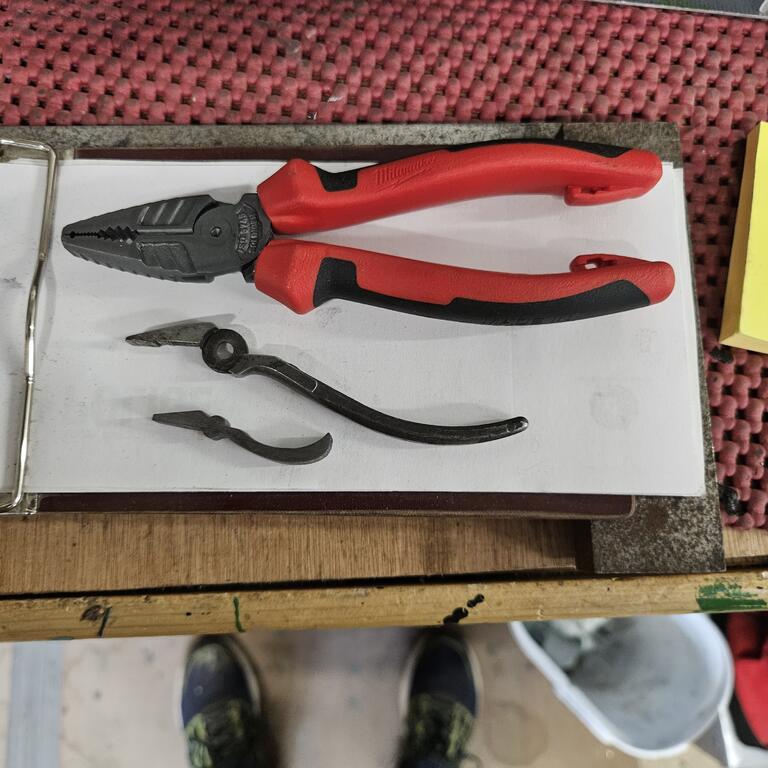

Mickwhitt 5,259 #137 Posted April 9, 2025 I've been spraying the body with primer and I'm.getting fed up of painting. So I went back to the tool chest idea and I'm having a go at a pair of pliers. I started with a 7mm thick slab of cast iron on which I drew the outline of a plier jaw and handle. Lots of filing and faffing to get the shape to my liking. The normal Milwaukee pliers are for scale. The middle one is a small pair I butchered to get the right shape of each jaw. The bottom one is my tiny attempt. Having got the profile about right I then cut the slab very carefully in half to give me two identical pieces. Tomorrow ill have a crack at milling the pivot point to get both jaws together. 3 1 Share this post Link to post Share on other sites
Mickwhitt 5,259 #138 Posted April 28, 2025 I've been working on the tools again. The pliers were too thin at the web and fractured. So I had to start again. Bit of a pain but we learn by our mistakes. The adjustable wrench was a bit more involved, with shaping and milling to create the tee slot for the sliding jaw. The full size spanner on the left is an original Landrover one as supplied with the series 1 model. My version is just about the same, I'm quite happy with the way it looks. 2 2 1 Share this post Link to post Share on other sites
