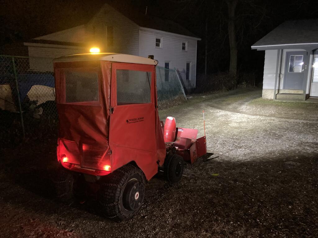

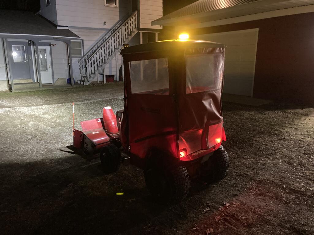

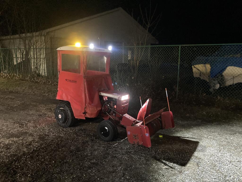

Blasterdad 2,962 #6 Posted January 20, 2024 I just did my driveway 2 days ago & it was about 0 degrees out, my stock headlight has led's in it but it might as well be a candle, doesn't light up anything. I solved that problem with led's on top of the cab, SUPER bright. My cab has all plastic windows though & no heat gets in it since it's a K341,C161 & the snow doesn't stick to it. Only a little frost on the inside of the windshield from my breath but hardly noticeable. I absolutely LOVE my cab! I paid my dues for many years without one, covered head to toe with snow & ice with my eyes almost frozen shut. 6 8 Share this post Link to post Share on other sites

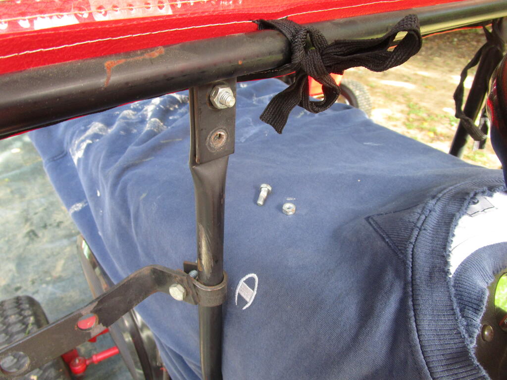

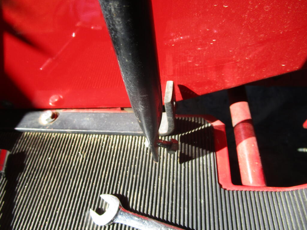

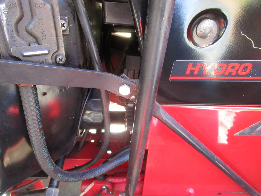

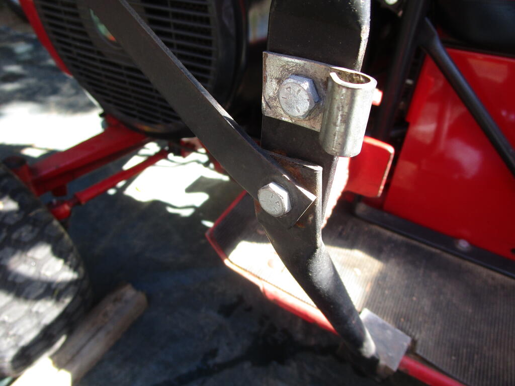

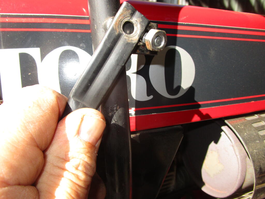

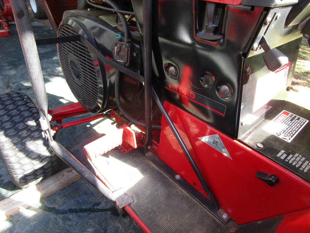

Jody14 12 #11 Posted January 30, 2024 Ok I'm new to this forum, so I'm not sure if I am doing this right, and I'm hoping for some major needed help. I recently purchased an original cab snowcab for my 417A. The cab was taken off a 522xi. The brackets I know are totally different. I was wondering if anyone would have, or know anyone that would have the brackets I need to mount it on my 417A ? I believe the cab is model number 79978. Thanks in advance. 3 Share this post Link to post Share on other sites
WHX?? 50,414 #12 Posted January 30, 2024 Jody. Your best bet is going to make or rehab the the existing brackets. Down load the manuals for the correct cab and the Xi cab and compare parts. A call to Orginal Cab might get you nowhere but sure won't hurt. 2 Share this post Link to post Share on other sites

Blasterdad 2,962 #14 Posted January 30, 2024 (edited) 46 minutes ago, Jody14 said: Ok I'm new to this forum, so I'm not sure if I am doing this right, and I'm hoping for some major needed help. I recently purchased an original cab snowcab for my 417A. The cab was taken off a 522xi. The brackets I know are totally different. I was wondering if anyone would have, or know anyone that would have the brackets I need to mount it on my 417A ? I believe the cab is model number 79978. Thanks in advance. to I made my cab out of 3 different ones... The brackets can be modified if you're handy, you can also place an ad in the for sale / wanted / trade section too. @WHX?? had good Ideas too, I did lots of looking through the manuals comparing parts... Edited January 30, 2024 by Blasterdad 3 Share this post Link to post Share on other sites

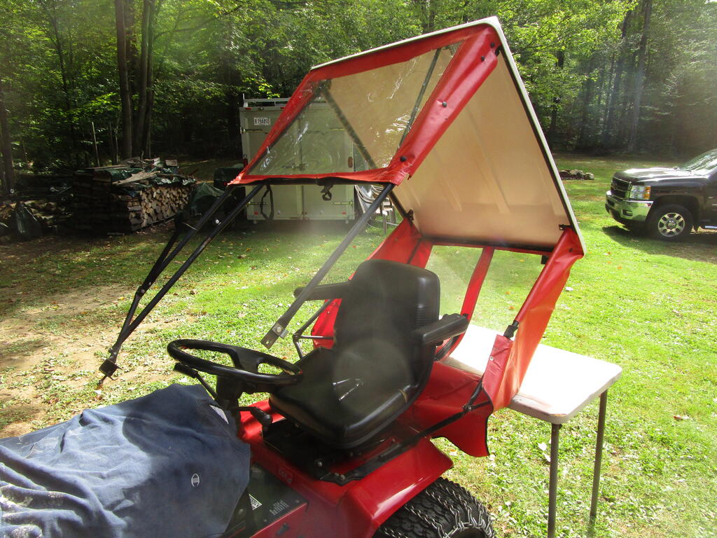

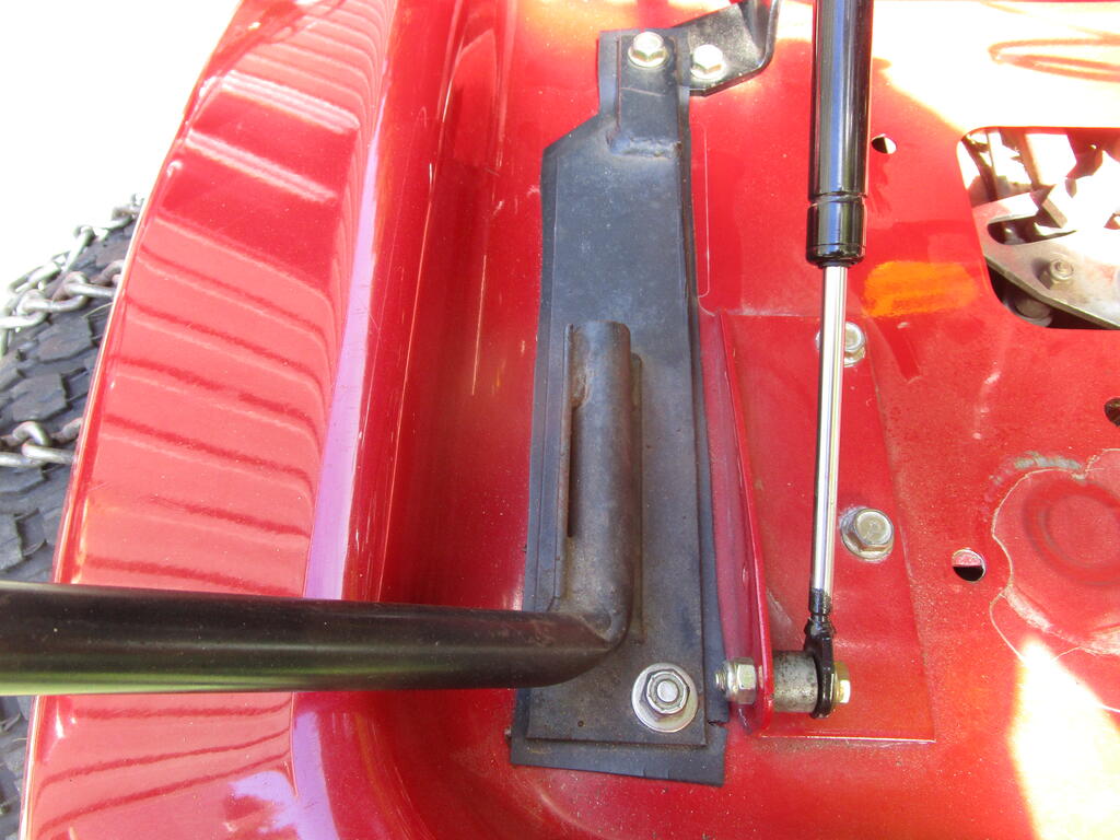

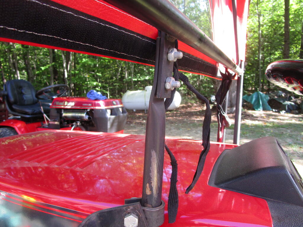

JCM 9,989 #15 Posted January 30, 2024 These pics may help. If I find more I will post them for you @Jody14 1 3 1 Share this post Link to post Share on other sites
Ed Kennell 40,173 #16 Posted January 30, 2024 4 hours ago, Jody14 said: Ok I'm new to this forum, so I'm not sure if I am doing this right, and I'm hoping for some major needed help. I recently purchased an original cab snowcab for my 417A. The cab was taken off a 522xi. The brackets I know are totally different. I was wondering if anyone would have, or know anyone that would have the brackets I need to mount it on my 417A ? I believe the cab is model number 79978. Thanks in advance. You are doing it right Jody. And to the If you need more pictures, I could get some tomorrow of the cab on my 520H. The mounting should be the same on a 417A. 1 Share this post Link to post Share on other sites

WHX?? 50,414 #19 Posted January 30, 2024 9 hours ago, Ed Kennell said: The mounting should be the same on a 417A. One would be surprised how adaptable they are. Many of the brackets can be fashioned from 1/2" conduit. I picked up a cab cheap that was for a later 70's C series. PO had it modded on a later 60's square hood. After minor reworking I fit it on a 520 easy enough. Never messed with an XI cab tho. 3 Share this post Link to post Share on other sites

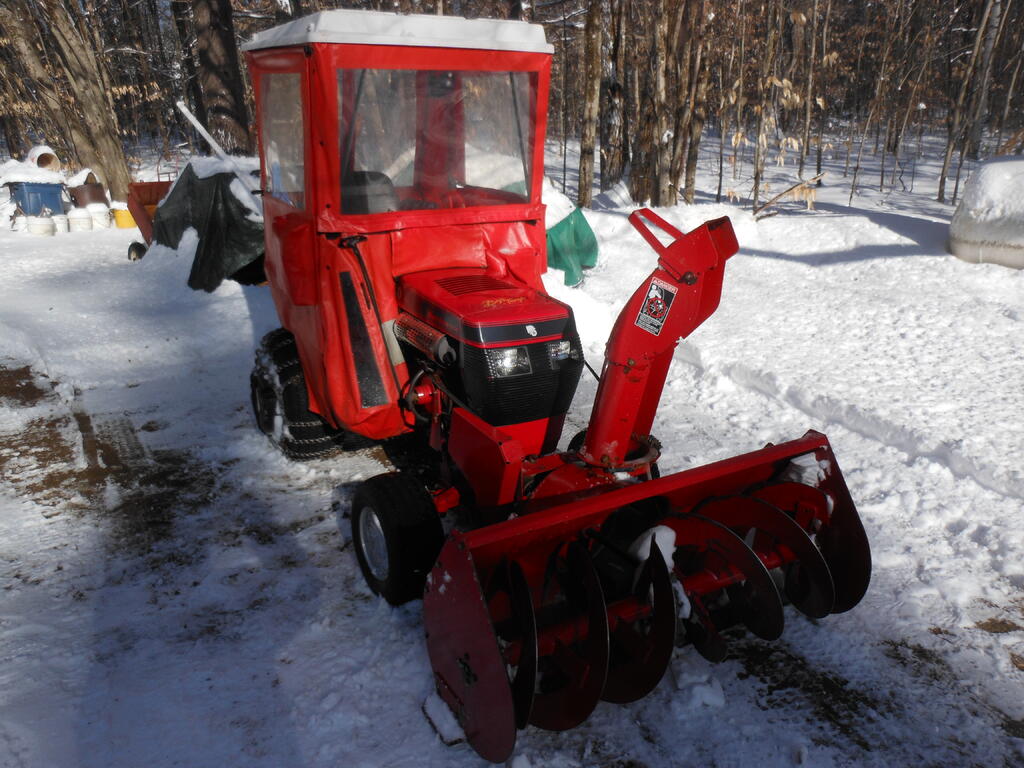

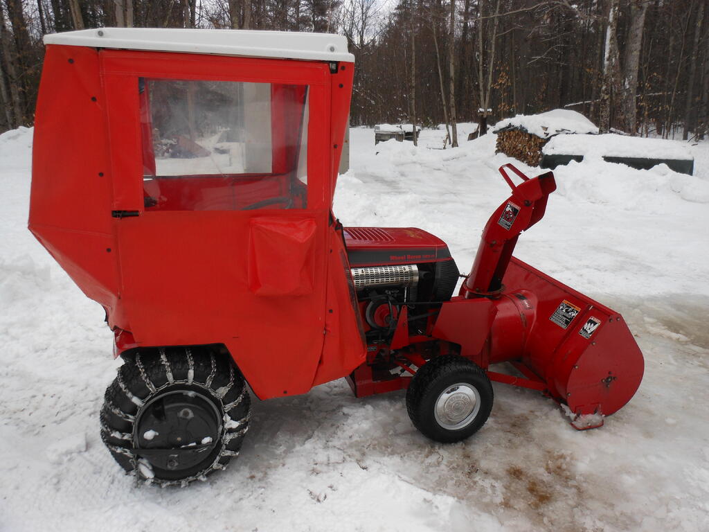

Ed Kennell 40,173 #21 Posted January 30, 2024 17 hours ago, SylvanLakeWH said: I'm old and old school so I don't have one - I freeze.. I'm just OLD and a slow learner. It took me 60 years to realize I felt much better sitting in a warm dry cab while blowing snow. All it took was a vented belt guard and a housing to collect the heat from the rear cylinder and my cab temp is always 30 degrees above the outside temp. The heat comes in at my right foot and I keep the flap open at the left rear where it exits. The windows stay clear and I stay warm. Before cab In my heated cab 3 1 4 Share this post Link to post Share on other sites

Jody14 12 #23 Posted February 4, 2024 JCM. Thanks for the pictures. They are very helpful. Do you happen to know what model number cab you have off hand? I spoke with original cab and I was sent 2 different diagrams and neither have the same number on them as my cab does. I'm puzzled. 1 Share this post Link to post Share on other sites
JCM 9,989 #24 Posted February 4, 2024 @Jody14 Mine is high and dry hanging up in the garage. If I can get up there I will get the #'s off of it for you.I will take a look. 2 Share this post Link to post Share on other sites
Jody14 12 #25 Posted February 4, 2024 Thank you. By the sounds of things I may have to give up on my glass windshield and windshield wiper on the cab I bought and find one with the plastic windshield. 1 Share this post Link to post Share on other sites
