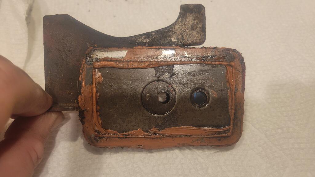

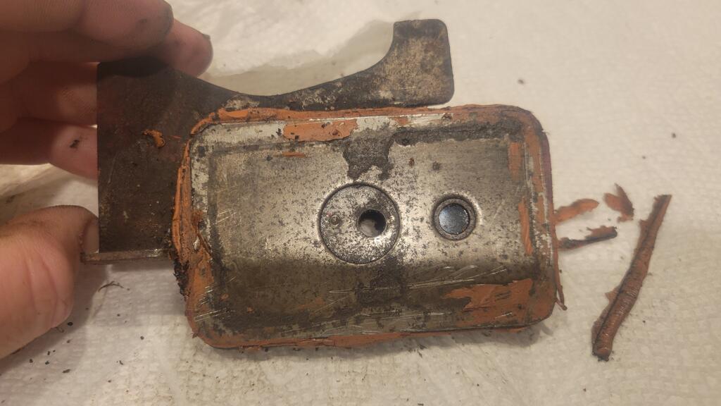

RED-Z06 2,479 #1 Posted January 18, 2024 Decided to address my oil consumption and leaks, it ran super strong and i was killing a plug in about 90 minutes but it had governor shaft leaks and wetness around the crank seals. I pulled the breather off tonight and the previous owner...the oil drain back was covered in rtv, the reed plate was upside down..which pushed the reed shut against the outer plate. Poor gal couldn't breathe at all. It will be a couple weeks before it back together but...id venture this is the majority of my problem. I made a video showing how it pushes the reed tightly shut..meaning the case gasses have no outlet. 4 1 2 Share this post Link to post Share on other sites
wallfish 17,485 #2 Posted January 18, 2024 11 minutes ago, RED-Z06 said: governor shaft leaks A sure sign of excess case pressure in a Kohler K or M series or over filled with oil 3 Share this post Link to post Share on other sites
RED-Z06 2,479 #3 Posted January 18, 2024 6 minutes ago, wallfish said: A sure sign of excess case pressure in a Kohler K or M series or over filled with oil Im hopeful, based on the fact it didnt blow the seals out, that its otherwise healthy. Im going to get new gaskets and the rubber seal for the shaft 3 Share this post Link to post Share on other sites
pfrederi 18,324 #4 Posted January 18, 2024 I hate it when people resort to RTV.. Once in awhile a small amount is ok but usually it is smeared on. More than one hydro I worked on had issues because some idiot used RTV 1 Share this post Link to post Share on other sites
RED-Z06 2,479 #5 Posted January 18, 2024 9 minutes ago, pfrederi said: I hate it when people resort to RTV.. Once in awhile a small amount is ok but usually it is smeared on. More than one hydro I worked on had issues because some idiot used RTV With the pitting along the lower edge, ill most likely put a very sparing amount on the one side of the plate, i use Dirko HT, its thin so i can easily manage it with a toothpick. But its definitely getting proper gaskets and the rubber spacer, it all works together to make the reed work Share this post Link to post Share on other sites
