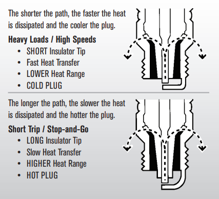

JoeM 7,923 #6 Posted January 5, 2024 19 hours ago, squonk said: I run Autolites #255 in small blocks and #216 in big blocks I like the autolites too! Good quality that h10 is just a touch hotter then the j8 if it ran good on the h10 pull lever B. And if you want a hotter plug a nice replacement for the 216is the autolite 437 If you are getting fouling from a combination of a tired engine and wonderful high quality gas. A hotter plug will help I know we do little stop and go driving but this shows how colder vs hotter works. 2 1 Share this post Link to post Share on other sites
