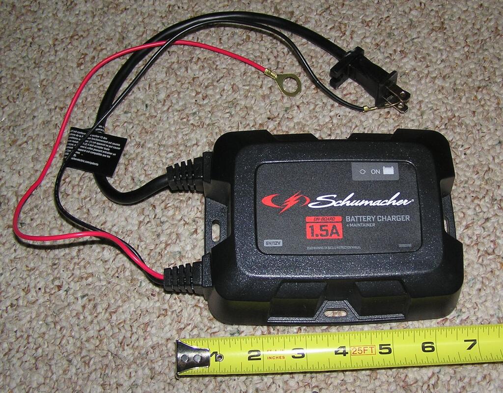

Wayne0 580 #1 Posted December 31, 2023 I recently bought a "maintainer" after several members recommended one. Any thoughts as to where I should mount this on a 520? Share this post Link to post Share on other sites
ri702bill 8,564 #3 Posted December 31, 2023 Is the case water PROOF?? If not, it may not last.... Share this post Link to post Share on other sites
Jon Paulsen 290 #4 Posted December 31, 2023 I would just mount it at a convenient location that doesn't get hot. Like not on the engine. If there's enough room, maybe just double stick tape it to the battery. Share this post Link to post Share on other sites
Wayne0 580 #5 Posted December 31, 2023 3 hours ago, ri702bill said: Is the case water PROOF?? If not, it may not last.... Yes, it is. Share this post Link to post Share on other sites

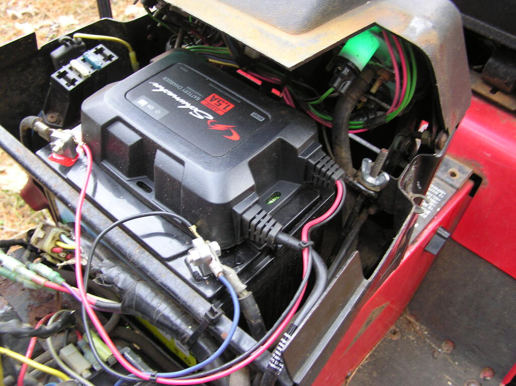

Wayne0 580 #8 Posted January 3, 2024 On 12/31/2023 at 4:55 PM, Jon Paulsen said: I would just mount it at a convenient location that doesn't get hot. Like not on the engine. If there's enough room, maybe just double stick tape it to the battery. Problem solved. 3M tape! 2 Share this post Link to post Share on other sites
lynnmor 7,388 #9 Posted January 3, 2024 Your battery hold down is pushing the battery posts towards the cross brace. Share this post Link to post Share on other sites
Rick3478 429 #10 Posted January 4, 2024 1 hour ago, lynnmor said: Your battery hold down is pushing the battery posts towards the cross brace. I noticed that, too. I don't have a 520, so don't know what's normal, what with all the extra gauges, but it looks sort of backwards from what I'm used to. Share this post Link to post Share on other sites
Handy Don 12,663 #11 Posted January 4, 2024 9 minutes ago, Rick3478 said: I noticed that, too. I don't have a 520, so don't know what's normal, what with all the extra gauges, but it looks sort of backwards from what I'm used to. Normal on ours has the hold down pushing the battery (in its plastic tray) back against a couple of flanges bent up from the “floor” of the hoodstand. The flanges keep the battery from getting pushed against the steering shaft or the gauges. 1 Share this post Link to post Share on other sites
Wayne0 580 #12 Posted January 4, 2024 Actually, the rim of the battery is above the brace, so the posts can't contact it. The posts are bass ackwards on this battery, but it works. Share this post Link to post Share on other sites

pfrederi 18,004 #14 Posted January 6, 2024 On 1/3/2024 at 2:29 PM, Wayne0 said: Problem solved. 3M tape! I was looking at the instructions for a nice battery maintainer it specifically said "Do Not mount the maintainer on the battery" Battery fumes/outgasses are corrosive and will damage it. 1 Share this post Link to post Share on other sites

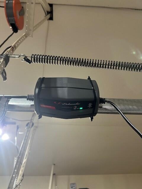

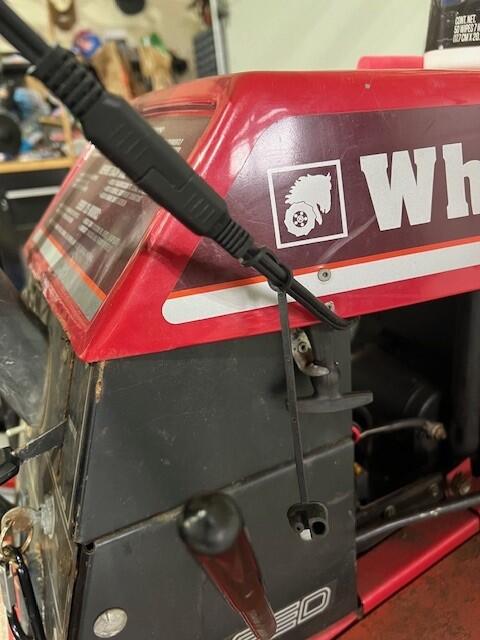

F. Marra 17 77 #15 Posted January 6, 2024 this is interesting as I never heard of mounting anything like this to any vehicle, tractors included. I mounted mine high up on the garage door track. (past where the door opens to obviously) and the tender lead wire hangs down to where i park the tractor. It came with a quick connect. the battery side lead has a rubber cover to prevent water or dirt while the tractor is in use and remains permanent on the batt terminals. I have had this set up for 5 years now and have not had a problem or have chnaged the battery yet. Starts on first crank. hope i didnt just jinx myself by typing that. 2 2 Share this post Link to post Share on other sites
Wayne0 580 #17 Posted January 6, 2024 (edited) 1 hour ago, pfrederi said: I was looking at the instructions for a nice battery maintainer it specifically said "Do Not mount the maintainer on the battery" Battery fumes/outgasses are corrosive and will damage it. The instructions that came with it don't say that, however, it makes sense. It's a sealed AGM, but I'm going to mount it remotely any way. I have a cord similar to @F.Marra 17. Edited January 6, 2024 by Wayne0 Share this post Link to post Share on other sites
