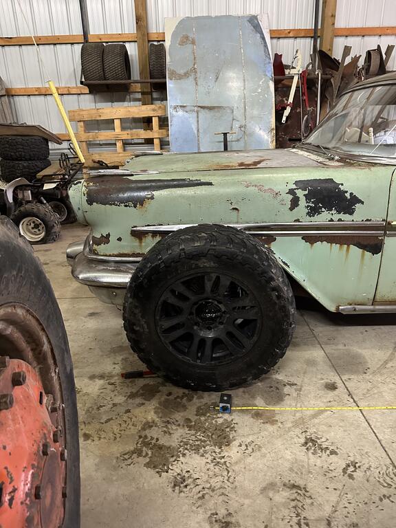

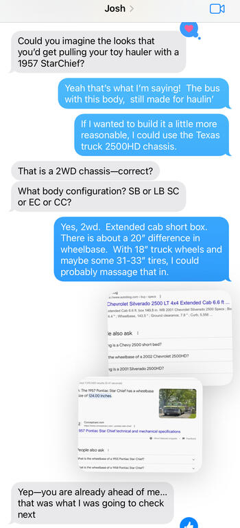

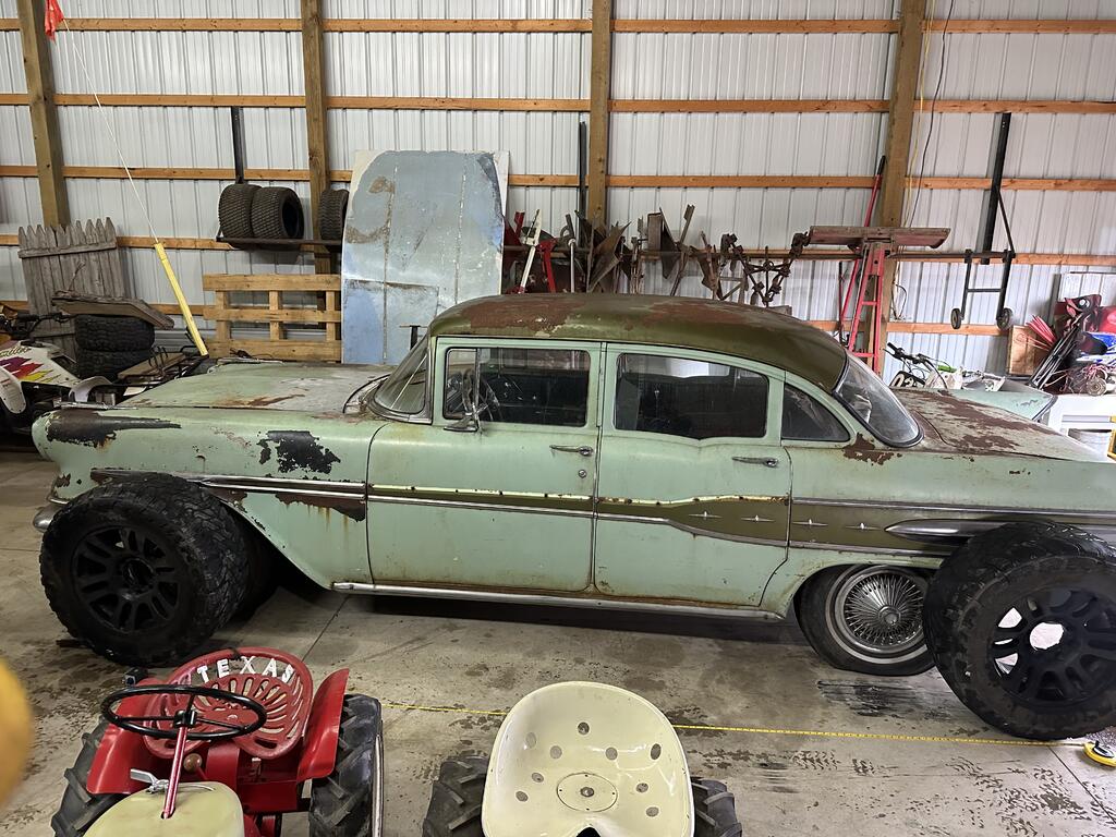

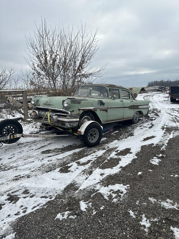

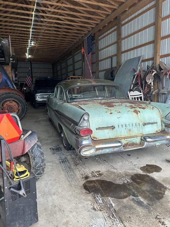

Pullstart 62,239 #1 Posted December 29, 2023 @8ntruck suggested a new thread, and I concur. I picked up this ‘57 Star Chief. 347/Auto 4 door. The car runs and drives but has it’s flaws. My vision is to finish up some active projects, and then get going on this. A short list, is the Ford Taurus engine, my bathroom trim, our wet bar, the FEL, and a couple other customer projects. The car is also buried by the camper in the barn, so there’s that timing too. I’d like the interior to stay as stock looking as possible. I’d like to keep the patina. Some modifications to the body will be necessary. I’d like this to be a Mad Max style resto-mod. I have a beautiful rust free 2001 Chevy 2500HD chassis. Being extended cab short box flavor, it’s 143.5” wheelbase is a bit longer than the car’s 124” stretch. This would place the rear axle about mid-trunk opening. Perfect location for a drop in 5th wheel hitch! As mentioned in the hot rods thread, the leaf spring hangers are indeed a bit long for this pipe dream, extending about 5” past the bumper’s current location. We’ll figure something out. Possibly there are shorter spring options as Chevy tended to use many different spring orientations and lengths. Maybe we will need a 4 link and air bags to allow bobbing the frame. More on that later. These are my wheels and tires from the truck frame, that will be used on the project, in their very accurate mocked up positions via roof tape measure on the floor. 5 3 Share this post Link to post Share on other sites
Pullstart 62,239 #2 Posted December 29, 2023 Yes, I would like this to sit on a truck frame. Capable of hauling my camper. Trunk lid on hood pins or the like, it could be removed for road trippin. The entire trunk floor will need to be rebuilt. The gas tank from the truck will be utilized. I would like to keep the car body as close to the truck frame as possible. I realize the frame designs are like apples and MTDs. Not much similar here, but it’s just metal. I mentioned the body, and wanting to preserve patina. And Mad Max. I do plan to cut and paste like Richard mentioned. Doing body work on Mrs. P’s “Frank” 1073 custom, I have the confidence to do this without bondo (or heavy bondo that is). We’ll see if I keep the battle scars from cut and paste, or not. Here’s a bit of context with @PeacemakerJack on the ideas for notes. He’s a wealth of knowledge on Pontiac history! Feel free to chime in Josh Share this post Link to post Share on other sites

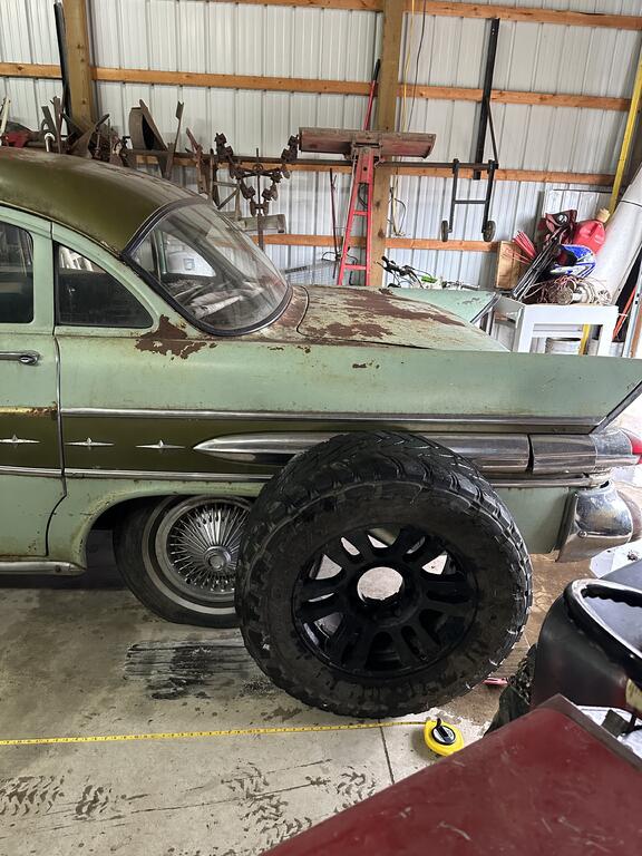

Pullstart 62,239 #4 Posted December 29, 2023 (edited) @953 nut Richard’s art work for reference. The wheel wells will need to move to make it look correct. I hope to be able to massage them in without making them a hack job. Precise cuts, symmetry, taking my time. I totally got this! Edited December 29, 2023 by Pullstart 3 Share this post Link to post Share on other sites
953 nut 54,508 #5 Posted December 29, 2023 27 minutes ago, Pullstart said: the leaf spring hangers are indeed a bit long for this pipe dream, extending about 5” past the bumper’s current location. We’ll figure something out. How about a fake continental kit to extend the bumper location? Rather than a shiny new tire cover an old hog trough would make a statement. 3 1 1 Share this post Link to post Share on other sites

ri702bill 8,142 #8 Posted December 29, 2023 I see potential here - I'm referring to the car !! Might just be easier to do a LS2 or 3 swap - very reliable, plenty of power & torque. Have you thought about splitting the difference on the wheelbase?? Move the rear axle forward a bit - you will need to alter the driveshaft anyways.... As pictured, the looong wheelbase will have a turning radius like the bus!! 1 Share this post Link to post Share on other sites
Pullstart 62,239 #9 Posted December 29, 2023 4 minutes ago, ri702bill said: I see potential here - I'm referring to the car !! Might just be easier to do a LS2 or 3 swap - very reliable, plenty of power & torque. Have you thought about splitting the difference on the wheelbase?? Move the rear axle forward a bit - you will need to alter the driveshaft anyways.... As pictured, the looong wheelbase will have a turning radius like the bus!! If the frame is kept stock, I can prove that it has the same load capacity as a stock truck. That’s my ultimate goal. Diesel will be the way to go. I have it laying around anyway and makes it an even better road tripper. Turn radius? It’s 2’ shorter than Norman. I’ll manage 2 Share this post Link to post Share on other sites

Achto 27,364 #18 Posted December 29, 2023 (edited) Just spit balling here, but wouldn't it be easier to shorten the truck frame to fit the car body? It would put your hitch behind the axle but you could compensate for that with a heavier rear suspension. Edited December 29, 2023 by Achto 2 Share this post Link to post Share on other sites

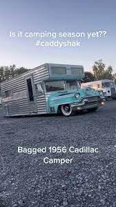

Achto 27,364 #19 Posted December 29, 2023 One other option. '57 Poncho united with a bus? Some thing like this. 1 1 5 Share this post Link to post Share on other sites

Pullstart 62,239 #24 Posted December 30, 2023 9 hours ago, Achto said: Just spit balling here, but wouldn't it be easier to shorten the truck frame to fit the car body? It would put your hitch behind the axle but you could compensate for that with a heavier rear suspension. Yeah… no…. Share this post Link to post Share on other sites
