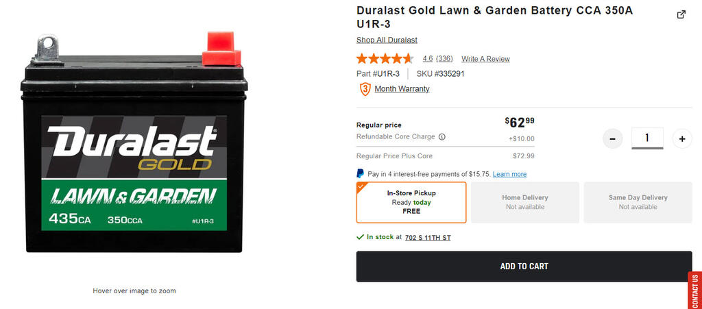

lynnmor 8,254 #6 Posted December 22, 2023 Get a 350CCA battery made by East Penn, there are a number of brands out there, I bought Duracell last time. Skip the cheap 230 CCA junk. 2 1 1 Share this post Link to post Share on other sites

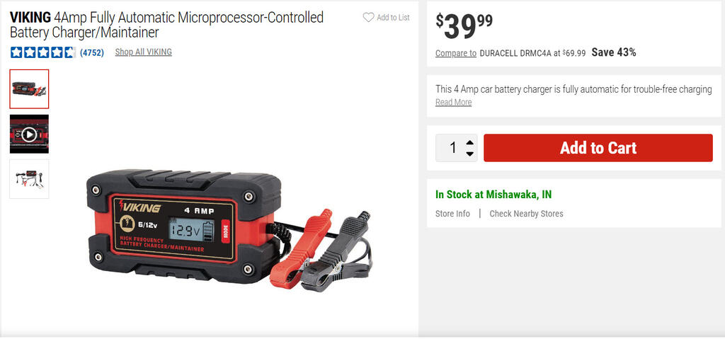

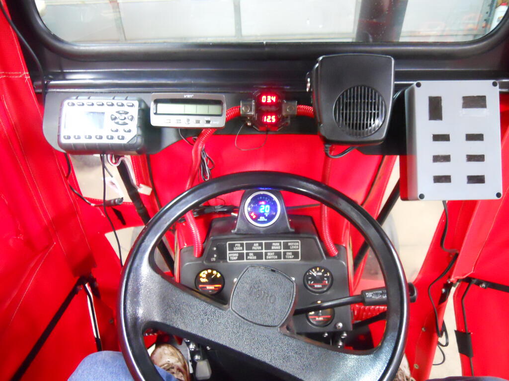

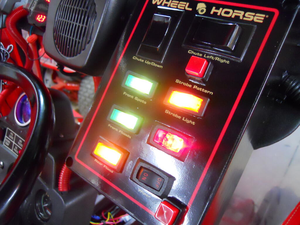

HorseFixer 2,013 #14 Posted December 26, 2023 (edited) Like others have mentioned, Don't buy cheap stuff! I buy Duralast Gold from Autozone and have that in my 520-H I keep a Harbor Freight Viking Microprocessor 4 Amp Charger plugged into all my Battery Tractors and have more Things Powered up on my 520 than 10 tractors. You wont loose a battery with a float charger hooked up. Edited December 26, 2023 by HorseFixer 1 Share this post Link to post Share on other sites
Wayne0 1,422 #15 Posted December 29, 2023 Impressive! You work for NASA? On another note, my tender came in yesterday. Where do you 520H guys mount them? Share this post Link to post Share on other sites
