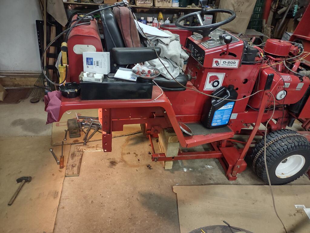

tmix61 81 #1 Posted December 19, 2023 (edited) Bought a used Rear end from a man changed out mine I did not have reverse. This newer rearend I had reverse and slowly went away giving up hope of having a plow tractor this winter it did have ATF in it I drained it and put 10W30. That's what my tractor was running before the rear end died I broke a bolt in it and had nothing but troubles after I replaced the bolt and some bearings inside flushed it out still didn't have reverse took that rear end out put in a newer rear end or another rear end drained the ATF out and filled it with 10w30 had reverse for about 4 or 5 minutes good strong forward gear but no reverse now. Edited December 19, 2023 by tmix61 Share this post Link to post Share on other sites

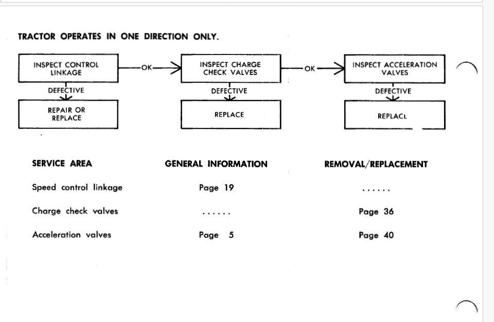

pfrederi 18,320 #4 Posted December 20, 2023 Download the Sunstrand Manual Diagnostic chart Charge pump check Valves are in the pump. replacing the transaxle and hydro motor won't address that issue. Share this post Link to post Share on other sites
