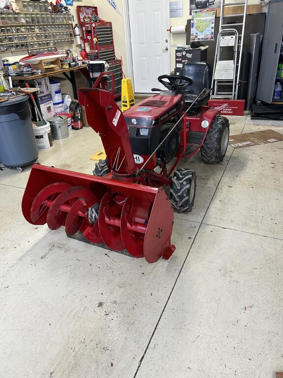

Manuel 8 #1 Posted December 18, 2023 Broke off the plastic nipple on the air cleaner vacuum sensor while removing the battery, Toro customer service told me to contact a dealer because they had no info on part number 94-1839… this is sad.. again told to call a dealer?.. is a joke. Dealer near me states they don’t have it but can order one for 140.00, ouch. Does anyone know if I can use the tractor without it? Is a 520h w serial number starting with 7900 model 73502. Was able to contact the part manufacturer and the were able to help , part 8111150 made back in 1996 , ordered one but due to holidays , may be looking at2 to 3 weeks but have no choice as the part price is under 50.00. Toro customer service is about to lose a loyal customer based on the lack of help they have provided. 1 Share this post Link to post Share on other sites

WHX?? 53,336 #4 Posted December 19, 2023 Pretty common ... Go see K & B horse parts in the vendor section. He has replacements. Nice looking rig BTW 1 Share this post Link to post Share on other sites
