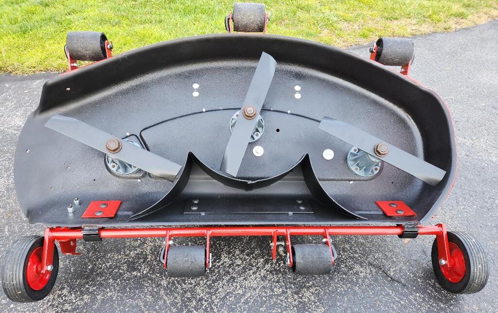

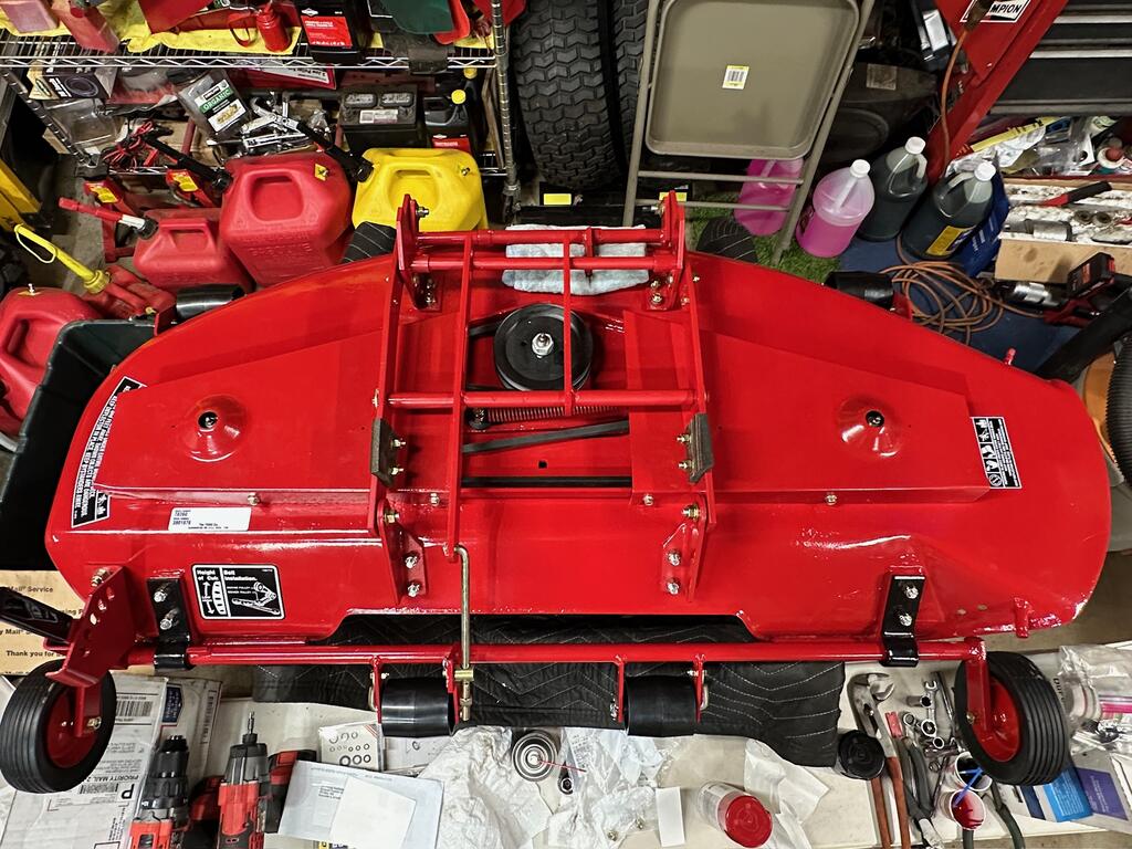

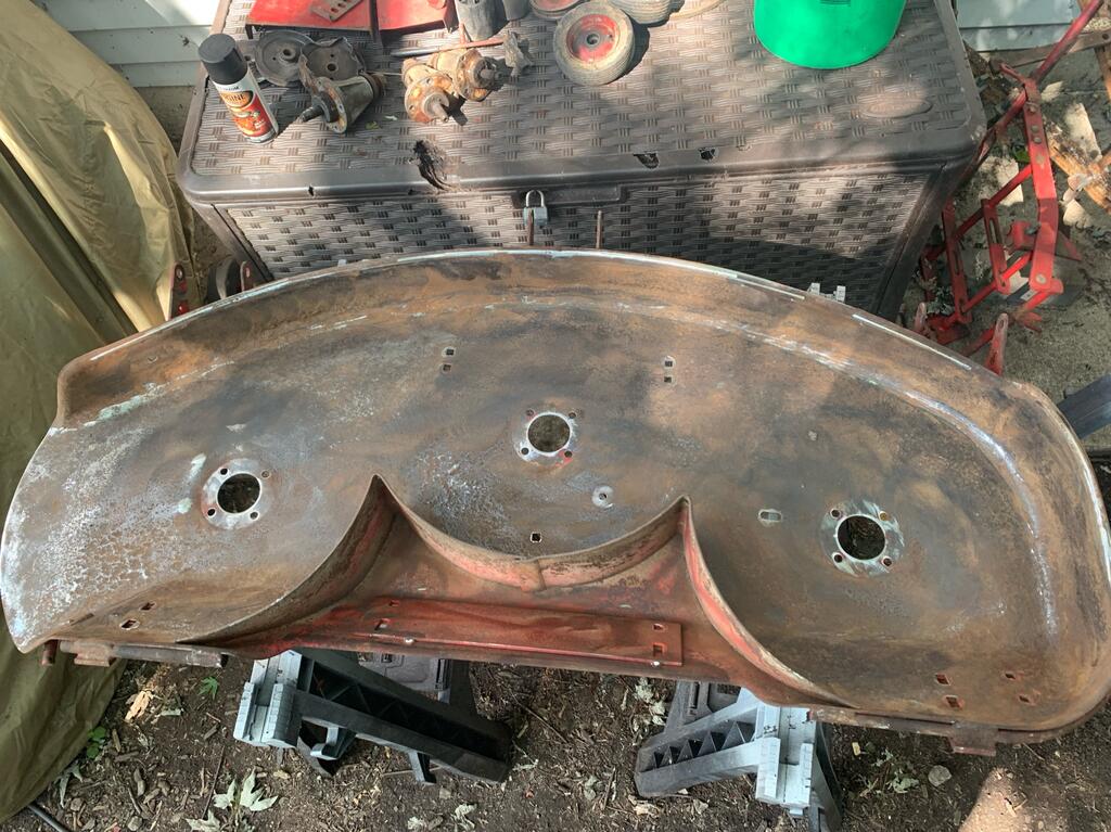

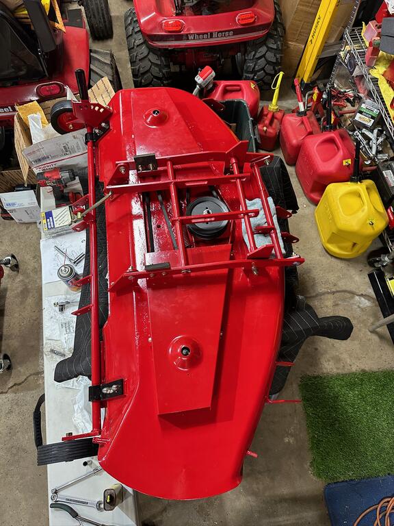

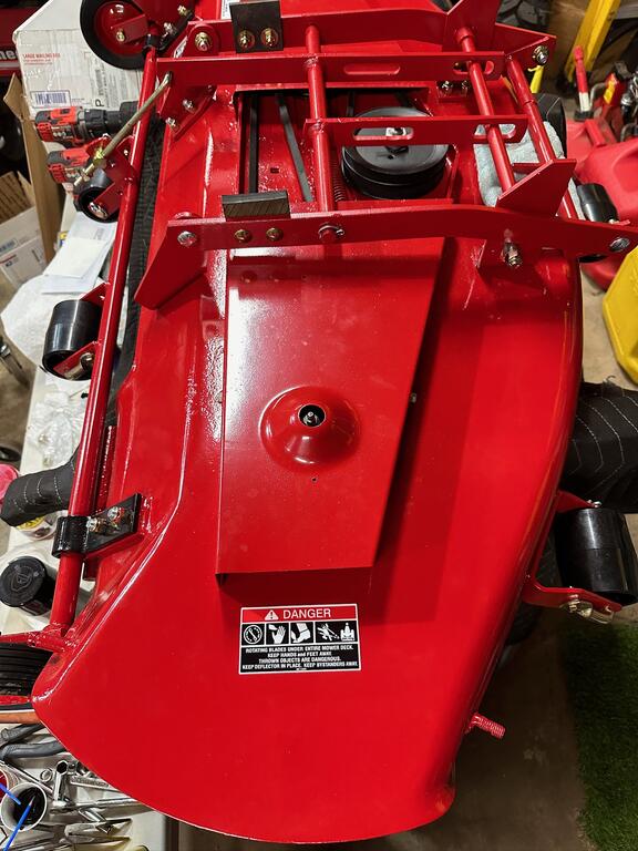

Andy N. 2,271 #1 Posted December 16, 2023 Finished up on my 48" SD deck restore. Here is the finished product. New blades are on order. Enjoy! 7 Share this post Link to post Share on other sites

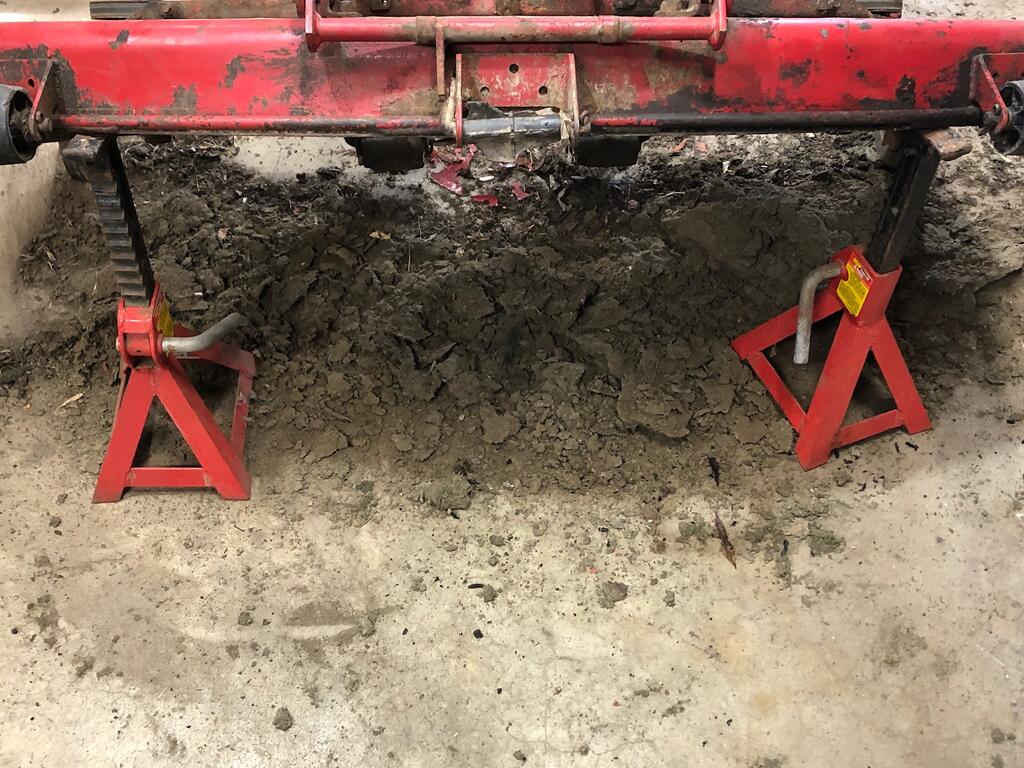

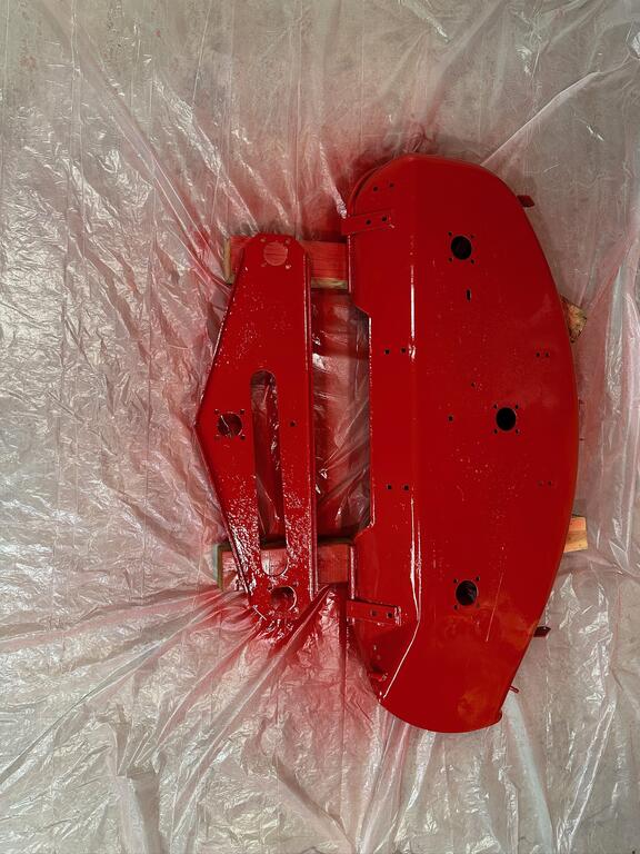

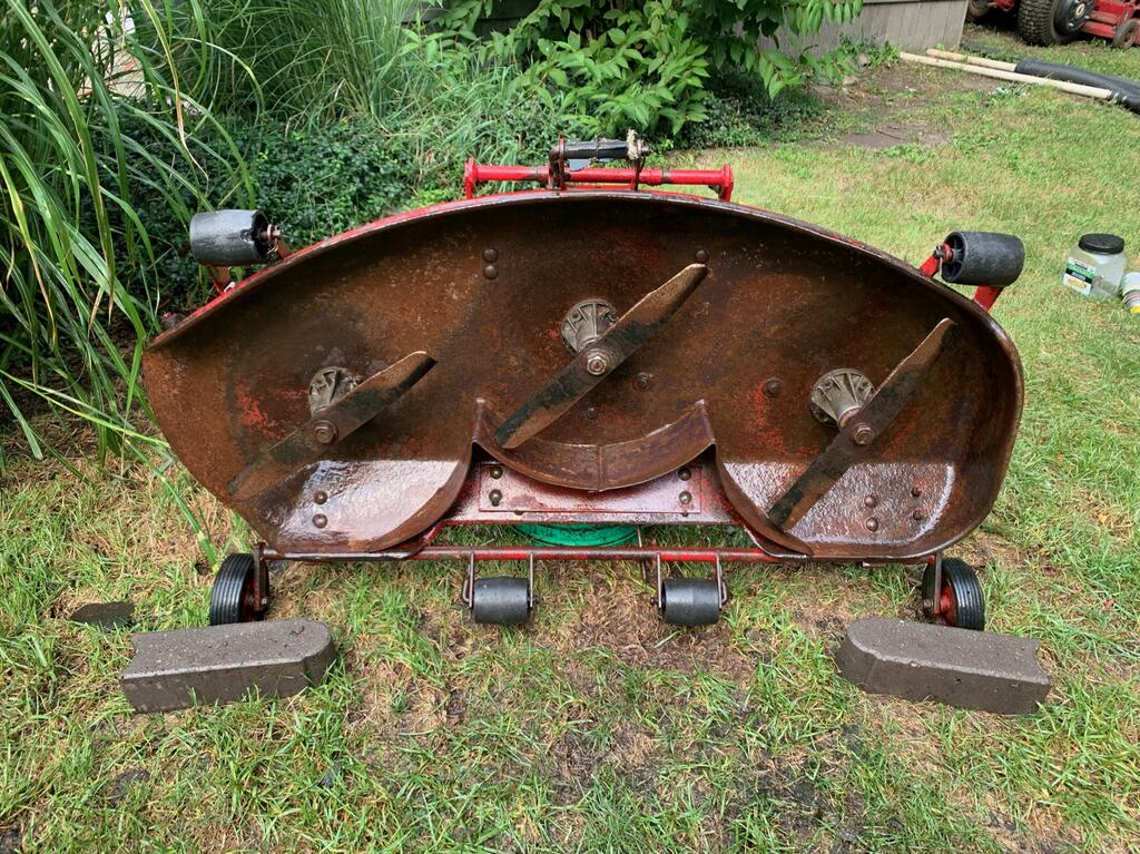

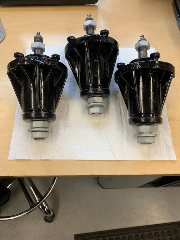

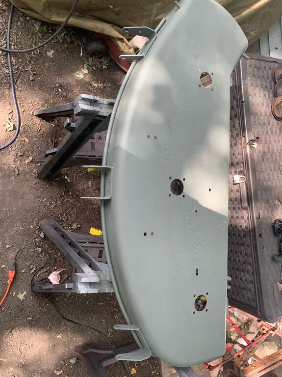

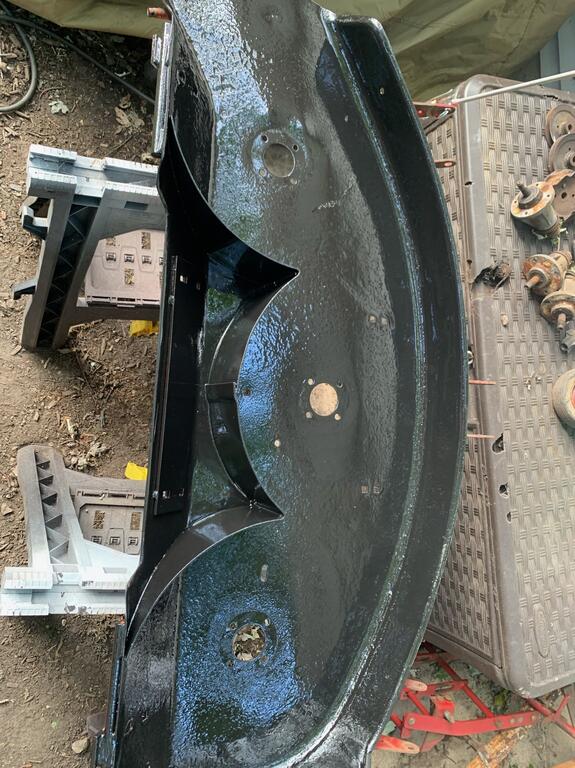

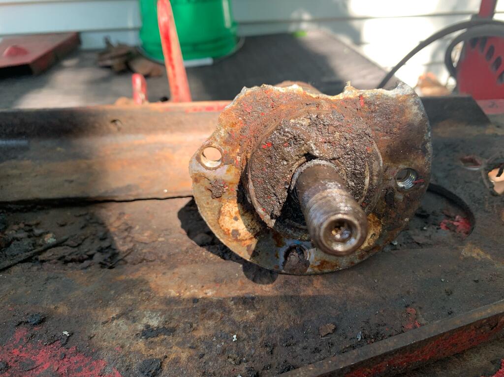

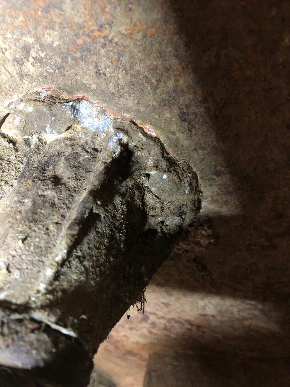

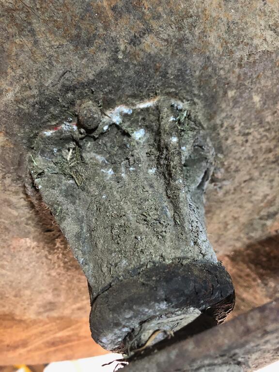

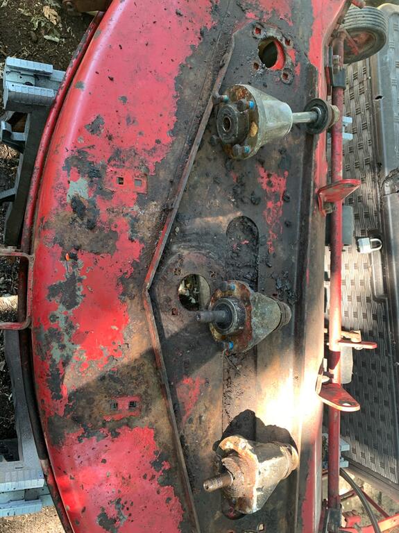

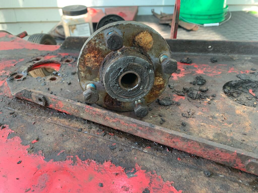

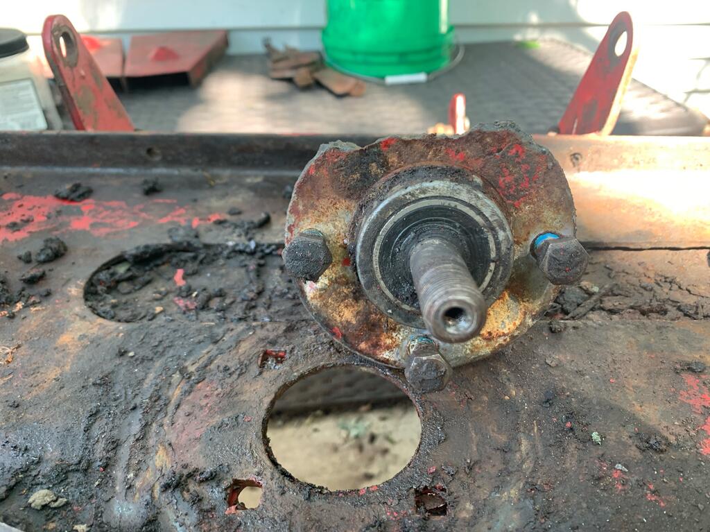

Andy N. 2,271 #2 Posted December 16, 2023 I started on this about 2 years ago, but got sidetracked by other projects and stuff. Here are some pics along the way. 1 6 Share this post Link to post Share on other sites
ri702bill 8,966 #3 Posted December 16, 2023 Excellent work - amazing how far gone the housings were that the deck shell survived well..... 4 Share this post Link to post Share on other sites

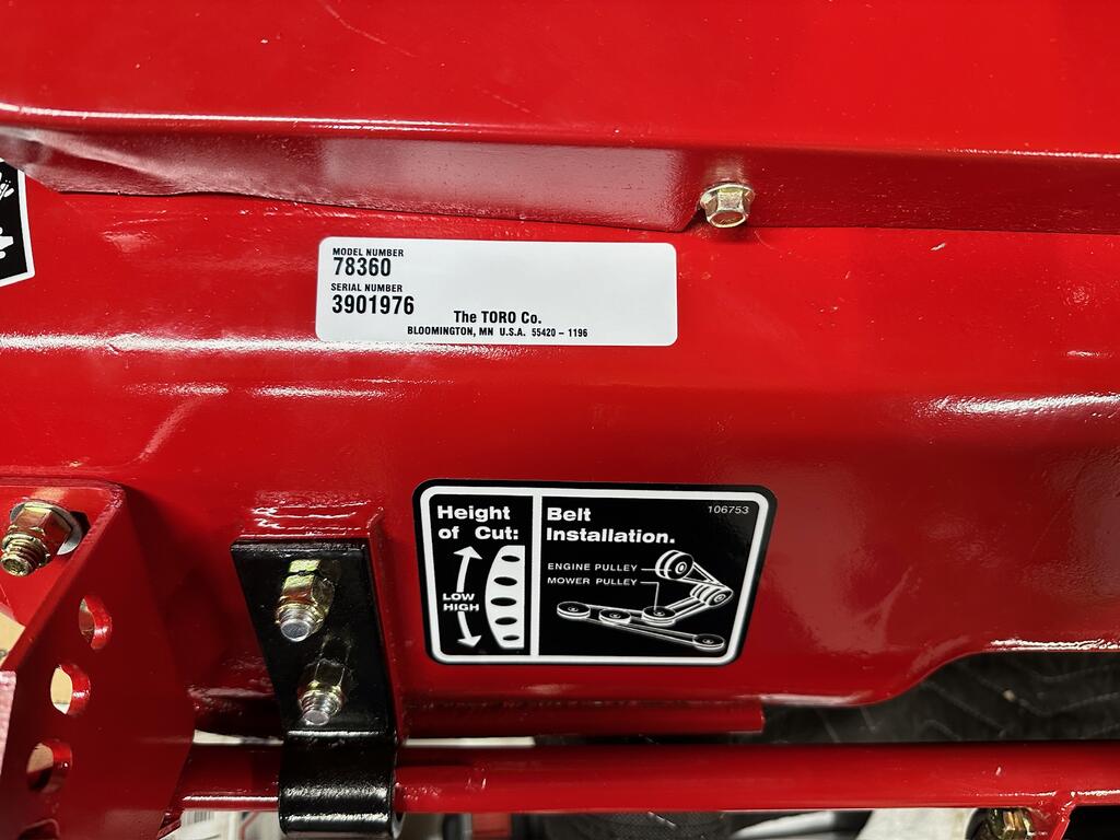

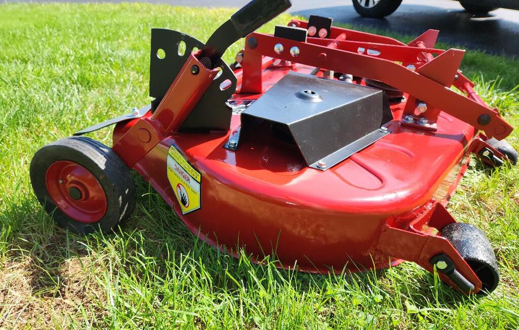

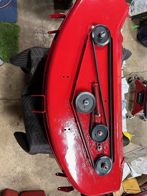

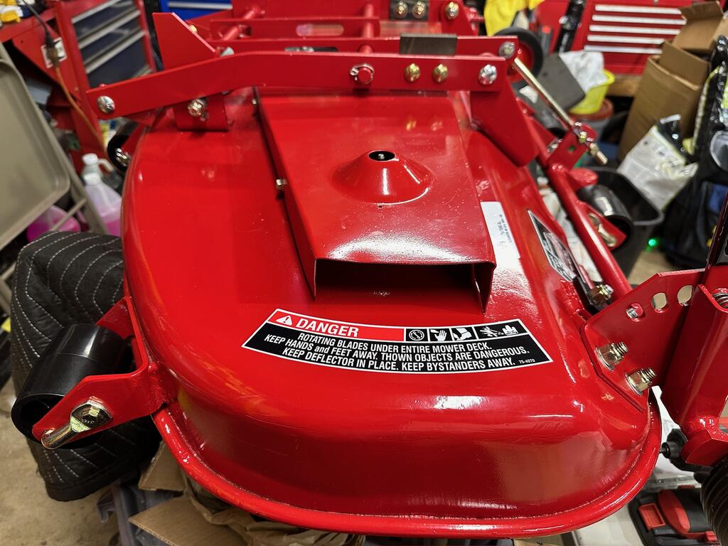

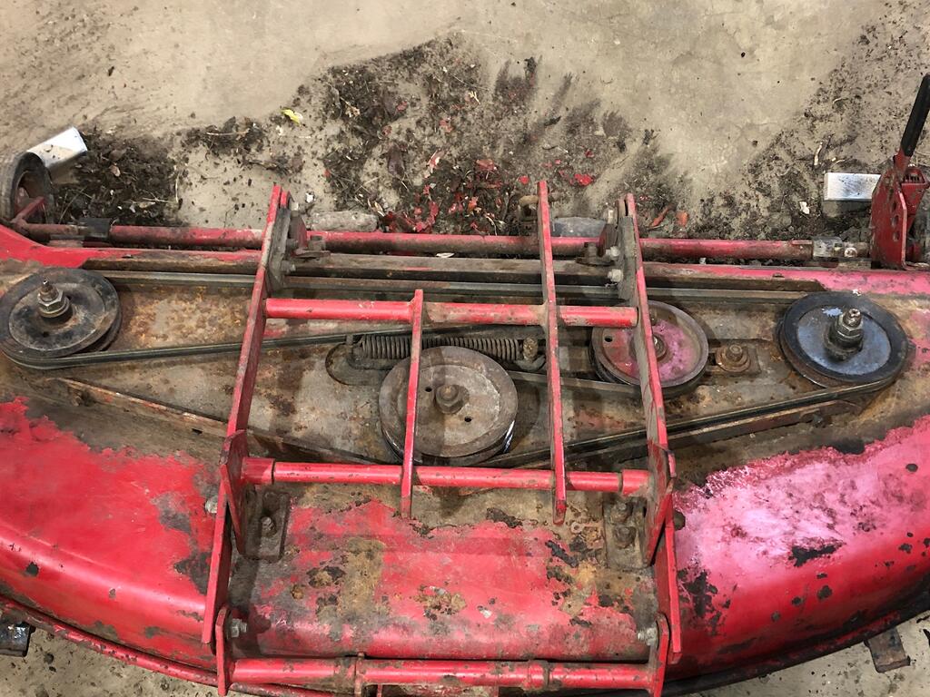

Brockport Bill 1,824 #5 Posted December 17, 2023 terrific - looks awesome!!! Did you get new complete spindles, or just housings, or what? I can relate the time and effort to do your deck!........... Here are some photos of a 42 sd and an 42 rd I just rehabbed in past 2 months. 4 Share this post Link to post Share on other sites

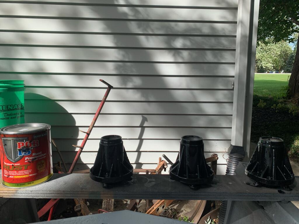

Andy N. 2,271 #6 Posted December 17, 2023 19 minutes ago, Bill Brockport said: terrific - looks awesome!!! Did you get new complete spindles, or just housings, or what? I can relate the time and effort to do your deck!........... Here are some photos of a 42 sd and an 42 rd I just rehabbed in past 2 months. Those decks look great! I got some used spindles on eBay that much better housings with very little corrosion damage. I rebuilt them with new bearings and treated outside of the housings with POR-15. 1 Share this post Link to post Share on other sites
8ntruck 7,380 #7 Posted December 17, 2023 POR-15 works on aluminum? Share this post Link to post Share on other sites
Andy N. 2,271 #8 Posted December 17, 2023 (edited) 20 hours ago, 8ntruck said: POR-15 works on aluminum? I've applied it to the underside of a couple decks and it sticks the same amount of time to the spindles as it does to the deck. I figure it's better than nothing as a corrosion barrier from the grass. And it's much thicker than paint. Edited December 18, 2023 by Andy N. 2 Share this post Link to post Share on other sites
