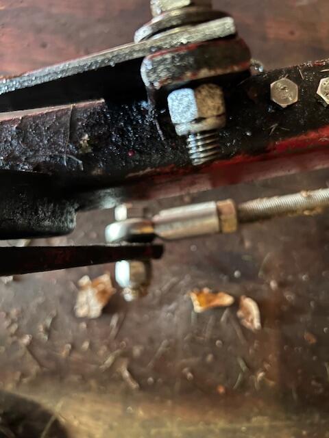

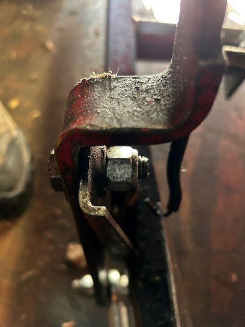

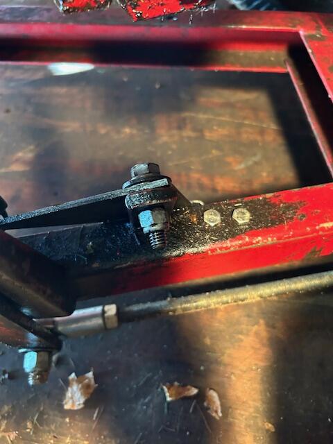

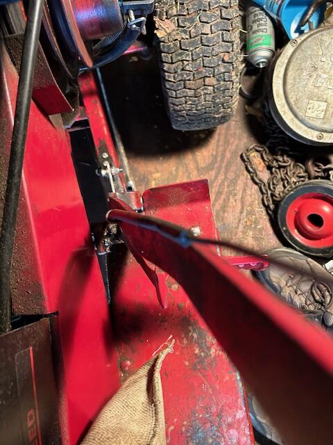

peter lena 9,938 #7 Posted December 10, 2024 @dmoore often refer to FUNCTIONAL DETAILING , on linkage / lever set ups , first photo shows plow lever squeeze triangle , improvement , partial threaded bolt , so unthreaded smooth spot , is now swing / movement / lubricated spot , held in exact , smoth , secure stop with elastic lock nut , dial it in ! also notice 1/2 " threaded heim joint, on plow blade swing arm , another one , on the bottom of the plow quadrant , push / pill point , maks for very solid / smooth quadrant direction . like red aerosol grease , especially at quadrat , compression spring / slide point . sounds / works like a rifle bolt . used small channel locks , to tighten up pull wire , movement spot , lubricate as you go , top squeeze lever , should have ZERO PLAY in its movement function , that and lube improvement function ,at every related movement point , makes for an amazing difference , in blade swing . lots of years on this , detail in every MOVEMENT stage , try , test, try , add a oil slick front of blade , for snow slide , free HP ! my plows move with total ease , with simple detailing , every bolt swing point , is lubed and nylock nutted to hold perfect resistance setting, pete Share this post Link to post Share on other sites
peter lena 9,938 #8 Posted December 11, 2024 @Tonytoro416 https://www.google.com/search?q=1%2F2+x+20+heim+jfemale+oint+fine+threaded+rod&sca_esv=16b82813b0686bd1&rlz=1C1CHBF_enUS866US866&sxsrf=ADLYWIIh0oDaCwGYKvzyzUwRCe2YZYGMZA%3A1733879779799&ei=4-dYZ7y7MIeh5NoP-omd2A4&ved=0ahUKEwj8uO7CxZ6KAxWHEFkFHfpEB-s , used straight 1/2 x 20 threaded rod , for matching size pull / push rods , perfect hole under steering quadrant , from original sloppy set up heim is on bottom of swing area , nut/ washer inside , its very easy , and the smooth easy function is very easy , detailing in , the squeeze lever , eliminating sloppy fit , is wat make this rock , what you are doing is eliminating sloppy play , lever hand compression spring is what runs movement function, like a rifle bolt , very smooth / solid , you have built in adjustment , take advantage of that ! first photo , triangular swing point , no excess play in the wire , the firmer the pull , the more response , red grease , lubricate blade face . for snow slide , no rust . pete Share this post Link to post Share on other sites
