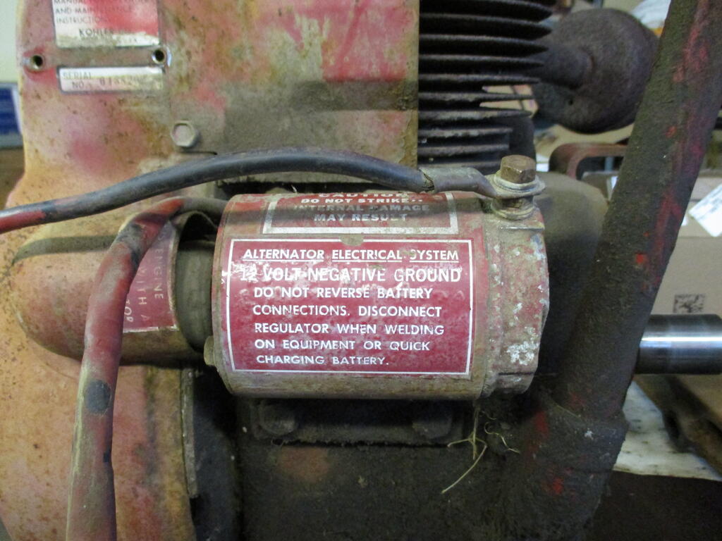

Ed Kennell 40,153 #27 Posted December 16, 2023 Make sure the ground is on a good clean metal surface as close as possible to the point you will be striking the arc. Path of least resistance ya know. You can remove the battery, engine, and all wiring, But with the ground at the wrong place, I would be more concerned about arcing thru bearings. 7 1 Share this post Link to post Share on other sites

WHX?? 50,388 #29 Posted December 16, 2023 (edited) 40 minutes ago, Ed Kennell said: Make sure the ground is on a good clean metal surface as close as possible to the point you will be strikingly the arc. Truth be told Ed I kinda wished I woulda had to go that route if nothing else to sharpen my welding skills. I can't toss the required 100 arrows a day to keep my bow skills up to date and goes even more for my welding skills. Edited December 16, 2023 by WHX?? 3 Share this post Link to post Share on other sites
