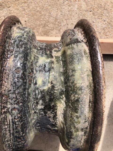

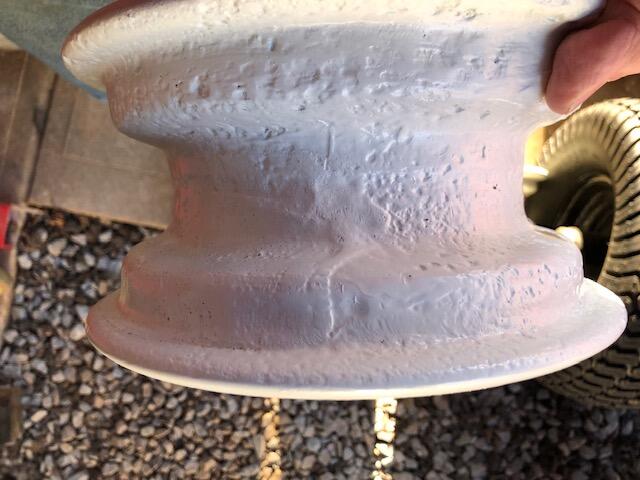

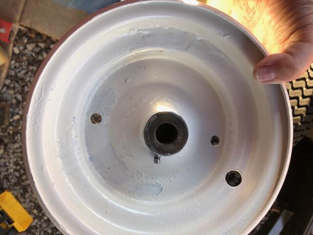

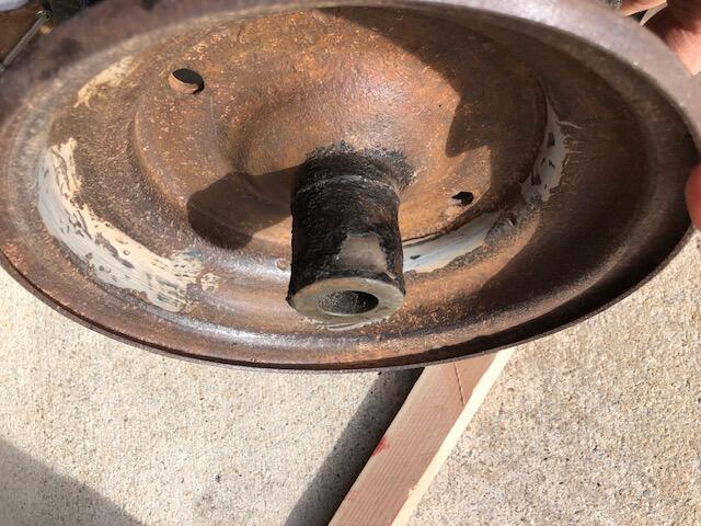

Sailman 1,299 #1 Posted December 12, 2023 All my tractors are workers so I do what is easy and cheap to keep them going. Rescued a 704 and wanting to get it running. Front rims were BAD shape and original replacements seem hard to come by so..... I do a lot of boat repairs with West System epoxies and fillers. One wheel had a hole a couple inches long where valve stem used to be and multiple pin holes. I had good luck with pin holes and JB Weld on my GT 14 so I used the West epoxy and fiberglass to patch the rim from the inside, then JB Weld to finish on the outside. I always use tubes in this configuration and have good luck with the results. Probably not what the purists would do but hey...sailor's got to do what a sailor's got to do! BEFORE; AFTER; 11 3 Share this post Link to post Share on other sites

kpinnc 13,725 #3 Posted December 12, 2023 (edited) 1 hour ago, Sailman said: Probably not what the purists would do but hey...sailor's got to do what a sailor's got to do! I think that is a very good repair. My only "+1" addition would be to ask if the epoxy will stick to something that inhibits rust like red oxide primer or some other dry inhibitor? Either way, that should be a years-long fix! Edited December 12, 2023 by kpinnc 2 Share this post Link to post Share on other sites

Sailman 1,299 #6 Posted December 12, 2023 6 hours ago, kpinnc said: I think that is a very good repair. My only "+1" addition would be to ask if the epoxy will stick to something that inhibits rust like red oxide primer or some other dry inhibitor? Either way, that should be a years-long fix! Can't say for sure about sticking to the primer. I took the rims down to metal as much as possible. I will say this....the west system epoxy repairs I have done on wood are so strong if you try to remove it, it will simply break the wood in a new place, not the bond. 1 Share this post Link to post Share on other sites
