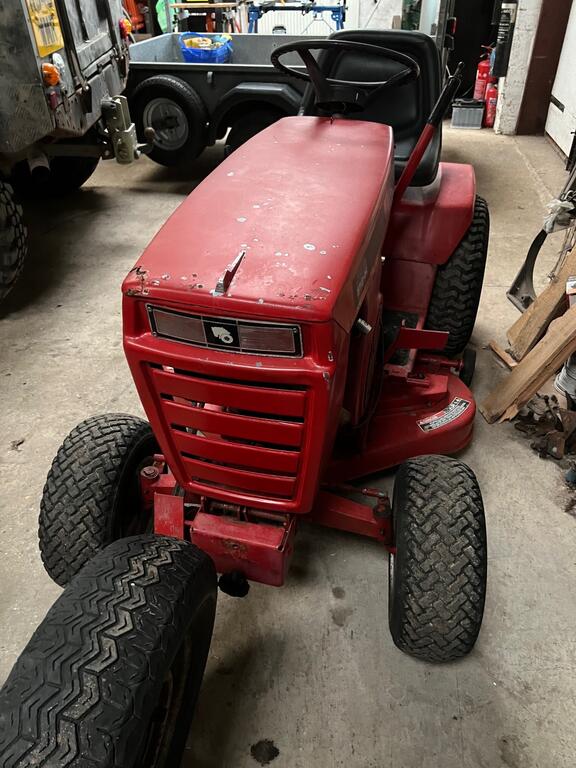

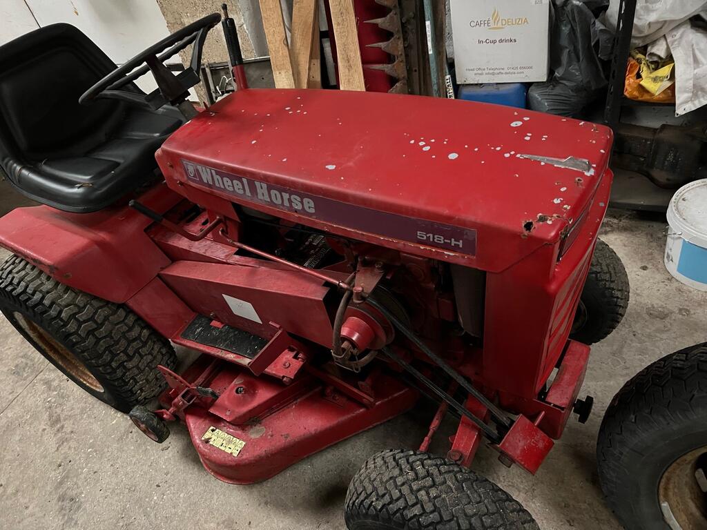

Kev_the_Mole 21 #1 Posted December 6, 2023 Bought my first Wheehorse and the vendor said it was not a 518-H and thought it was a C-180 but that does not seem to exist. There are no plates/stickers for either machine or motor. HELP please. 2 1 Share this post Link to post Share on other sites

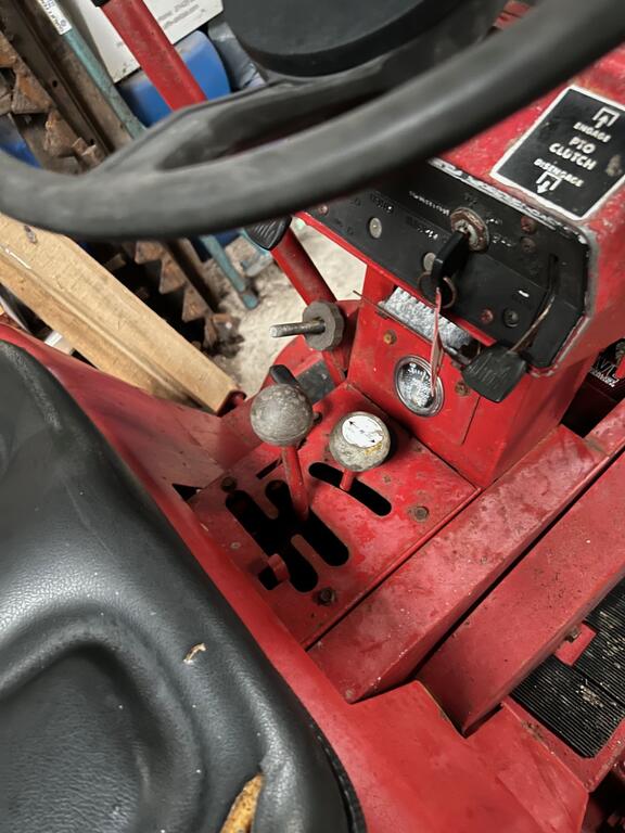

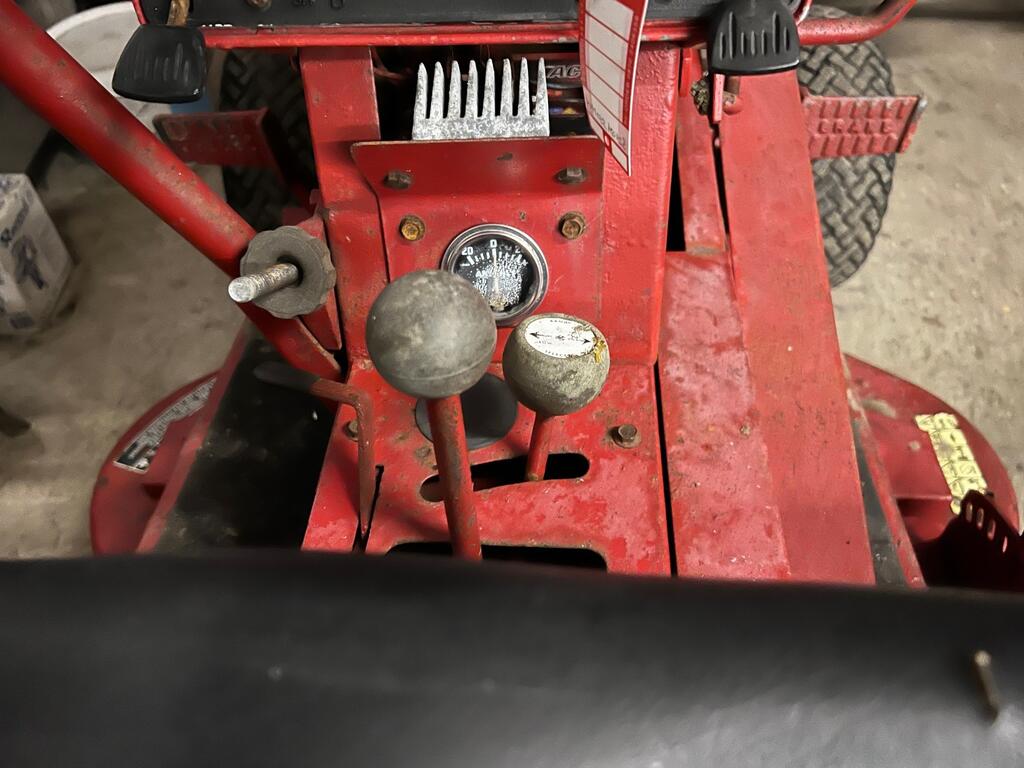

Lee1977 7,036 #2 Posted December 6, 2023 (edited) Looks like a 1974 or 1975 C-120 8 speed. Has the extra belt cover for a tiller or vacuum.' Missed that picture with the shifters. Edited December 6, 2023 by Lee1977 5 Share this post Link to post Share on other sites

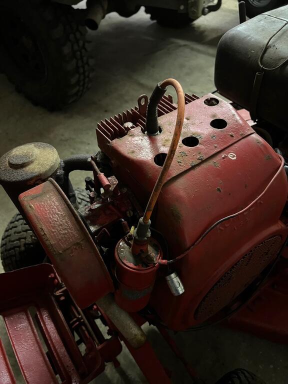

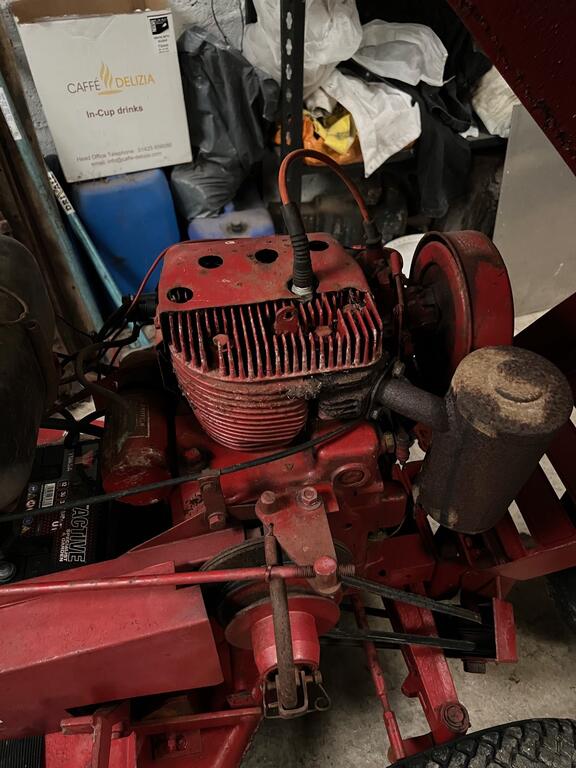

8ntruck 7,379 #3 Posted December 6, 2023 Not a hydro - it has a hi/low range lever, making it an 8 speed. Big block in it, making it a 12, 14, or 16 horsepower. A no name maybe? Any chance for pictures of the serial number plate for the tractor (probably left hand side of dash support) or the number plate on the engine? 3 Share this post Link to post Share on other sites
Kev_the_Mole 21 #4 Posted December 6, 2023 1 minute ago, 8ntruck said: Not a hydro - it has a hi/low range lever, making it an 8 speed. Big block in it, making it a 12, 14, or 16 horsepower. A no name maybe? Any chance for pictures of the serial number plate for the tractor (probably left hand side of dash support) or the number plate on the engine? No plates at all, sorry 1 Share this post Link to post Share on other sites
Darb1964 1,093 #5 Posted December 6, 2023 Looks like it needs a head gasket, newer seat, nice tractor. 4 Share this post Link to post Share on other sites
ri702bill 8,963 #6 Posted December 6, 2023 He is in the UK - tractor is a model made in Belgium????? 3 Share this post Link to post Share on other sites
953 nut 57,861 #7 Posted December 7, 2023 1 hour ago, 8ntruck said: Not a hydro - it has a hi/low range lever, making it an 8 speed. Big block in it, making it a 12, 14, or 16 horsepower. A no name maybe? Any chance for pictures of the serial number plate for the tractor (probably left hand side of dash support) or the number plate on the engine? Not enough head bolts to be a 16 HP, could be 10, 12 or 14 though. Looks like a 1975 C to me. 2 Share this post Link to post Share on other sites
gwest_ca-(File Mod) 11,243 #9 Posted December 7, 2023 Good chance this was sold as a Raider between1973 and 1975. A few have been recorded so look for a SN in the file title. The Raider ended for the North American market in 1972 but continued in Europe. https://www.wheelhorseforum.com/files/category/9-1973-1977/?sortby=file_name&sortby=file_name&sortdirection=asc 4 Share this post Link to post Share on other sites
Hans Hjarner 17 #10 Posted December 7, 2023 (edited) I think that is a Belgian 74, because it had no ptobrake on it! B100,C120 or a Raider 12( like me) from 74! I think C120 and Raider 12 are exaktly the same this year, my 1-0353 is decaled Raider 12 in Belgium, but C120 in USA!! Edited December 7, 2023 by Hans Hjarner 3 1 Share this post Link to post Share on other sites

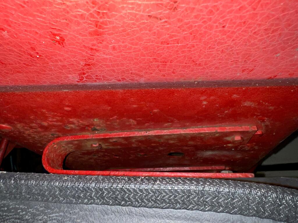

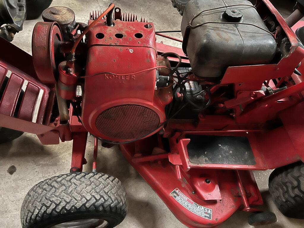

Kev_the_Mole 21 #12 Posted December 9, 2023 Finally found a sticker that wasn't fully painted over. It's got a Kohler K241S, which according to the PDF manual I have means that it's a model C-105. It's like industrial archaeology. 2 1 Share this post Link to post Share on other sites

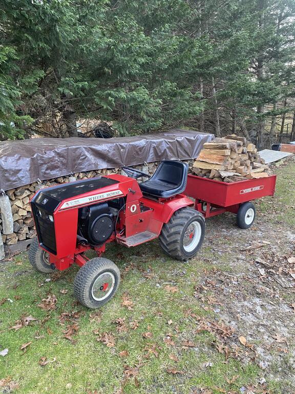

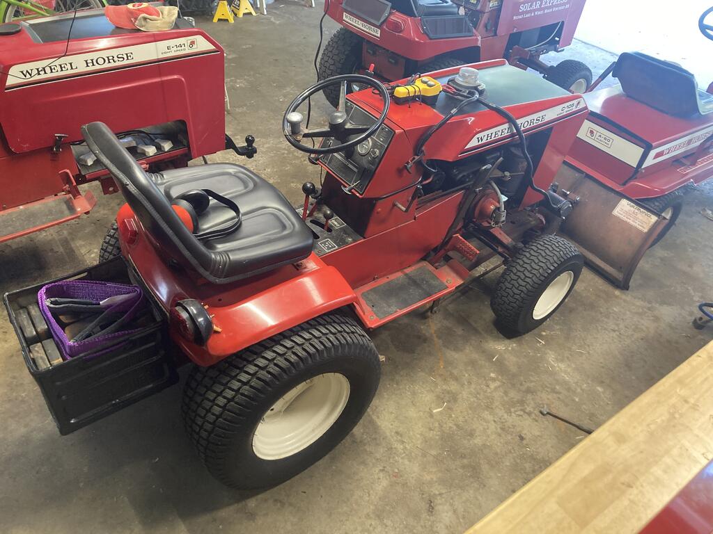

c-series don 9,425 #13 Posted December 10, 2023 Your tractor is definitely not a C-105. The C-105 was made in the early eighties, your tractor was made in the early to mid seventies. Here’s my C-165, the same body style as a C-105. Good luck with your tractor! 4 Share this post Link to post Share on other sites
SylvanLakeWH 27,500 #14 Posted December 10, 2023 Here's my C-105: 2 1 Share this post Link to post Share on other sites
