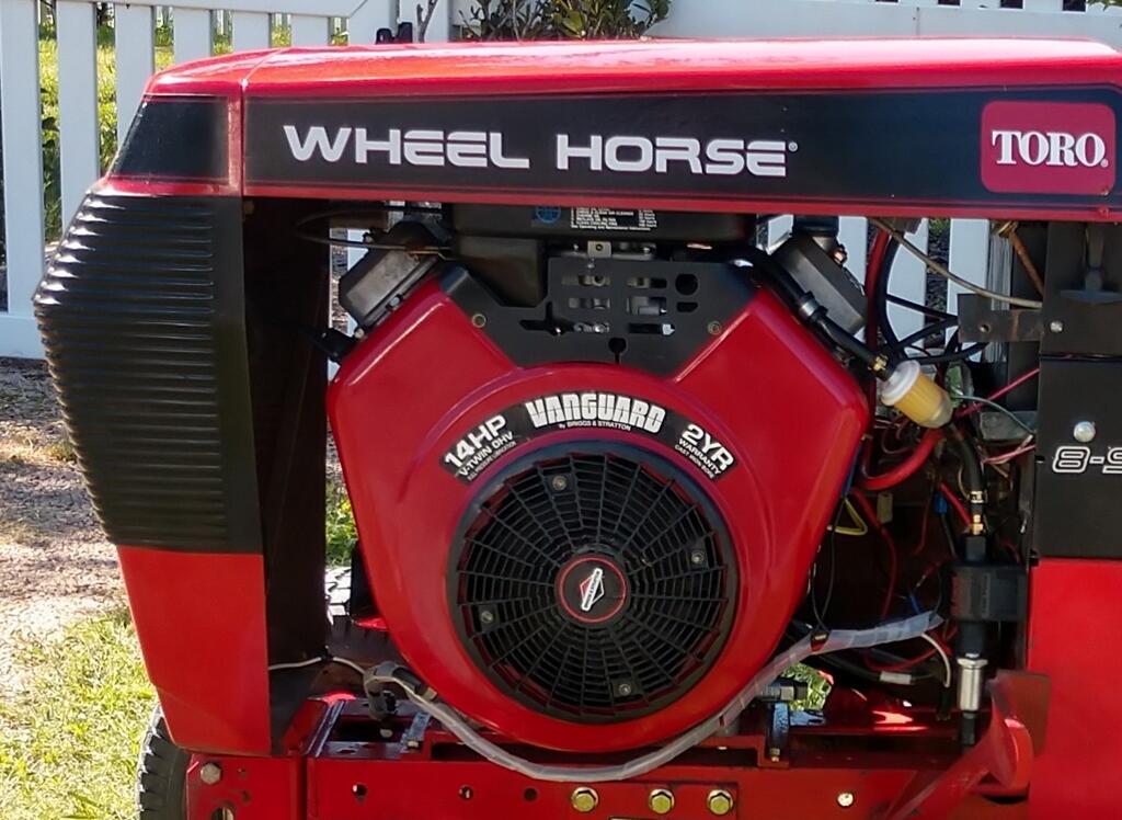

kpinnc 13,727 #6 Posted December 6, 2023 Vanguards might be an option. They have a very small footprint and are much shorter than an opposed twin of any flavor. Also much smaller than Kohler or Predator v-twin as well. Might require some creativity with the air cleaner, but there are options for it. 2 1 Share this post Link to post Share on other sites
