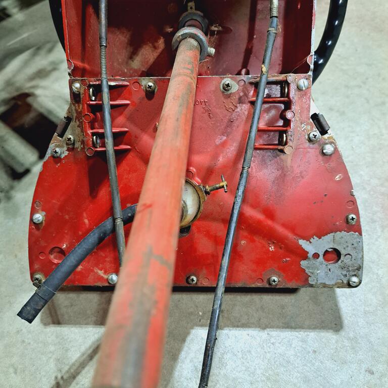

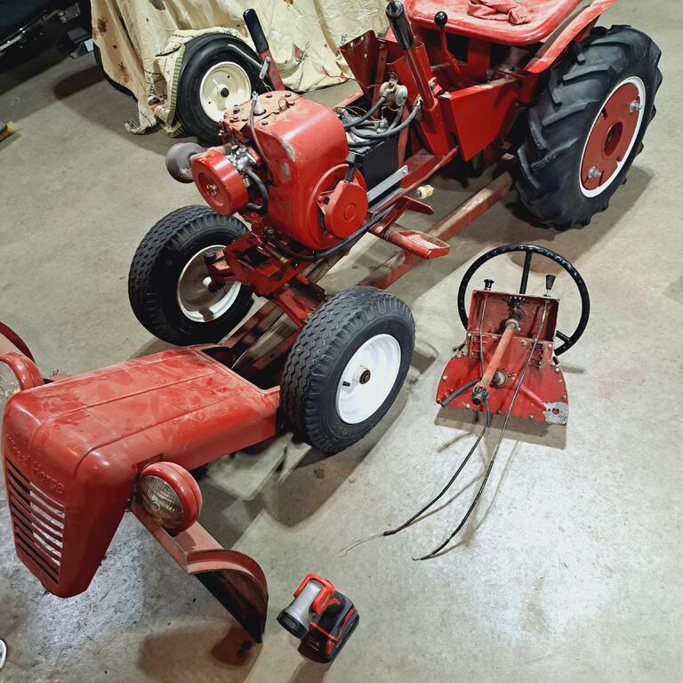

WHX?? 50,701 #1 Posted December 5, 2023 Kinda already know where I am leaning on this but would like some advise. 502 two-piece leaks. Sat for who knows how long so gasket dried up. Get a gasket from Lowell or seal it? I have a kit of KBS sealer that did not fail me on a Tecky tank and I have a tank off the Amigo that I need to use it on. The kit will seal at least two or four small tanks and still end up wasting some. 502 tank is clean as a whistle as AL tanks should be so sealer should take well. Someone's been it it it before. Afraid to mess with them screws to replace gasket. 4 Share this post Link to post Share on other sites

Handy Don 13,340 #4 Posted December 5, 2023 Boils down, in my mind, to “Can you get the screws out?" You and Dan have the gadgets for carefully drilling out a broken screw and re-threading. It looks to me like there are six “new” screws in there already and that bodes well for getting all fifteen! I had two that broke off and then I realized that the tank was bent--the tractor must’ve fallen over or been hit. Went with a one-piece I got from A-to-Z and made a custom dash for it. 2 1 Share this post Link to post Share on other sites

WHX?? 50,701 #6 Posted December 5, 2023 4 minutes ago, Handy Don said: “Can you get the screws out?" Therin lies the problem Don ... maybe shouldn't even try to open that can of worms. Gotta remember this is all soft AL with steel screws. @Pullstart knows. Yah if a one piece should happen to just fall from the sky... no brainer. 2 Share this post Link to post Share on other sites

WHX?? 50,701 #9 Posted December 5, 2023 (edited) Wher I was going Don since I got the kit. Just not sure how it works on AL tanks. Maybe I go read the destructions again. Was that tank you got from Wild Bill a two or a single piece? Edited December 5, 2023 by WHX?? Speeling 2 Share this post Link to post Share on other sites

Racinbob 11,720 #15 Posted December 5, 2023 I'm definitely with the seal it crowd. Even with replacing the gasket it's going to seep out again. I've used Red Kote several times with 100% success but I'm sure the KBS that you have will do the trick too. I do take it apart to get everything spotlessly clean and replace the gasket but I don't rely on the gasket to seal it. I put a sacrificial nylon fitting in the hole just in case, I only use enough sealer to let it flow around the gasket area. Maybe 1/4 cup. 1 1 Share this post Link to post Share on other sites
ri702bill 8,963 #16 Posted December 5, 2023 8 hours ago, Handy Don said: Ah the mystery! Yes, ’61 & 62 were 1-piece, and ’63 & 64” were two-piece. Square hood in ’65 with “pillow” tanks. And yes, my screws were all ¼” hex on the 854 tank. 2¢ here is that isn’t an original tank and none of the screws are original! Hmmm... my 502 came with a 2 piece tank, the 702's and the 701's had a 1 piece tank.... Either way, that tank is worth fixing - even the 2 hood screw speednuts seem intact and not broken out. The big advantage to disassembling the tank is it allows you to do a thorough cleaning on the inside surfaces. One more "fix" option not yet discussed. Disassemble it, remove all traces of the gasket, and TIG weld it back together..... 3 Share this post Link to post Share on other sites

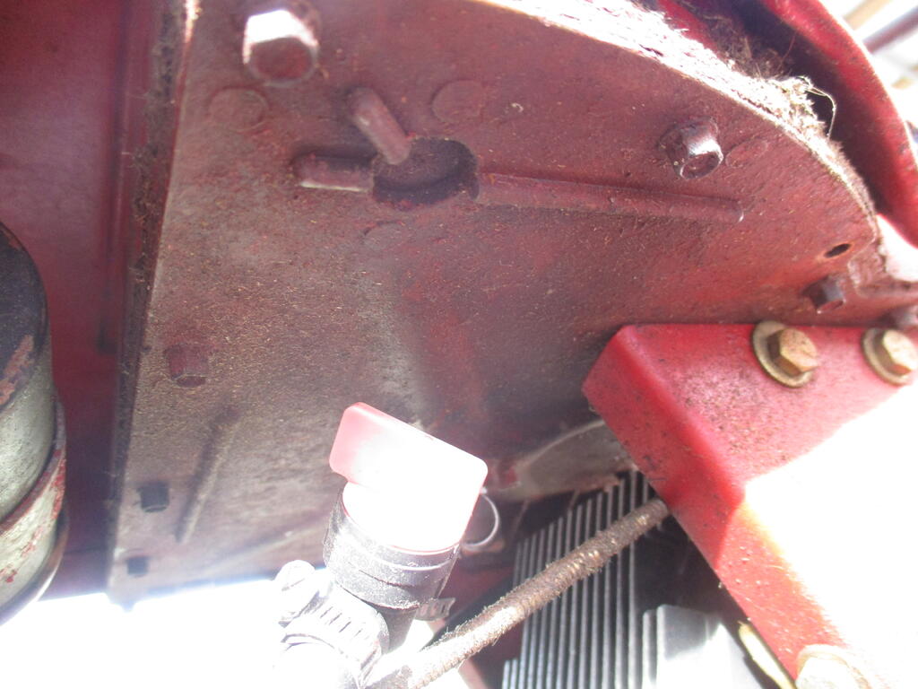

Kenneth R Cluley 582 #22 Posted December 5, 2023 Here is a pic of my 653 two piece tank. It' a 63. I used red kote and sealed, with good results. The tank in your pictures has definitely been open. I would be hesitant to try to get those screws out. Slotted ones are common galv/zinc, but phillips look like could be stainless, that would be a bear to drill out if broken off. "Sorry EB" On one hand it has been open recently, on the other how well was it "repaired" at that time? 3 Share this post Link to post Share on other sites

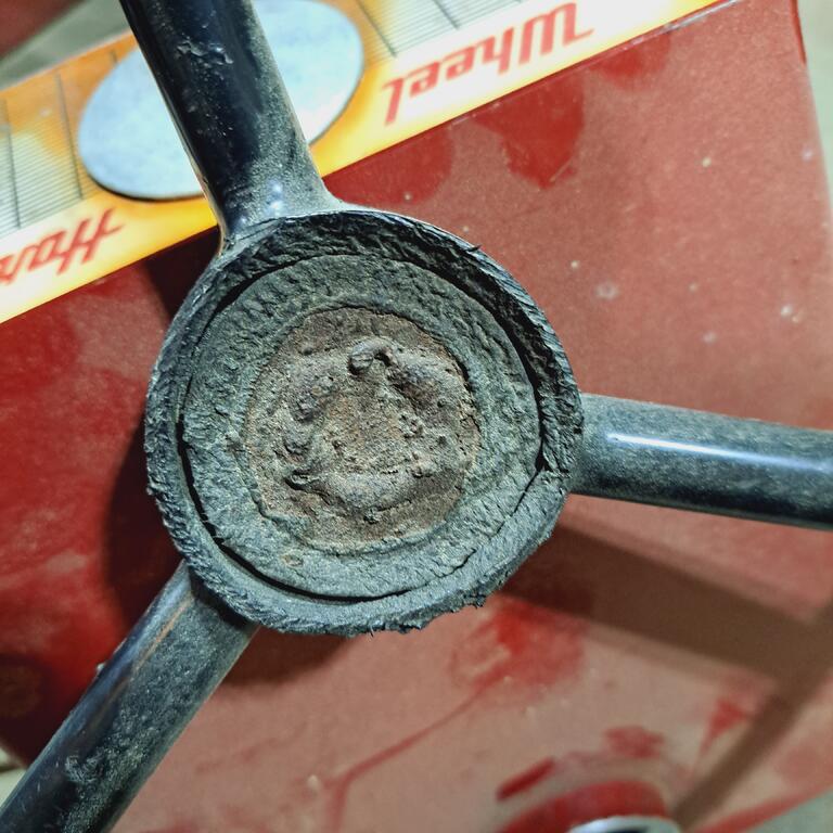

WHX?? 50,701 #23 Posted December 5, 2023 4 hours ago, ri702bill said: disassembling the tank is it allows you to do a thorough cleaning on the inside surfaces. The pre treatment chemicals in the kit do a good job of that. I've used the KBS kit before and the stuff does work. The speed nut areas looks pretty good except for one crack starting so I may weld that up a little. If it still had the orginal hex screws I would remove them but not for this one. Who knows what them threads look like. Bowl stays Greasy Pete I'm an original freak. Most likely a new one that leaks too tho. Steering shaft stays too... I should take this opportunity to make it right & just might if whatever cockamamy pin is in there comes out and I don't chance on messing up the wheel. 1 1 Share this post Link to post Share on other sites

Handy Don 13,340 #25 Posted December 5, 2023 10 minutes ago, WHX?? said: The pre treatment chemicals in the kit do a good job of that. I've used the KBS kit before and the stuff does work. Chemistry can be fun! Bowl stays Greasy Pete I'm an original freak. Most likely a new one that leaks too tho. I like the bowls, too. Got mine to stop leaking with self-made, slightly more pliable cork/rubber gasket and new rubber compression ring on the valve stem. Steering shaft stays too... That weld hack is sad. Just sad. I should take this opportunity to make it right & just might if whatever cockamamy pin is in there comes out and I don't chance on messing up the wheel. 👍 1 Share this post Link to post Share on other sites
