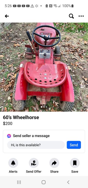

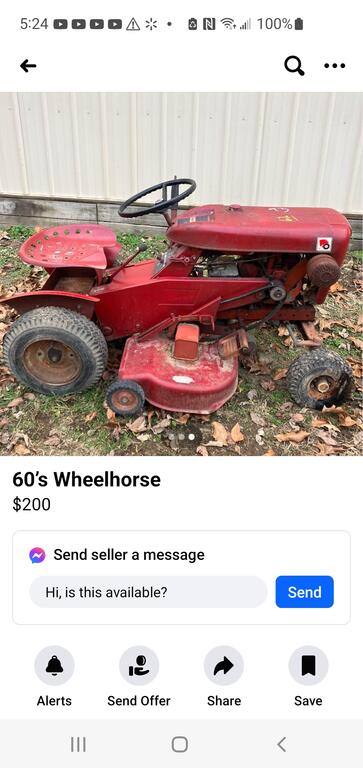

Would anyone know approximately what year this is??
Is the tool box and fenders the same as a round hood?? The hood and dash stand looks alot like a 704 I have.

'62 & '63 had the clam shell rear fenders. '65 - '68 had a flat rear fender pan.
The hood and dash stand from the 62 & 63 should interchange with the 704.

The rear fenders are  similar to the 702-704, but smaller. Not sure about the toolbox.... Same Unidrive as the bigger ones...

 Mistype on my account, 64 had clam shells as well.
Terry M
It’s a 1964..64 lawn ranger is the only year with the rear fenders, hood and slanted hood stand like what you show in that pic along with a few other items.  Also came in two variations with and without electric start .
I wonder if they are the same as RJ fenders?
whtractors24
Early lawn rangers used round fenders .
kpinnc
Yes. Same as Suburbans anyway.
