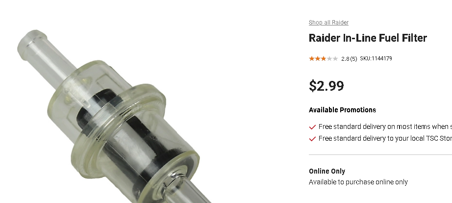

Achto 30,166 #2 Posted November 27, 2023 12 minutes ago, JoeM said: Anyone got a better filter suggestion? Don't know if it's better, but another alternative. I have started to switch over to Raider fuel filters normally made for snowmobiles. No paper or cloth filter inside, just a fine screen. Microns / Shmicrons, if it's small enough to go through the fine screen it won't hurt the engine anyway. Most factory fuel systems only relied on a fine screen. https://www.tractorsupply.com/tsc/product/raider-in-line-fuel-filter-1144179?cid=Shopping-Google-Product-1144179&gad_source=1&gclid=EAIaIQobChMI4c_wjrjkggMVqczCBB3AOgBkEAQYAyABEgKOfPD_BwE 4 Share this post Link to post Share on other sites
Sparky-(Admin) 23,980 #3 Posted November 27, 2023 Shmicrons ! Agree! Our WH’s only had that screen in the tank shutoff from the factory. 3 2 Share this post Link to post Share on other sites

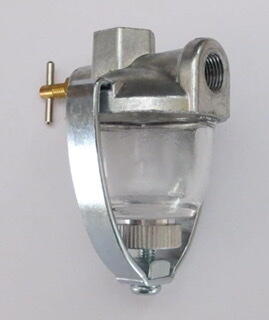

Pullstart 68,518 #6 Posted November 27, 2023 Call me old fashioned, but I’ve never had a filter issue with one of these… 3 1 Share this post Link to post Share on other sites
D_Mac 9,330 #7 Posted November 27, 2023 Leaking issue with those sediment bowls. I removed all mine. 1 Share this post Link to post Share on other sites
pfrederi 19,237 #8 Posted November 27, 2023 39 minutes ago, Pullstart said: Call me old fashioned, but I’ve never had a filter issue with one of these… They are not as easy to use. Bowl gaskets can harden and make sealing difficult. The packing on the shut offs seems to need periodic tightening and you still have to clean the fine screening. Have them on my big tractors that is enough work none on the WHs 2 Share this post Link to post Share on other sites

JoeM 9,302 #11 Posted November 27, 2023 those raiders look like the ticket 2 Share this post Link to post Share on other sites
ebinmaine 75,688 #12 Posted November 27, 2023 1 minute ago, JoeM said: those raiders look like the ticket What's with the low reviews? 1 Share this post Link to post Share on other sites
Horse Newbie 7,398 #13 Posted November 27, 2023 5 hours ago, Pullstart said: Call me old fashioned Old fashioned… 4 Share this post Link to post Share on other sites
JoeM 9,302 #14 Posted November 27, 2023 2 hours ago, ebinmaine said: What's with the low reviews? I see they say the hose size is larger than advertised . There was only 5 reviews tho. 2 Share this post Link to post Share on other sites
ebinmaine 75,688 #15 Posted November 27, 2023 6 minutes ago, JoeM said: I see they say the hose size is larger than advertised . There was only 5 reviews tho. I've seen that happen too. Likely a metric piece sold as the incorrect American measure equivalent. 1 Share this post Link to post Share on other sites

Achto 30,166 #17 Posted November 27, 2023 (edited) 44 minutes ago, JoeM said: I see they say the hose size is larger than advertised I would have to agree with this. They say 3/16" to 1/4" fuel line. It would be more correct to say 1/4" to 5/16" fuel line. A 1/4" fuel line still fits on them with a little extra effort. One other plus to these screen type filters is that you can back flush them to clean them out if need be. Edited November 27, 2023 by Achto 4 Share this post Link to post Share on other sites

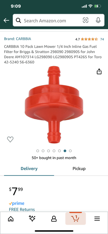

Wheelhorse#1 1,889 #22 Posted December 13, 2023 Been using these for a wile now.150 micron supposedly. Cheap & No issues 1 Share this post Link to post Share on other sites
RED-Z06 2,690 #23 Posted December 13, 2023 1 hour ago, Wheelhorse#1 said: Been using these for a wile now.150 micron supposedly. Cheap & No issues These are good at stopping the big stuff, same basic mesh as the old glass bowl filters, and the filters on the in-tank pickups on 300/400/500 series. 2 Share this post Link to post Share on other sites
