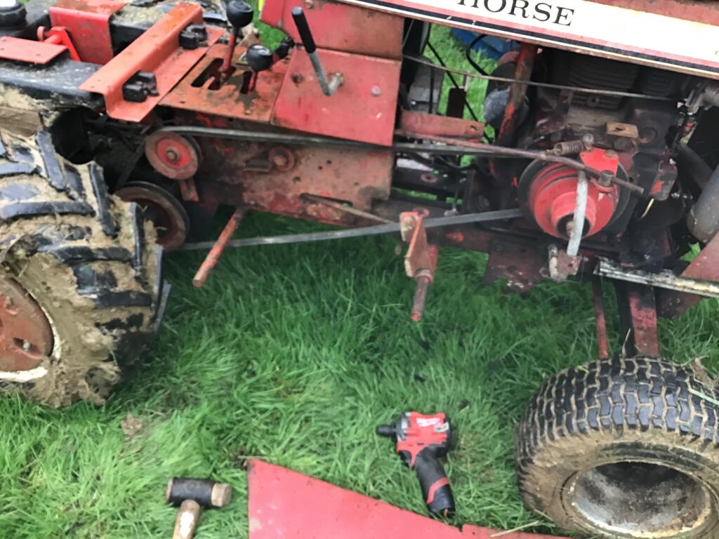

Geoff Cornwall 75 #1 Posted November 26, 2023 Ive been having a problem with the drive belt slipping on my wheel horse , i have taken the belt off and measured the outside and it 82 inches long . Ive have read some posts trying to find out if this is the correct length but from what i can tell it should be 84 inches long , my confusion is that the belt seems way to long already . Now its off i intend to replace it. , but im thinking that if the correct belt is 84 inches then that is never going to fit . The kohler engine is still on the rubber mounted shaker plate , the tensioning spring on the clutch arm dosent seem to be the right one , the small arm it attaches to is almost in a horizontal position pointing to the rear when tensioning the belt , the idler pulley would still need to go at least an inch or more backwards . Any help or suggestions appreciated , i have confused myself looking up part numbers , and am at a bit of a loss now ! Thanks in advance , Geoff . Share this post Link to post Share on other sites

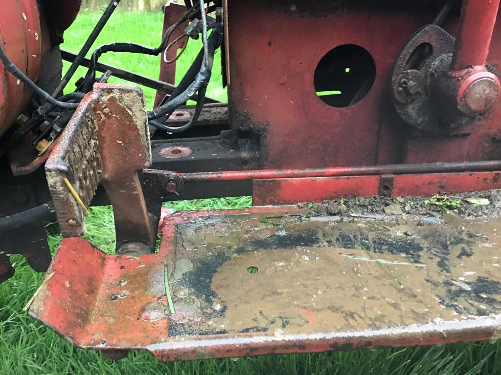

ebinmaine 75,747 #2 Posted November 26, 2023 Geoff, as you've likely already figured out you may have multiple issues there. The belt should be a Wheelhorse or Toro number 7473. That's 5/8" or B belt 81.9 inches long. I've found that being just UNDER 82" can be a necessity. Several folks on the site have had reasonable luck with aftermarket belts. I personally no longer use anything but OE on the C Series with an 8 speed. The clutch spring certainly could be an issue. Your engine rubber mounts are likely a big percentage of the problem. If those are bad the entire drive line can be tossed outta kilter. 3 Share this post Link to post Share on other sites
Geoff Cornwall 75 #3 Posted November 26, 2023 Thanks for the reply Eric , the rubber mounts are definitely on the soft side , no doubt perished due to age. If i can find a genuine belt here that is the way i will go , im sure i can locate a better spring somewhere . I was pulling logs out of the woods here yesterday and gradually lost drive to the point the empty trailer was too much for it ! 1 Share this post Link to post Share on other sites
ebinmaine 75,747 #4 Posted November 26, 2023 Those spacers may be able to be hand made. Search the site a bit. I've seen mention of it. That should be your first move I think. Can you get a closer pic of the belt? Share this post Link to post Share on other sites

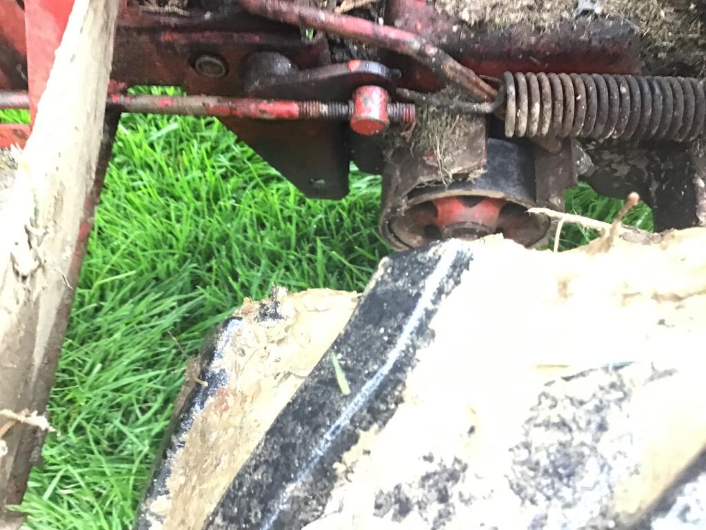

peter lena 9,556 #5 Posted November 26, 2023 @Geoff Cornwall welcome ! agree with @ebinmaine on your issues , would also probably replace the V BELT IDLER PULLEY , known for binding / rough , movement , that effects the belt engagement . also noting the lack of any lubrication on any ends. movement areas , aerosol penetrant , first to make the rust run out , then red aerosol grease , small tube extension , for tight spots . those engine mounts , will definitely prevent the transfer of power , as said you have multiple issues going on , definitely , not a simple fix . that spring pull , is also probably , much less than it should be do to rust , and frozen related linkage . also get after that manual lift lever , linkage , penetrant , red grease . you could also add a few washers to any sloppy end connection point , firming them up , along with smooth easy function , is what you want , https://www.google.com/search?q=wheel+horse+engine+mounts&rlz=1C1CHBF_enUS866US866&oq=wheel+horse+engine+mounts&gs_lcrp=EgZjaHJvbWUyBggA reference point on the mounts , a trans oil drain , refill , shift boot , would also help , keep in touch , pete Share this post Link to post Share on other sites

JoeM 9,317 #8 Posted November 26, 2023 3 hours ago, Geoff Cornwall said: The kohler engine is still on the rubber mounted shaker plate might want to think about putting some wood wedged in the shaker plate gap. Just to see if that improve things with your belt tension. That gap is should be 1/2 inch front and back. Share this post Link to post Share on other sites
