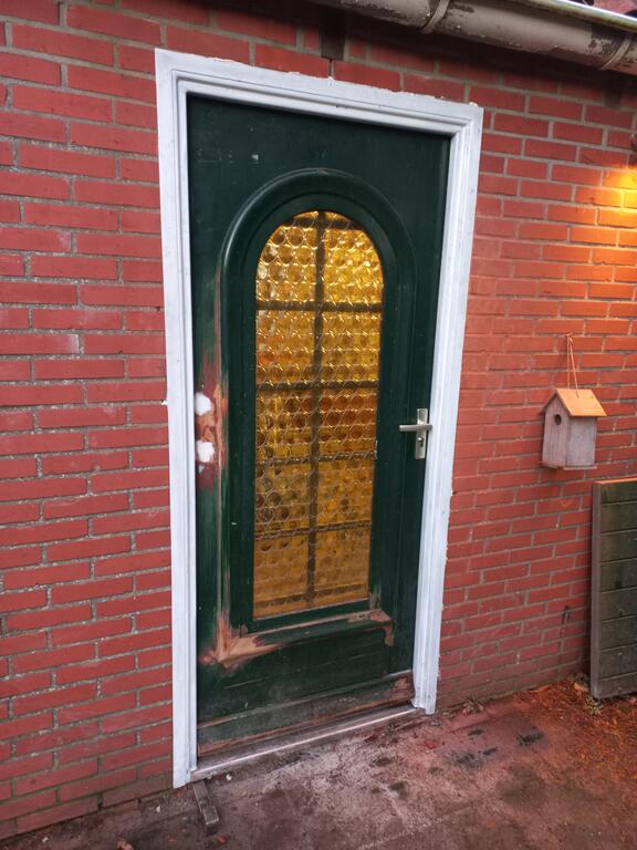

Door frame looks great - not a fan of full size glass for security reasons. (Unless that frame behind it it steel flat stock)

On that door I really like the "use what ya have!"
Will you be (re)-finishing that?
If that bottom piece is removable that should be done.
Repaint and reinstall.

Thanks! That is exactly what that is.

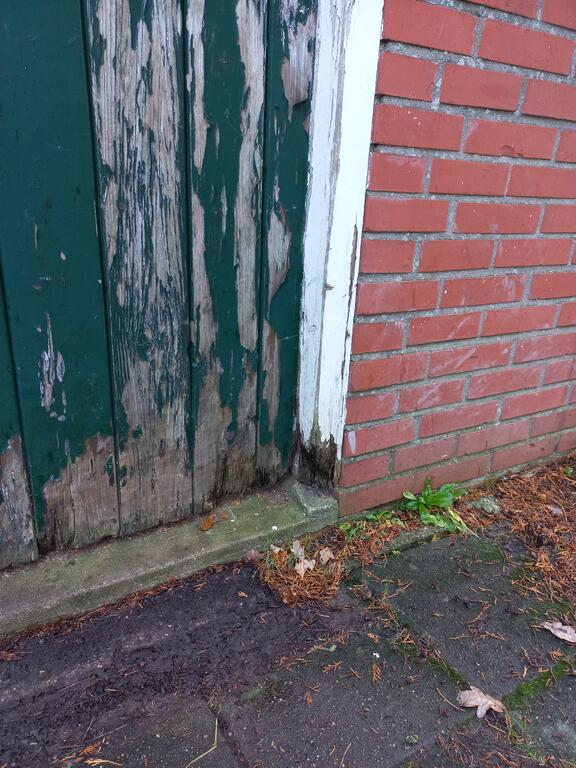

Door and frame will be repainted. The door had some spots where the paint was coming off so I sanded those parts down to check if the wood was still good in those areas.
I'm not 100% sure what you mean with the bottom piece? You mean the door or the doorframe?
I removed the old concrete sill/doorstep since the stainless doorframe has a built in doorstep.

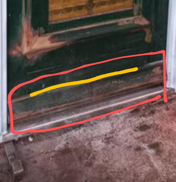

The door itself.
On SOME doors the lower flange (circled in red) is removable at the yellow line.
Yours may or may not be.
If it is you should pop that off and refinish, then reinstall.
If not, just scratch around the edges a little (carefully) to be sure it's attached well protected by paint and/or sealed up right.

sjoemie himself
Aha! Thanks I did'nt know that. I'll check that when I get to painting the door which might be a while since the weather is pretty sad at the moment.

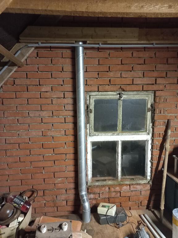

I did however start working on something I wanted to install for a long time which is a dust/fume extraction system. With all the welding, grinding and cutting going on it's sometimes not a very healthy environment despite using respiratory filters etc.
The system will have one central suction fan and 3 extraction points each with a valve.
One valve/hole will go above my welding area, one above my plasma cutter and a small one will get connected to a dust seperator on my blasting cabinet.

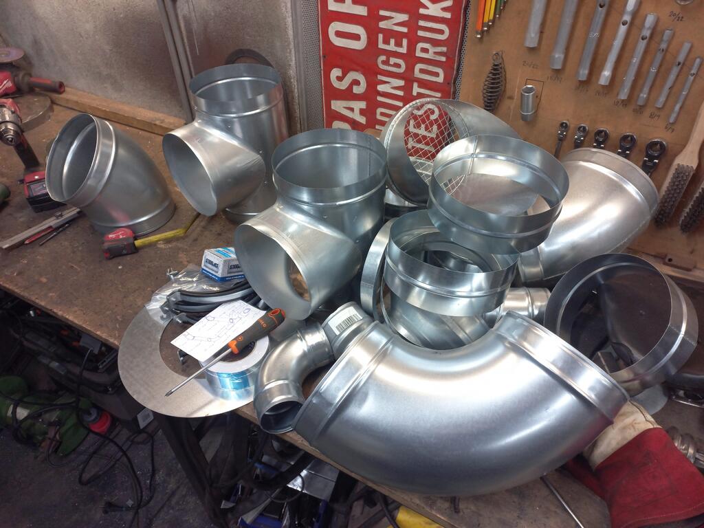

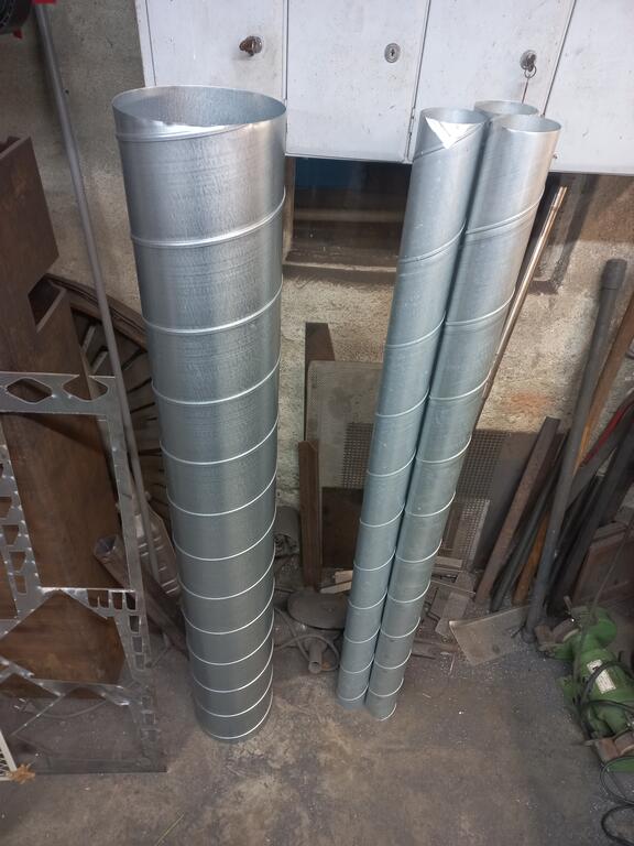

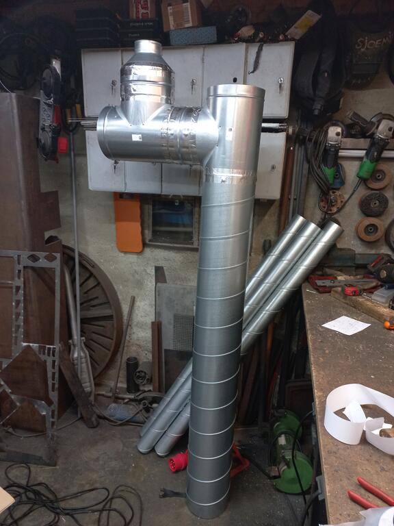

Christmas came early! A whole bunch of parts arrived last week.

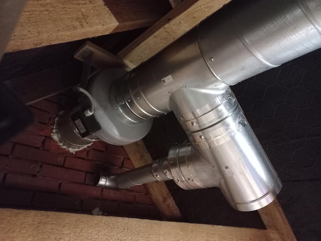

I pre-fabbed the two big extraction points consisting of a 45° bend, a ring, a valve and a shroud(?) I think it's called. Cut holes in the ceiling and mounted the parts. That's a 200mm (~8") opening by the way.
It was a busy weekend so I did'nt have too much time in the workshop but I did manage to prefab some more pieces.
This is the main section that will attach to the fan and where all the extraction points will connect to. Again, main section is 200mm/8" and the small end is 80mm/~3" which will go to the blasting cabinet (pictured below).

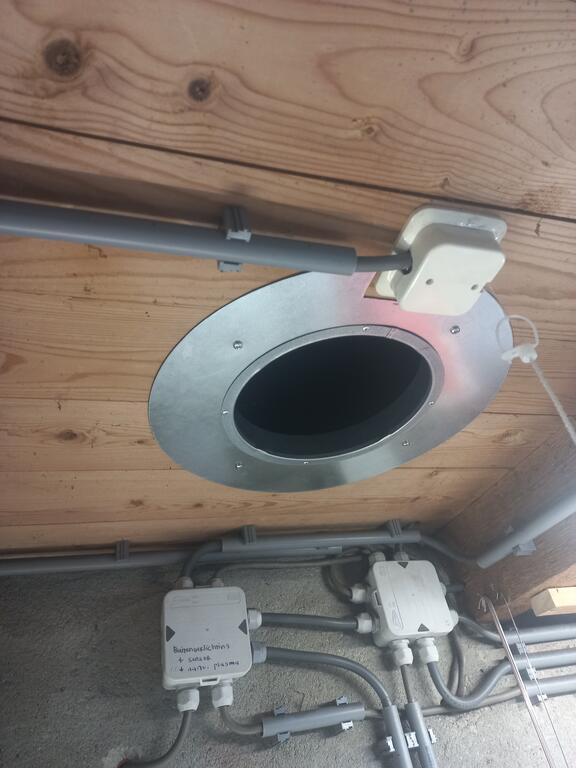

Lots of other things had to be done but some time was found to work on the dust extraction again.

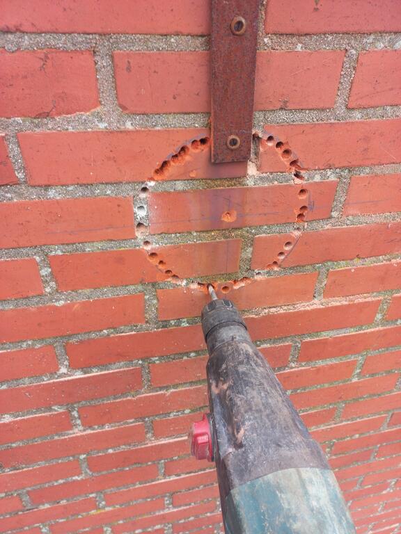

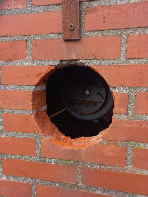

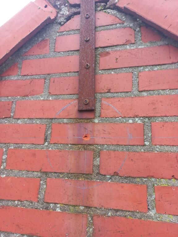

Making a 200mm hole without a holesaw was not a fun job. Plumbing the rest was though.
Center marked near the top of my garage/workshop.
Lots of drilling.

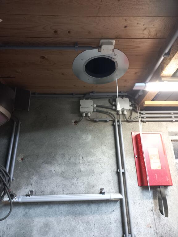

We have a breakthrough. Nicely lined up with the fan.

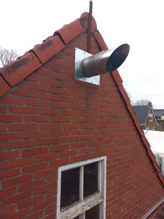

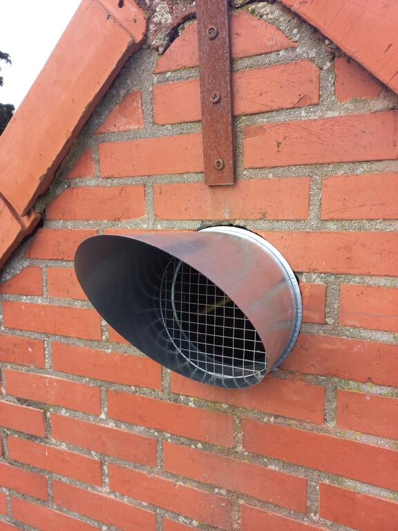

Exhaust weather cap installed.
Fitted with a nice coverplate.

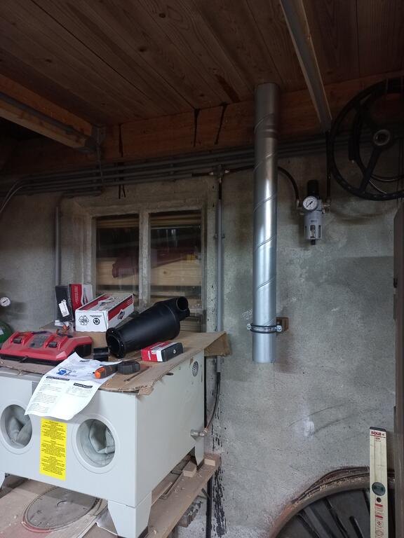

Tubing from the blasting cabinet making it's way up.

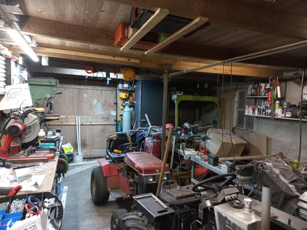

And the main collection tube hung in place.
The fan flows 930m3/hour or 547cfm. Should be enough.. I think..?? We'll see.
