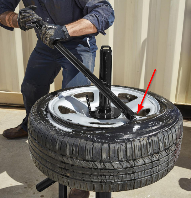

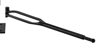

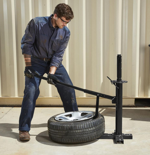

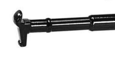

davem1111 2,091 #14 Posted November 25, 2023 9 hours ago, davem1111 said: [regarding HF (Pittsburgh) tire changer]: A while back I got the larger model second hand but looks like it was never used, for $20. Haven't tried it yet, not even sure if all the parts are there. But i's much sturdier. I woke up early and was thinking about this so I looked at HF, and this looks like the bigger tire changer I have. Unfortunately, I'm missing the lever bar the guy in this picture is holding, so I'm probably going to have to make one. I think any piece of pipe will work for breaking the bead, as shown in this picture: However, for actually getting the tire bead up over the rim, the bar has a (not sure what to call it) bit on the end that you slip under the bead and spin around. I think I'll need to weld a piece of metal on the end, grind and polish it smoothly. Or buy such a tool. BTW, this tire changer is on sale for $59 right now ($70 off!). I think that's less than I paid for the cheap useless one - maybe I should just buy another one of these. Or maybe I can use the tool that came with the cheap one - it looks like this and seems to be strong enough: When I have actually been successful at breaking a bead, getting a tire off, I've either used Silicone spray or liquid, or soapy water to make it more slippery. But that stuff won't seep into an old, well-sealed bead. In my experience, nothing but brute force will get them started. This has been such a frustrating process that paying $10 per tire to have the pros do it is pretty easy to swallow. 3 Share this post Link to post Share on other sites

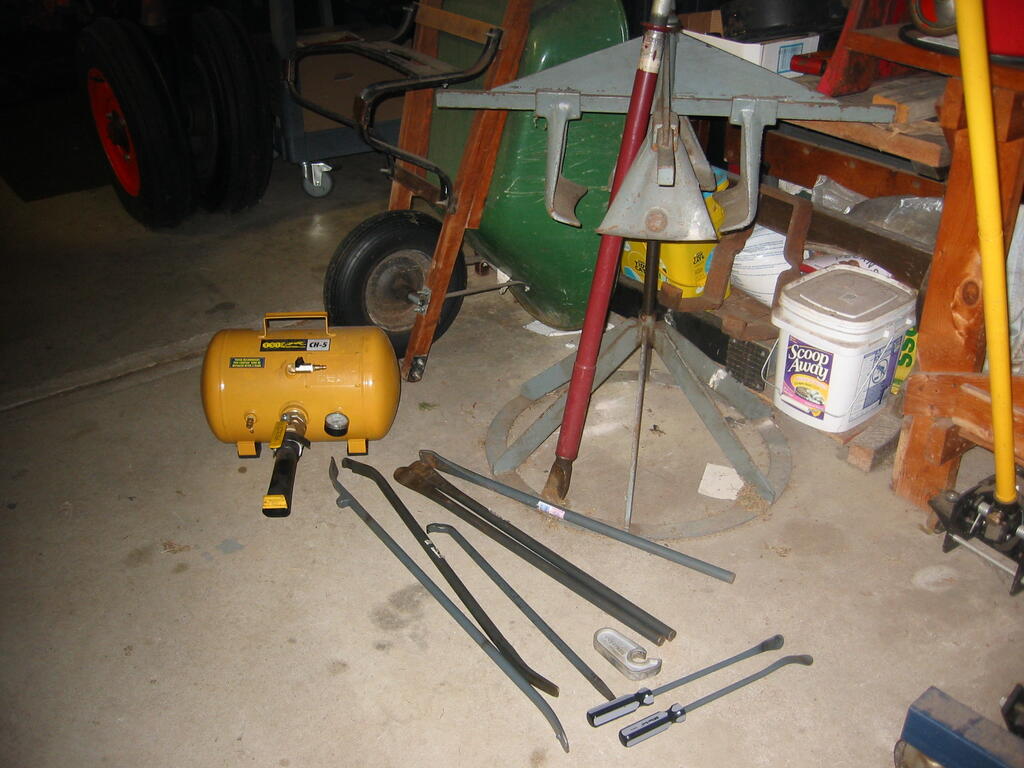

pfrederi 18,324 #19 Posted November 25, 2023 When you have well over 100 tires on WHs other tractors, trailers and stuff and the nearest tire repair is miles away you gather the stuff to do it . I have the large and small Harbor Freight tire machines. The red slide hammer is the cats meow for breaking beads...The big gray device is the ultimate bead breaker but is unwieldy to use. 2 1 1 Share this post Link to post Share on other sites

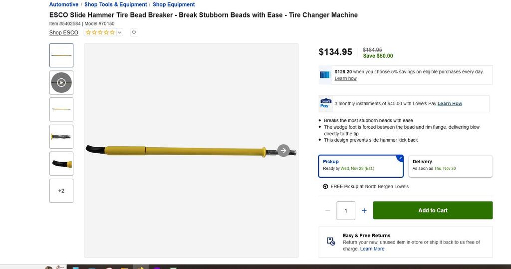

wallfish 17,485 #22 Posted November 26, 2023 20 hours ago, pfrederi said: The red slide hammer is the cats meow for breaking beads.. I like that thing !!!!! never saw one before 1 Share this post Link to post Share on other sites
pfrederi 18,324 #23 Posted November 26, 2023 1 hour ago, wallfish said: I like that thing !!!!! never saw one before I got mine from Norther tool several years ago. They do not have it anymore. Like every thing they are more expensive now think I paid just under 100 1 Share this post Link to post Share on other sites
wallfish 17,485 #24 Posted November 26, 2023 (edited) 2 hours ago, pfrederi said: I got mine from Norther tool several years ago. They do not have it anymore. Like every thing they are more expensive now think I paid just under 100 See some online for like $50 ish. I don't need a super beefy tool for the amount of times it would be used but it seems like a good tool for the amount of times I do tries. https://www.amazon.com/BLACKHORSE-RACING-Breaker-Trailer-Portable-Changing/dp/B07W8SLN9W/ref=asc_df_B07W8SLN9W&mcid=bd4f536d6b2a344fad8d719ff2d88d06?tag=bingshoppinga-20&linkCode=df0&hvadid=79852147254036&hvnetw=o&hvqmt=e&hvbmt=be&hvdev=c&hvlocint=&hvlocphy=&hvtargid=pla-4583451675734505&th=1 Here's another even less https://www.vevor.com/hydraulic-bead-breaker-c_10298/vevor-tire-slide-hammer-bead-breaker-heavy-duty-ram-bar-for-car-truck-trailer-p_010894841021?adp=gmc&utm_source=bing&utm_medium=cpc&utm_source=bing&utm_medium=cpc&utm_id=441084242&utm_campaign=PLA-PC高-US-Automotive-GMC-ECPC-20220729-0928改结构&msclkid=edac488668c312ff689f2de50bf35efd&utm_term=4587574836953041&utm_content=all Edited November 26, 2023 by wallfish 1 Share this post Link to post Share on other sites
