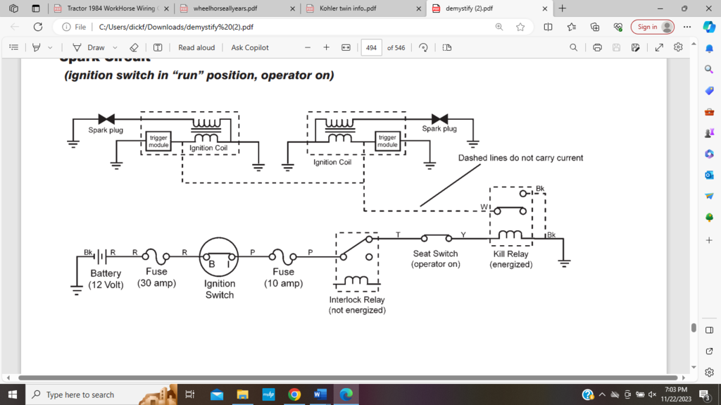

Bob a question, is the seat switch disabled. With the seat switch in the circuit it will start and shut off when the brake is disengaged if the seat switch is faulty
look at the center of the drawing the switches feed the k1 kill relay.

I do not own this model Wheel Horse but I know there is a "NO MOW IN REVERSE" switch that will shut the tractor down if the PTO is on and the no mow isn't overridden it will energise the "Interlock Relay" activating the KILL RELAY. Not sure that is the problem but it is worth taking a look. Hope this helps.1838106796_Screenshot(169).png.babfc5801c333017285d0c1e14d53e8b.png

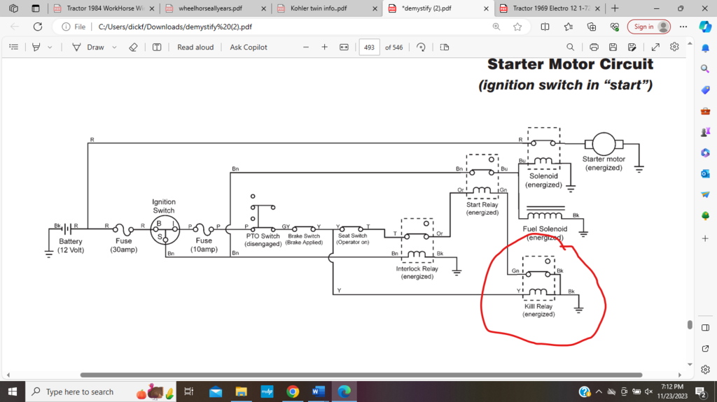

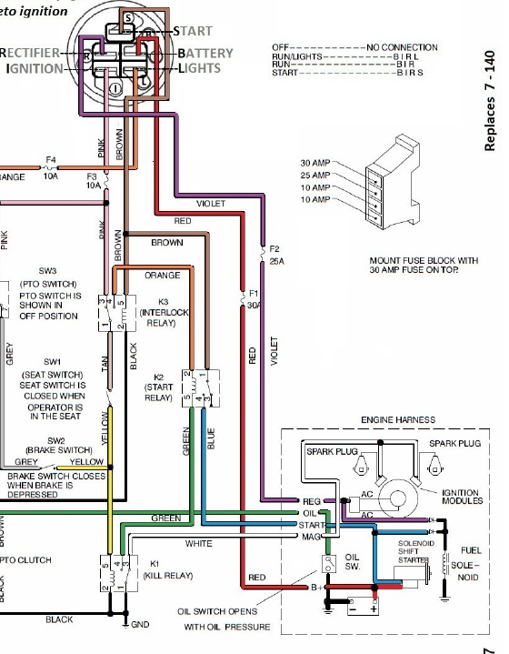

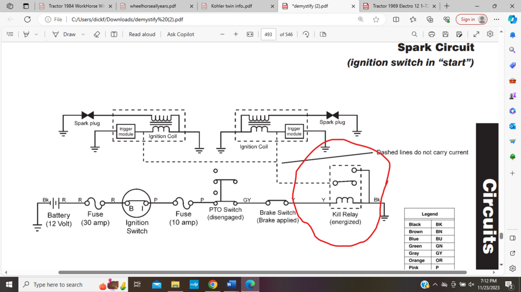

  1. The seat switch has been bypassed and that appears to be working as I can start the tractor without being in the seat.  When you say it has been bypassed do you mean it has the two wires shorted together or has it been unplugged meaning the two wires are not connected to anything? I hate to see people bypass safety switches but if the seat switch is disconnected and the two wires going back to the harness aren't connected it is as if the driver is not in the seat on this model according to the diagrams.
  2. Releasing the parking brake causes the motor to shut off.Taking a second look at the wiring diagrams I see that there are some discrepancies in the KILL RELAY from one drawing to the other. Perhaps @gwest_ca can help us sort this out. I don't own this model so I can't confirm which one is correct. One shows the upper terminal of the kill relay going to ground and the other shows the lower wire going to ground.   :confusion-shrug:
  3. With the parking brake on, engaging the PTO also causes the motor to shut off  If your neighbor can take a look at the KILL RELAY wiring and let us know what the actual wiring is we probably can get you going.

The purpose of the Kill Relay is to ground out the Magneto if the key is turned off or there is no operator in the seat with the PTO switch ON or the brakes not engaged when the operator exits the seat. The brake switch and seat switch are in parallel with each other. If power is applied to the yellow wire on the relay it should activate it and remove the ground from the magneto white wire. Be sure no battery power ever goes to the white wire or it will burn up the magneto.
Remove the battery and inspect all of the wires to and from the PTO switch, brake switch and seat switch. Seems like there could be a wire disconnected
The Kill Relay should have a Green wire going to the Start relay;  a White wire going to the Magneto; a Yellow wire going to the seat switch and brake switch and two black wires that go to ground.
