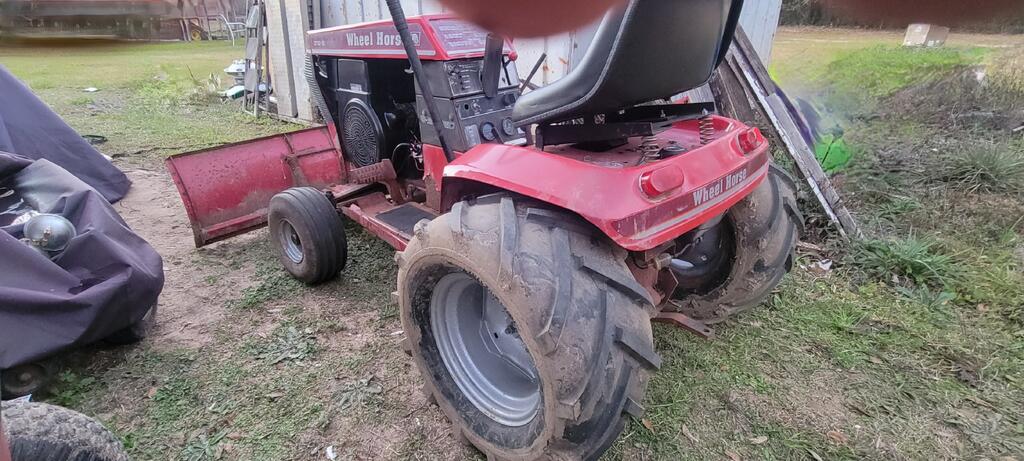

RED-Z06 2,479 #1 Posted November 18, 2023 The backstory. 312-8 had been sitting in a swampy field about 16 years, guy told me i could have the 48" blade if i took the tractor. I got it running after unseizing it, ran good but ran too fast, no governor response. Broke it down and the governor had lost a flyweight. I bare blocked it, new rings, honed the pitted cylinder, hot tanked the block and replaced the governor gear. Back together it ran great, good governor response..but it started smoking and rattling. I tore it back apart..rings were toasted...likely missed some grit from honing. But, i couldn't find the source of the rattling..the crank mic'd out well within spec, rod was in spec, bore was almost new size, piston looked fine but looser side of spec at the skirt. I replaced the rod, piston, rings...and immediately on start up..it rattled. But, only under load. Since then ive put over 100hrs on it pushing asphalt miings and dirt..and its been great, oil never has any metal in it, never uses any oil. But today, the noise its made, got abruptly worse. My guess is, balance gears...i still feel like if it was a rod it would have chucked it by now, or gradually gotten worse, not been consistently the same then suddenly worse. Its getting cooler here, only into the low 80s today🫠 https://youtu.be/tuv_uOhyynY?si=-uZiWt65PaLk28cH 2 1 Share this post Link to post Share on other sites

RED-Z06 2,479 #12 Posted November 19, 2023 15 minutes and the engine is out, sump off...no felt rod play, but i found the balance gears are going, and despite the set screws being tight..the drive pulley is loose. It still made the rattle with the pulley removed last time..its possible the sudden increase was the pulley this time. Regardless...the gears are getting evicted https://youtube.com/shorts/zXl9iNDh9QM?si=HpfmBE8RNwTUzLeM 3 Share this post Link to post Share on other sites
RED-Z06 2,479 #13 Posted November 19, 2023 Balance gears are gone...fishing out the bits, then back together. 3 Share this post Link to post Share on other sites

RED-Z06 2,479 #16 Posted November 19, 2023 New key in the crank and cranked the screws down...good and snug. The cam gear slop has me concerned, that's a ton of lash. But its back together, backfired on first start and turned the rusty old muffler inside out. Runs good, still has a bit of noise..i did pull the rod cap and there was no scoring or signs of wear on the new rod. Not sure at this point, tractor is pretty much trash, both shifters are rotted away at the base, the diff oozes, its very rusty. Ill say this, the shaking is pretty uncomfortable, at idle its bad, at 3600 it makes all the sheetmetal buzzzz...mid range its not bad. 4 Share this post Link to post Share on other sites
