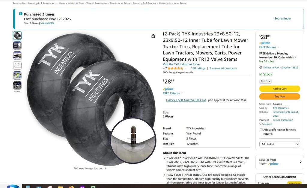

moe1965 752 #1 Posted November 17, 2023 (edited) Here is my dilemma I bought a wheel horse tractor that sat out side covered up for who knows how long a im guessing 5 years PO passed away no info on it. Tractor runs great but the tires will not hold air for more than 4 days. Dry rotted and cracked only where it sat deflated for whenever whenever the tread is very good. Tubes are 25 ish ea and tires are way more than that. My issues is I don't like tubed tires because you can't plug them. Any thoughts on pros and cons of running tubes Edited November 17, 2023 by moe1965 Picture Share this post Link to post Share on other sites
