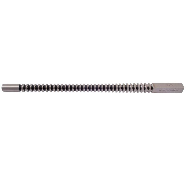

lynnmor 7,537 #7 Posted November 15, 2023 Buy a square broach, I didn't look up the size you need so I didn't include a source. Prices will be all over the map. 2 Share this post Link to post Share on other sites
ri702bill 8,894 #8 Posted November 15, 2023 (edited) I have done this before using a new 3/8" HSS square lathe tool blank as a punch. Turned the last 1/4" down to just fit the tight fit clearance hole as a centering guide. The corners are left sharp. It is then setup in the 20 ton press and pushed thru. You STILL need to filed the square opened up a bit....... Edited November 16, 2023 by ri702bill 2 Share this post Link to post Share on other sites
ri702bill 8,894 #9 Posted November 15, 2023 5 minutes ago, lynnmor said: Buy a square broach, I didn't look up the size you need so I didn't include a source. Prices will be all over the map. These are not cheap and MUST be guided and used with a hydraulic press, just like a keyway broach. They do NOT tolerate impact - hitting it with a BFH will break it. 1 Share this post Link to post Share on other sites
