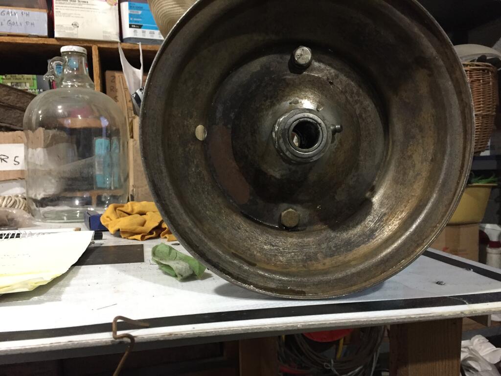

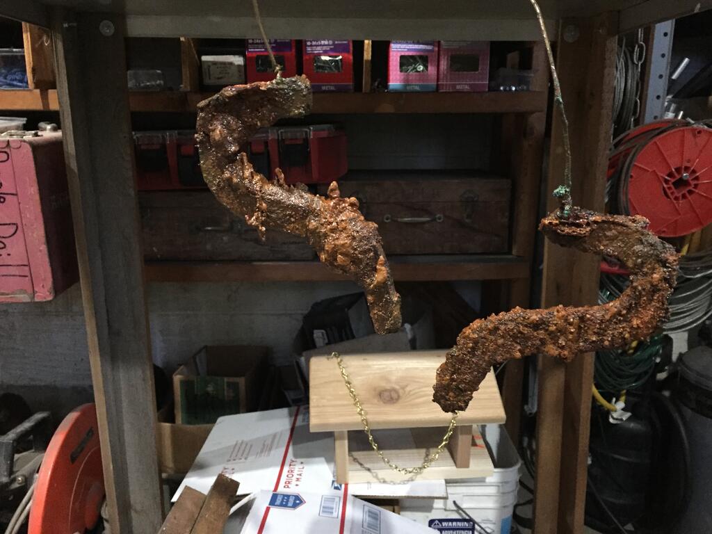

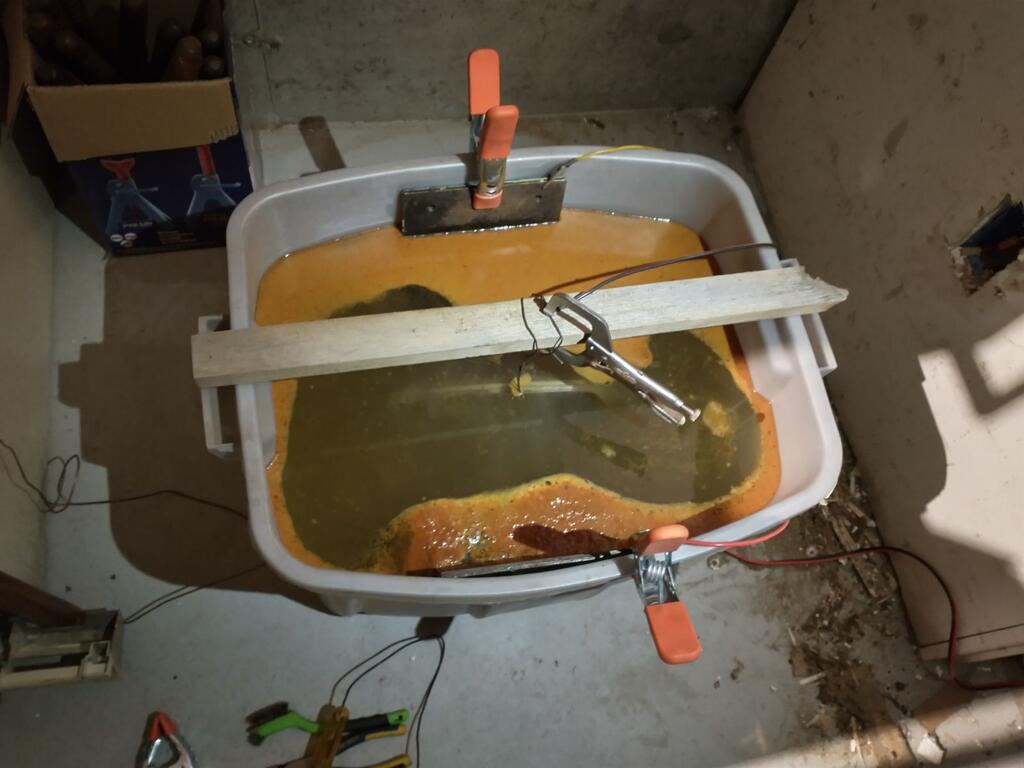

JimSraj 478 #1 Posted November 15, 2023 I’ve been using an e tank to clean up various metal parts for a while. Latest is wheels from a 1267 that were pretty nasty. What you’d expect from a set of rims over 50 years old. Check out the buildup on the anodes. The wheel has had some wire brushing (manual) after it came out of the tank where it ‘cooked’ for a few days. wish I had taken pictures before. 5 5 Share this post Link to post Share on other sites

Handy Don 13,306 #3 Posted November 15, 2023 15 hours ago, JimSraj said: I’ve been using an e tank to clean up various metal parts for a while. Grease and oil on the part will slow down the electrolysis by coating the anodes. I try to get that stuff off before dunking. Also, a quick wire brush on the anodes to remove all that crud rejuvenates them! 3 Share this post Link to post Share on other sites

JimSraj 478 #5 Posted November 15, 2023 The anode pictures were from the second wheel first trip thru the tank. I had cleaned them up once after the first wheel was done. The crude comes right off and yes, it definitively rejuvenates the process. I’m on the look out for a more powerful charger to speed it up though. Tough to find manual chargers anymore. 3 Share this post Link to post Share on other sites

oliver2-44 10,293 #7 Posted November 16, 2023 11 hours ago, Handy Don said: Grease and oil on the part will slow down the electrolysis by coating the anodes. I try to get that stuff off before dunking. Also, a quick wire brush on the anodes to remove all that crud rejuvenates them! I use swimming pool Ph+ and it seems “soapier”. I do a general scrape of of the heavy stuff. I also use a 10am 24v power supply that really helps it cook. It rarely draws over 5 amps. As others, I wire brush the anodes as needed. 3 Share this post Link to post Share on other sites

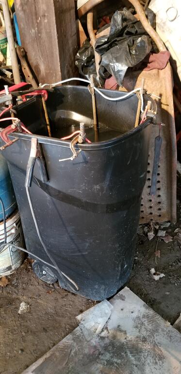

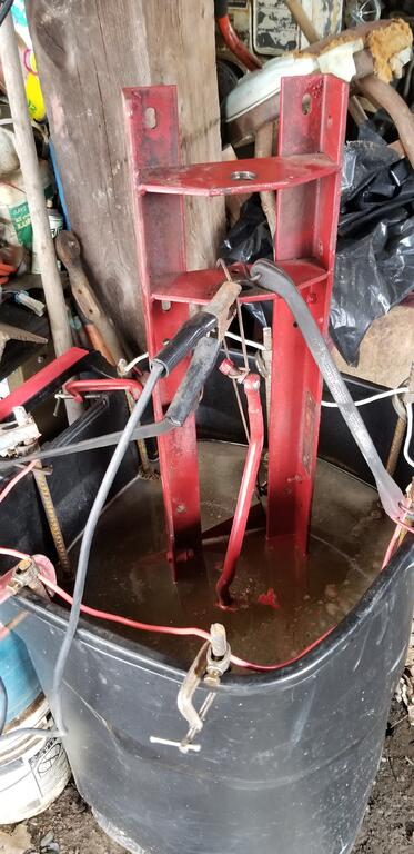

gt14rider 830 #8 Posted November 16, 2023 Had this for my frame and bigger parts, worked good, used rebar for anode. 2 Share this post Link to post Share on other sites
ebinmaine 70,472 #9 Posted November 16, 2023 4 minutes ago, gt14rider said: Had this for my frame and bigger parts, worked good, used rebar for anode. NIIIIICE Share this post Link to post Share on other sites
