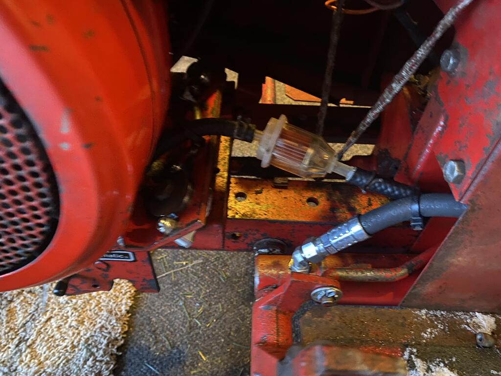

oliver2-44 11,062 #3 Posted November 14, 2023 Pull the fender pan and you should be able to see most a lot of the hydraulics. If needed pull the right rear wheel and right running board and you really have it all exposed. Give it a good cleaning, top and bottom. Then look where the fresh oil is coming from. While the fender is off its a great opportunity to pull the center top tunnel cover and give the motion control a good cleaning As Eric posted, Wheel Horse parts and more has hoses, gaskets, seals, O-rings, cylinder and valve rebuilds. 1 3 Share this post Link to post Share on other sites

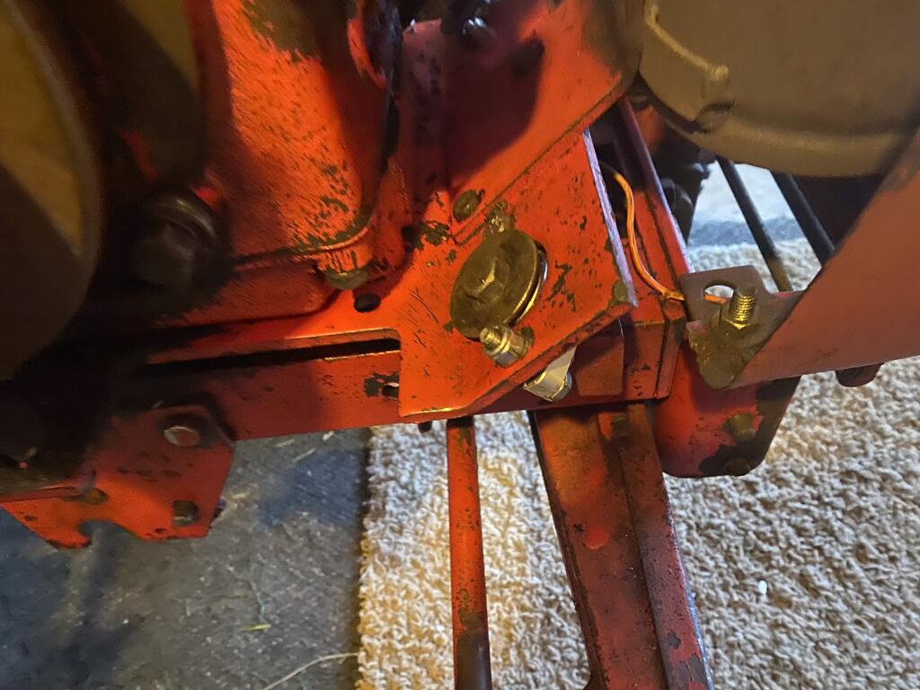

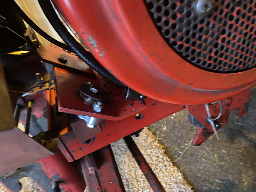

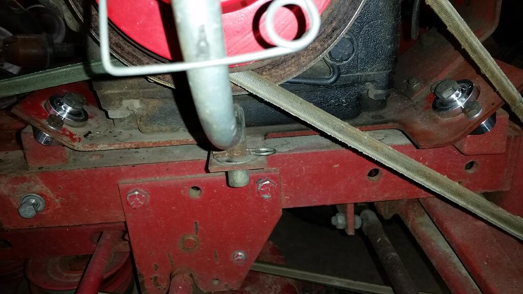

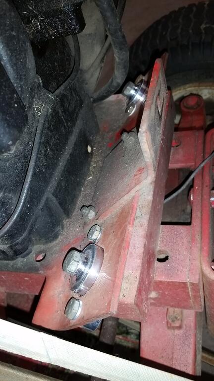

WHX?? 53,346 #7 Posted January 6, 2024 (edited) 6 hours ago, Jim Leh said: Got back 2 in bit front 2 don’t seem to line up. How far off are they Jim? Leave all bolts loose. Until you get them all in. Loosening up the shaker plate blocks may give a little wiggle room. Make sure drive or PTO belts aren't pulling the motor off. Just guessing these are Zack Kerber solids like these? Edited January 6, 2024 by WHX?? 3 Share this post Link to post Share on other sites
Jim Leh 7 #8 Posted January 6, 2024 About 1/4 inch Yes Zack Kerber. From wheel horse parts and more thanks for reply. Jim 1 Share this post Link to post Share on other sites
WHX?? 53,346 #9 Posted January 6, 2024 57 minutes ago, Jim Leh said: thanks for reply. No problem Jim. If they are Kerbers they should fit right in. Sounds like things might have shifted around abit but shouldn't be an issue to get that gap out. Loosen those bolts on the bottom side of the triangle blocks to get that wiggle room. I had best luck leaving everything way loose. Pry up on the front of the motor just enough to get them in. Clean threads helps. I might have done the fronts first but CRS but I do know there was no major issues. Keep us posted. 1 Share this post Link to post Share on other sites
