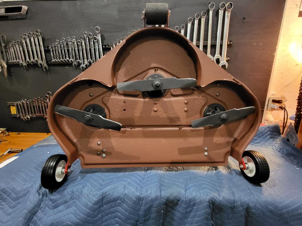

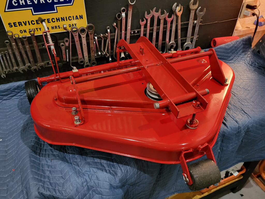

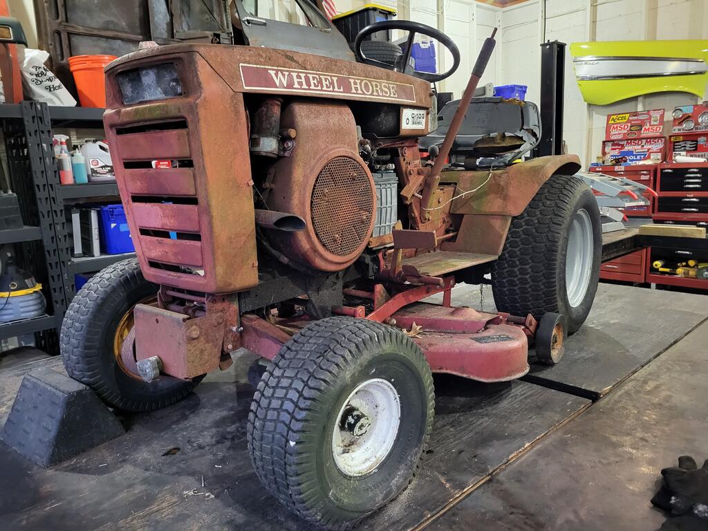

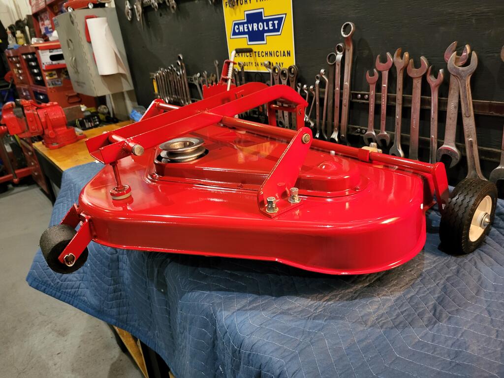

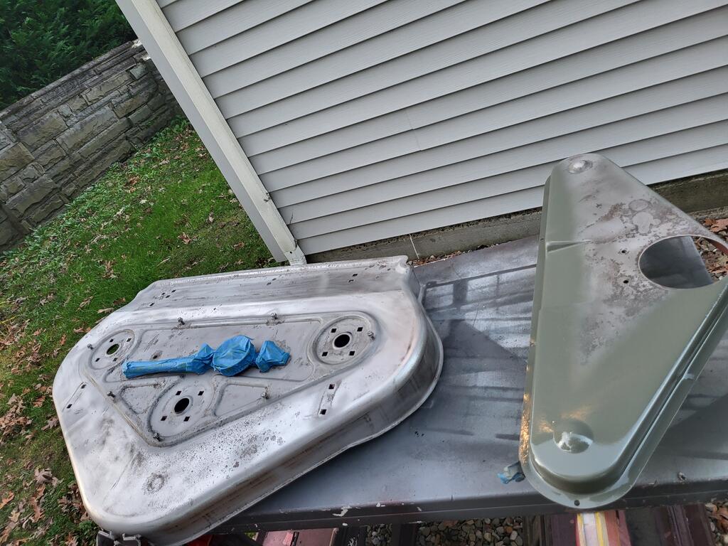

matt monte 132 #1 Posted November 13, 2023 Figured id share some pics of the deck to my B80 that i freshened up last week. I finally perfected a media blaster i sorta made and was dying to test it out. Stripped deck and blasted it with fine coal slag from TSC. Shot deck in some summit epoxy then mixed up some red. Bought a gallon of that majic oil base enamel. Ehh paint is hit&miss. shot a hood over the summer came out lousy, lotta orange peel, however the deck came out decent. By no means show quality more of a "driver condition". Any car guys will understand. I did that rustoleum rusty metal primer on backside because well for obvious reasons. Again wouldnt enter it in a show but considering this tractor was saved from going to the scrapper, not to bad. I scored a second B80 that i stripped down and was gonna start resto for my winter project however Today i scored a C100 on MP for $50 complete. Has not ran in years however deck is rust free. My question is this. Does it pay to strip this one down and do this one since it apparently has a larger wheelbase. does it pay to now spend a week or so stripping this one?????it appears beefier with a better trans and a headlight? Torn on what to do, ill let the forum decide! 4 Share this post Link to post Share on other sites
Moparfanforever 831 #2 Posted November 13, 2023 Looks really sharp!! That deck has the older style attach mounts on it, won't work on your B80 with the new style attach a matic. Did you do other parts swapping to make it work?? Share this post Link to post Share on other sites

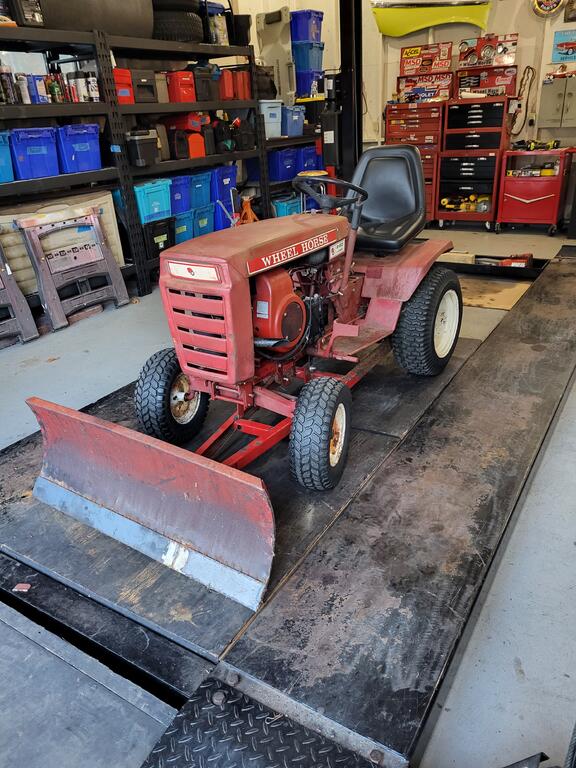

matt monte 132 #3 Posted November 13, 2023 So i only learned this recently. That was the deck that was on B80 when i got it so in some other lifetime PO put the older style mounting system i suppose. I wish i would of know this BEFORE i did deck over because everything i own is attach a matic. 308,312 and this c100. Oh man....just thought of something. I pulled this deck from this mule i plan on leaving alone, just mounted snowblade on it and was gonna use it as a backup. So........the B80 that i have blown out in a million pieces that i was gonna build is probably set up for attach o matic? Hahaha Share this post Link to post Share on other sites
matt monte 132 #4 Posted November 13, 2023 that deck up until 2 weeks ago was on my tenderfoot b80. Which is just a backup mower. Daily one is 312-8 with a larger 42 deck. Since im done mowing tomorrow i was gonna install the snowthrower attachment on while the weather is still mild 2 Share this post Link to post Share on other sites
oliver2-44 9,484 #5 Posted November 13, 2023 You should be able to take the attachamatic deck hardware off the new deck and bolt it on the deck you restored. I’ve read bolt right up, no hole drilling required. If I might recommend you ditch the Majic Oil Paint. It has a history of fading along with the poor finish problems you had. Use some Rustoleum with hardener or almost any other brand of oil base paint. 1 Share this post Link to post Share on other sites
ebinmaine 66,779 #6 Posted November 13, 2023 8 hours ago, matt monte said: My question is this. Does it pay to strip this one down and do this one since it apparently has a larger wheelbase. does it pay to now spend a week or so stripping this one?????it appears beefier with a better trans and a headlight? There's more than one train of thought here. 1. A B80 of 1974-1977 no matter the wheelbase is an excellent worker. The 74, 75 models were a bit shorter than the 76, 77 ones. The 8 speed/8 pinion in the 76, 77 models is certainly known to be a fantastic transmission. The 4 speed 4 pinion transmission in the early years is by no means "weak". Likely you'd never know the difference between the 4 speed and an 8 speed/8 pinion unless doing some serious ground engaging work or legitimately used the Low range often. I personally like Low for backing in right spaces because IMHO R/High is too fast. The Headlights are optional on B series. The differences in 76, 77 were that and the seats. Maybe tires? TBH I don't think being a B Series or a C Series should be the deciding factor. 1 Share this post Link to post Share on other sites

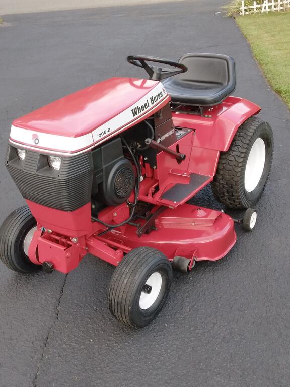

matt monte 132 #7 Posted November 14, 2023 Agreed. i already have a B80 blown out in 100 pieces in my WH shed. Ill get going on that. I built that 308 last year. Spent this year wrkg on my C10 pick up but usually do the tractors in the fall/winter. Ill ditch that ghetto majic paint as well. Can anyone recommend a single stage for red? I have had pretty decent success with summit racings "brand" of automotive primers/paints. Reasonably priced for the do it yourself hobbyist. Although that majic stuff wasnt exactly cheap. with activator 75-80 bucks for the gallon. I will say this, i called there customer service, wanted to know spray tip size,air pressure etc. I got a callback from there tech support who was quite knowledgeable. to bad the product is sub par 1 1 Share this post Link to post Share on other sites

matt monte 132 #11 Posted November 15, 2023 love the wheels. yeah paint came out nice. thank you for both paint recommendations.ill keep thread posted! Share this post Link to post Share on other sites
