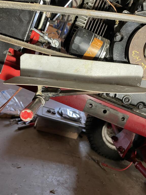

davem1111 2,073 #3 Posted November 14, 2023 8 hours ago, ebinmaine said: @davem1111 was also working on something. True. I'm basically throwing something together from scrap metal, a Hillman sleeve, some threaded rod and Heim joints I bought. I had it on a 417-H but moved to a 520-H with steering reduction, which restricted the movement of my mechanism a bit. I'm putting this tractor together from the frame up, so I have some more work to do before I can take it for a test drive (like putting a steering wheel and seat on it), but so far a quick garage test has it moving forward and backward. Will share some pictures soon. It's really not that hard to build one, if you don't care whether it looks like original equipment. 1 Share this post Link to post Share on other sites

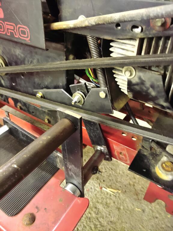

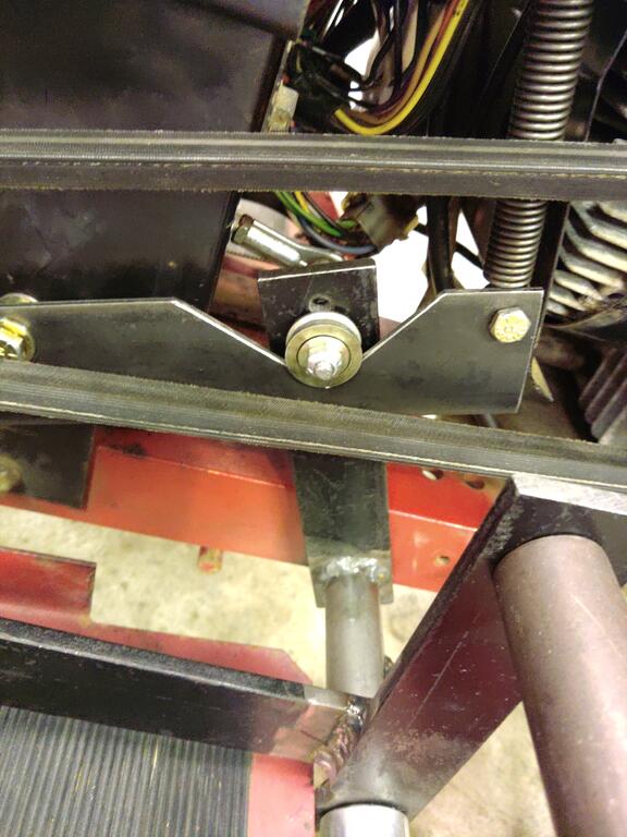

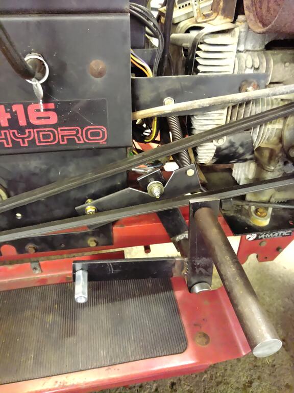

Bill D 2,050 #4 Posted November 14, 2023 Here's my take on the issue. 2 1 Share this post Link to post Share on other sites

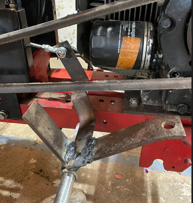

davem1111 2,073 #5 Posted November 14, 2023 I welded this bent piece of metal onto the Hillman sleeve, then bent another piece of metal to go up and over the frame, then up to where I could attach the Heim joint. This was on the 417 frame, had to change it a little when moved to the 520. Welded a flat foot pedal on top, will paint and put some non-skid material on it later. 1 Share this post Link to post Share on other sites
Rick3478 433 #6 Posted November 14, 2023 14 hours ago, Bill D said: Here's my take on the issue. Oh, you put the centering spring *there*. That's interesting. 1 Share this post Link to post Share on other sites
Rick3478 433 #7 Posted November 14, 2023 37 minutes ago, davem1111 said: I welded this bent piece of metal onto the Hillman sleeve, then bent another piece of metal to go up and over the frame, then up to where I could attach the Heim joint. This was on the 417 frame, had to change it a little when moved to the 520. Welded a flat foot pedal on top, will paint and put some non-skid material on it later. Are you gonna need to cut some of the floorpan away to clear the pedal? 1 Share this post Link to post Share on other sites
davem1111 2,073 #8 Posted November 14, 2023 1 hour ago, Rick3478 said: Are you gonna need to cut some of the floorpan away to clear the pedal? I don't think so, but if so it will be a very smalll amount. I have a spare set so I'm not worried about messing it up. 1 Share this post Link to post Share on other sites
Bill D 2,050 #9 Posted November 14, 2023 3 hours ago, Rick3478 said: I was going for a bolt on kit with no drilling required. This was an easy way to build a centering device with minimal disassembly of the tractor. Depending on the model this could be installed in less than an hour. 3 Share this post Link to post Share on other sites
Rick3478 433 #10 Posted November 14, 2023 1 hour ago, Bill D said: I was going for a bolt on kit with no drilling required. This was an easy way to build a centering device with minimal disassembly of the tractor. Depending on the model this could be installed in less than an hour. I like thinking outside the box. 1 Share this post Link to post Share on other sites

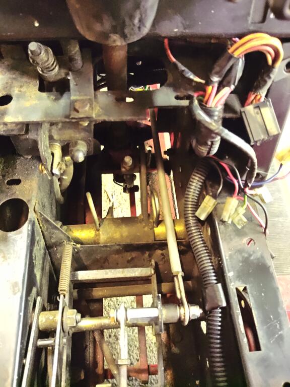

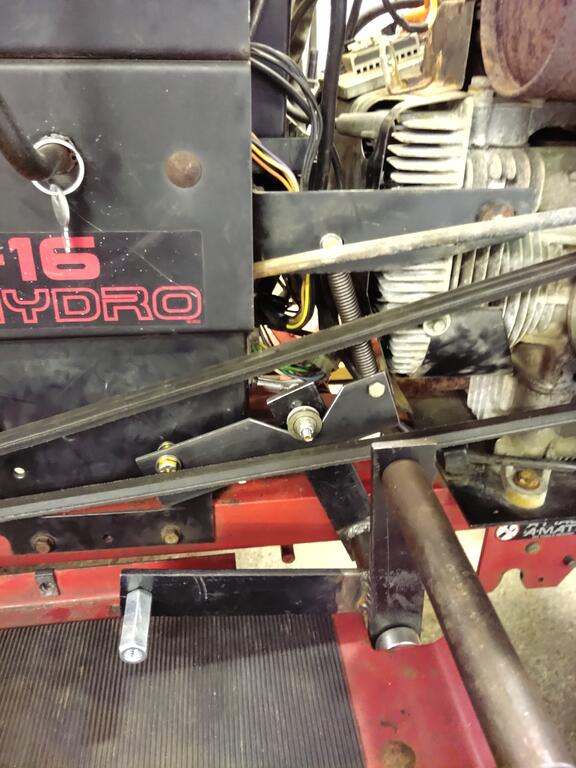

Handy Don 13,084 #11 Posted November 14, 2023 21 hours ago, Bill D said: Bill, do y9u have a picture with the re-cut spring-loaded return arm? Share this post Link to post Share on other sites
Bill D 2,050 #12 Posted November 15, 2023 4 hours ago, Handy Don said: Bill, do y9u have a picture with the re-cut spring-loaded return arm? I think this is it. 1 Share this post Link to post Share on other sites
Handy Don 13,084 #13 Posted November 15, 2023 Yep, Not too different to look at but a big difference in operation. Thanks! Share this post Link to post Share on other sites
