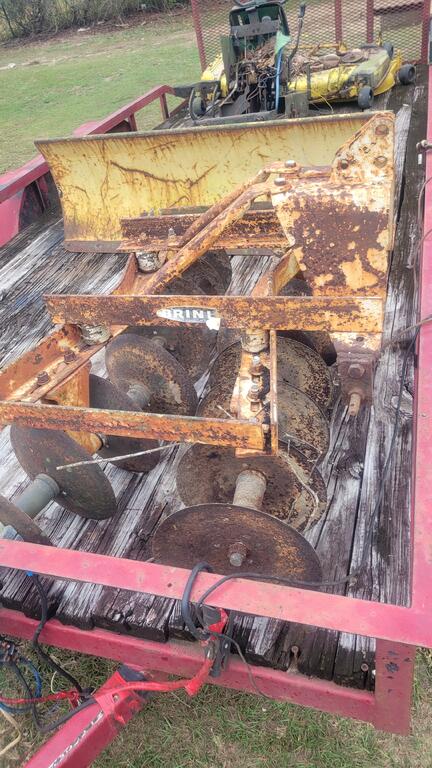

RED-Z06 2,479 #1 Posted November 11, 2023 I got one today, the plates are kinda loose on the shafts and the shafts wobble. Model DD-1000 1 Share this post Link to post Share on other sites
gwest_ca-(File Mod) 11,243 #2 Posted November 11, 2023 Tighten up the axle nuts enough to still allow them to rotate. May need a Nylok nut so they stay. 2 Share this post Link to post Share on other sites
RED-Z06 2,479 #3 Posted November 11, 2023 15 minutes ago, gwest_ca said: Tighten up the axle nuts enough to still allow them to rotate. May need a Nylok nut so they stay. I found a basic parts list and it looks pretty basic, I can see how loose bolts could let it all move. Be nice if that's all it is Share this post Link to post Share on other sites

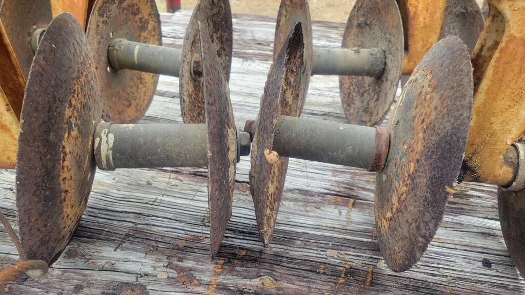

Skwerl58 750 #4 Posted November 11, 2023 I have a set with five disc on each side that I had to use pb blaster on to free up and then adjust with the nuts. I grease them every year and my set now does great. I believe they do better the more I use it. 1 Share this post Link to post Share on other sites

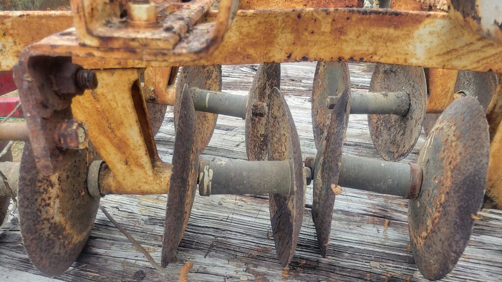

oliver2-44 10,370 #5 Posted November 12, 2023 The disc hanger brackets have a spacer/bushing/ bearing in them. The ends of these spacers can wear when everything is used loose. The spacers need to be longer that the tube part of the hanger they go through. This will allow you to tighten the long bolt through all the disc tightly, and not bind on the hanger. Share this post Link to post Share on other sites
RED-Z06 2,479 #6 Posted November 12, 2023 46 minutes ago, oliver2-44 said: The disc hanger brackets have a spacer/bushing/ bearing in them. The ends of these spacers can wear when everything is used loose. The spacers need to be longer that the tube part of the hanger they go through. This will allow you to tighten the long bolt through all the disc tightly, and not bind on the hanger. Finding that spacer/bushing may be difficult. I sent a message to Brinly, see if they respond Monday. If i can get it right ill replace some discs, have it all blasted and paint it up. Share this post Link to post Share on other sites
peter lena 9,088 #7 Posted November 12, 2023 @ RED-ZO6 , looks like it needs a complete refit , might consider saving the frame ( with inspection ) and replace rotating parts, you might luck out on parts , pete Share this post Link to post Share on other sites
RED-Z06 2,479 #8 Posted November 12, 2023 Got the impact out and started hitting bolts, found a few up top on the hangers, all 4 long bolts were loose...the threads are damaged so i couldn't snug them down..i added spacers and that let me get them tight. The disc play is gone, theres just a bit of thrust play and a bit of wobble. If i can find bushings and bolts it will be like new Share this post Link to post Share on other sites

RED-Z06 2,479 #12 Posted November 14, 2023 1 hour ago, peter lena said: @RED-Z06 https://ranchersupply.com/parts/disc-harrow-parts/ those rotational parts at best need a refit , you could make up a combined parts recovery , look up how its saposed to be / parts break down . only thing that will make that work is overpower gearing. have to get inventive , Pete Im going to pull one gang apart if the rain ever stops, and measure the disc holes, gang bolt, and bushing...see if I can't come up with something. 12" discs are more common..if they will clear, i can go that way. 1 Share this post Link to post Share on other sites
