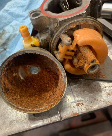

JoeM 7,883 #1 Posted November 10, 2023 (edited) A few years back someone gave me a newer TWH mower with a bad transmission. Removed a bunch of parts and the engine ran good and saved whole. I crimped the gas hose and ran it dry.....I thought. It had a newer carb with an anti back fire solenoid valve. Must have shut it off to soon. Turns out the bowl stayed full of gas. You know the good stuff with ethanol. The end result. I was able to save it with a good cleaning. Edited November 10, 2023 by JoeM 5 Share this post Link to post Share on other sites
ebinmaine 69,681 #2 Posted November 10, 2023 Yeeeeesh. I've seen a couple that were about that "nice". Good save. 2 Share this post Link to post Share on other sites
Tuneup 1,433 #3 Posted November 10, 2023 It's that new government mandated granular gasoline. Runs great! Yes, nice save. Pays nowadays to retain whatever original parts that you can. 2 1 Share this post Link to post Share on other sites
lynnmor 7,471 #4 Posted November 10, 2023 That looks more like water damage, how was this stored? What does the fuel tank look like? 1 Share this post Link to post Share on other sites
JoeM 7,883 #5 Posted November 10, 2023 (edited) 1 hour ago, lynnmor said: how was this stored I know, stored inside. and the tank was good. I am thinking the gas drew moisture. one note was the bowl is steel and you can see all the rust came from pitting on it. Edited November 10, 2023 by JoeM 1 Share this post Link to post Share on other sites

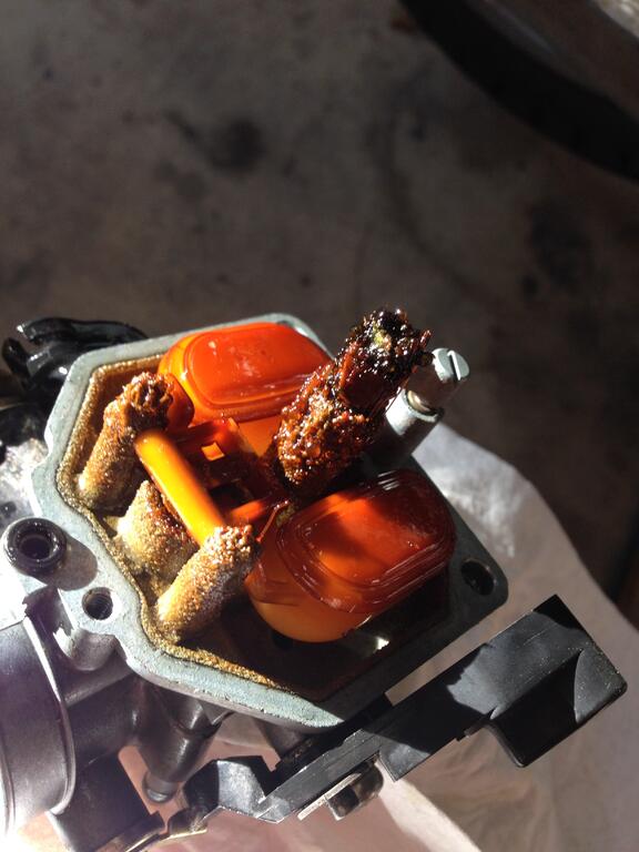

OoPEZoO 531 #6 Posted November 10, 2023 The worst I've dealt with was from an old 1985 Honda CB125 I have that had been kicked around the family for a few decades. At one point, my brother in-law had it and parked it without shutting off the gas, and it must have sat like that for a few years. It proceeded to evaporate the fuel in the carb, trickle more from the tank, and repeat until the entire fuel tank had evaporated. Its amazing what a few runs through an ultrasonic cleaner will do. Got it all cleaned up, back together and its been running great ever since. I wish I had a picture of the bowl side, but here is the main jet and float from it 2 Share this post Link to post Share on other sites
