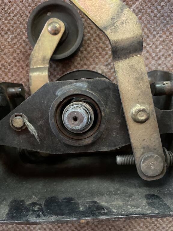

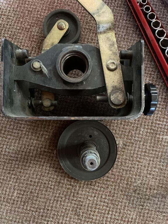

Wheel Horse312-8 2 #1 Posted November 8, 2023 I removed the front PTO cover and took off the pulley and it appears as if the shaft and bearings are shot. Any help with part numbers for replacement would be appreciated, tried on some of the parts listing but couldn’t figure it out. thanks Share this post Link to post Share on other sites

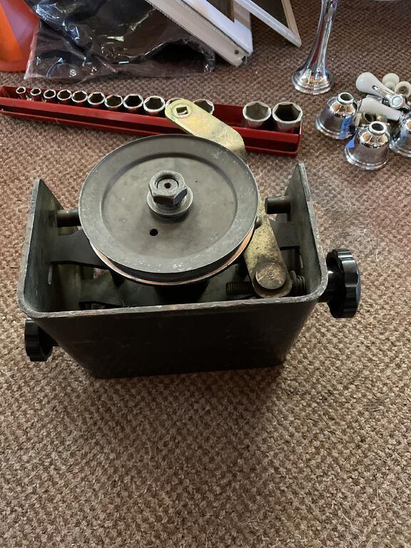

gwest_ca-(File Mod) 11,168 #3 Posted November 8, 2023 Without a model number and serial number this is a guess https://www.partstree.com/models/78292-toro-42-side-discharge-mower-deck-for-xt-series-tractors-sn-240000001-240999999-2004 Looks like the box is part of the mower deck. 1 Share this post Link to post Share on other sites
Ed Kennell 39,622 #4 Posted November 9, 2023 Toro Consumer Repair Part 106-5562 - PULLEY BOX ASM | PartsTree Wow, $1178 for an XT mule drive. Share this post Link to post Share on other sites
Wheel Horse312-8 2 #5 Posted November 9, 2023 Thanks for everyone's help! needed to reference mower deck, Not tractor, for part. 48" side discharge deck is part #78292, from there, got bearing #, Toro # 251-82, Stens # 203-202, or industry standard # 6205-2RS Ordered them on Amazon $9./pair Cleaned shaft, inside and outside of spacers will let you know when I put it back together Share this post Link to post Share on other sites
gwest_ca-(File Mod) 11,168 #6 Posted November 9, 2023 The 42" SD deck is model 78292 The 48" SD deck is model 78290 Probably makes no difference unless you need mower blades or belts. 1 Share this post Link to post Share on other sites
