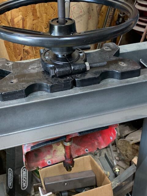

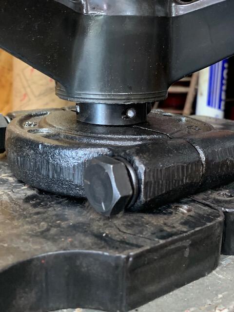

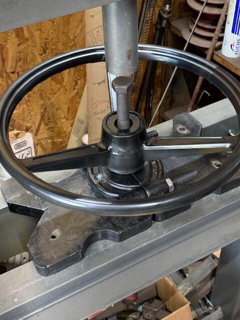

JoeM 7,889 #1 Posted November 6, 2023 This one finally almost beat me. Had this pretty nice steering wheel and wanted to save it. Did all the normal stuff, the pin can out but the wheel was stuck. Soaked, shocked, puller and no dice. I ended up removing the cap drilling out the excess plastic and put her in the press. 20T and is had to grunt a bit. I put a two piece sleeve on the shaft to get a close push fit along with the puller yoke. IMG_7448.mov 4 4 Share this post Link to post Share on other sites

ebinmaine 69,940 #8 Posted November 7, 2023 Nice save Joe. Appreciate the pics too. Good reference material for those who try it later. Share this post Link to post Share on other sites
JoeM 7,889 #9 Posted November 7, 2023 48 minutes ago, ebinmaine said: Good reference material for those who try it later. First one I had to press off. guess I've been lucky before. 1 Share this post Link to post Share on other sites
