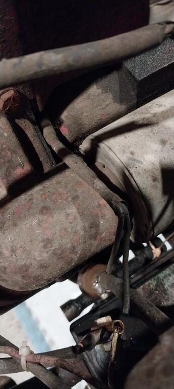

The charging system and the starting system or ignition system are completely different circuits
For charging there a system of coils called the stator. Under the flywheel.
What you want to check on those cut wires is for AC voltage. You will need a simple multi-meter to measure AC and DC voltage.
If those cut wires are putting out 30 ish AC volts then the stator and charging system will work with the addition of a rectifie/regulator. A rectifier will change that AC voltage to DC voltage which is what the battery is. Then you can use the multi-meter to measure the 12v DC out of the rectifier/regulator
First step is to test those wires for AC voltage.
Handy Don
If you can get the info (and a picture) off the engine spec plate, we can give you some more specific info. Also pictures of the wires on the engine!
Magneto and battery/coil engines can both use points (or some form of sensor/spark trigger) to control the spark timing.
Stators/magnet setups for generating electrical power from the spinning flywheel are common on both kinds of engines, too. Like @wallfish, I sense some problem with the stator(s) led the PO to give up on having the engine charge the battery. If you have working stator(s), then yes a rectifier or a voltage regulator (you don’t need both) could put you back in the battery charging business and maybe even give you enough extra juice for some LED lighting.
Check those stators! 😄 Look for AC voltage between the two wires and between each wire and ground. Let us know what you find.

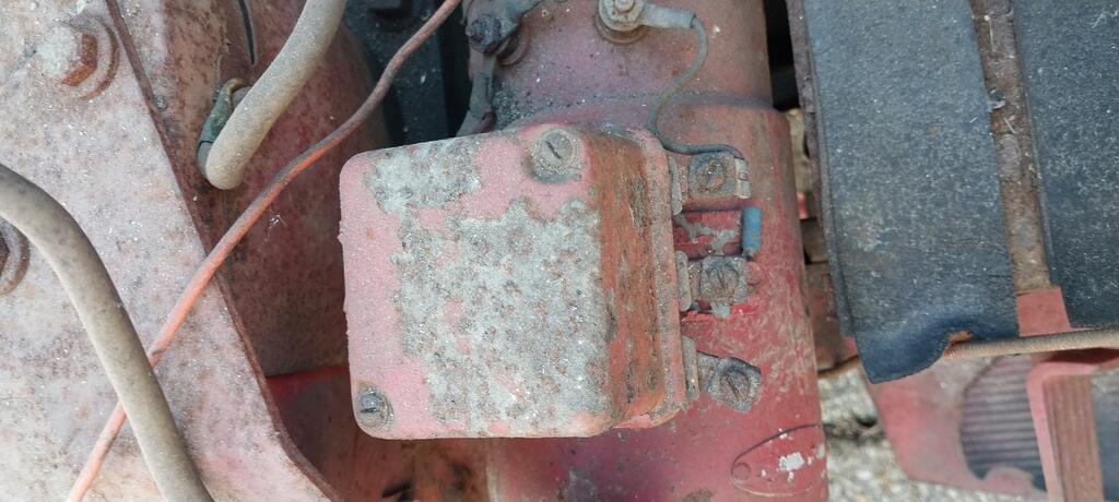

Ok, now that I've got daylight I took a picture and measured the voltage on the two wires coming from the engine. Its about 16.5 VAC on my Fluke multi-meter at a medium idle. I'm not sure is that's normal, low, or high, but its what I measure.
Here is a pic of the wires from the engine.

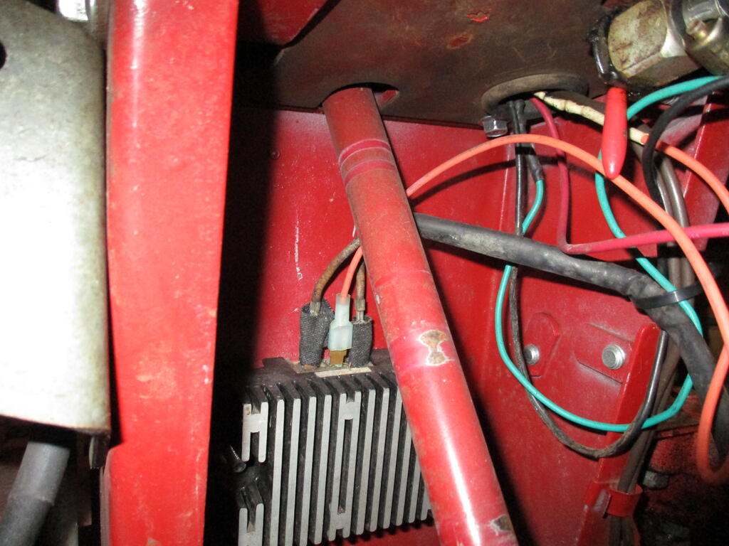

Believe it or not, the type of voltage regulator shown in your picture is usually very well sealed against the elements and its working parts may be pristine inside! I would not abandon that one for use on the S/G 1054 but rather clean it up and test it. Clearly, though, the terminals and external wiring need some attention!
Someone with specifc knowledge of the Charger will chip in and suggest the correct regulator. My instinct would be to post a “Want” in the classifieds as several vendors and members may have what you are looking for.
Edited by Handy Don

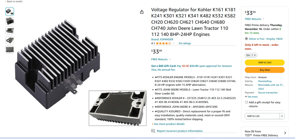

Can't use that regulator for the Charger
You need one like this.  note yours is a 10 amp system but you can use a 15 amp regulator  (usually cheaper easier to find)
Mount it inside the hood stand

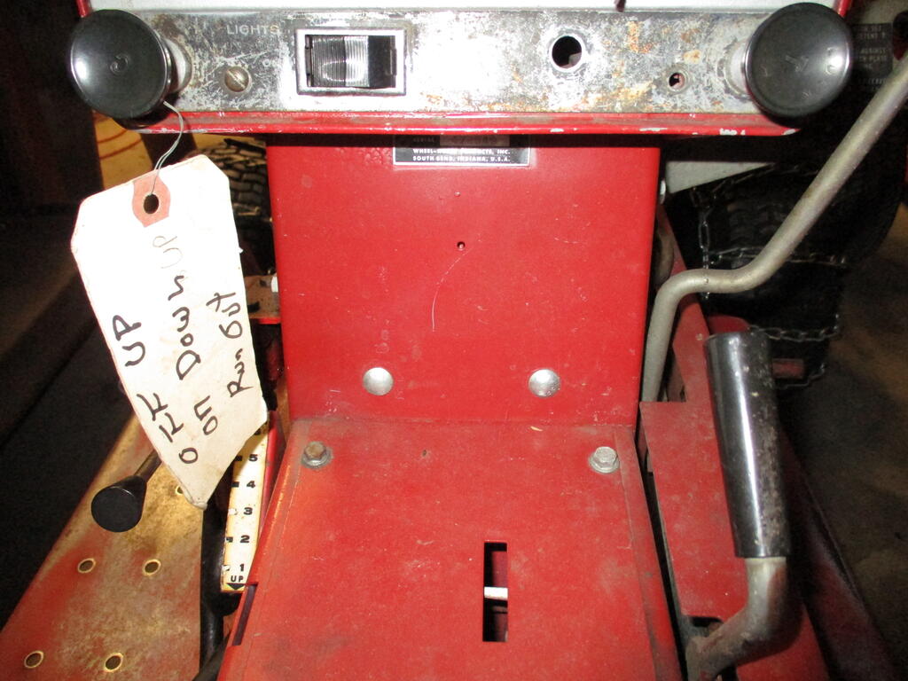

Look what I found! I've never looked up under the dash, I'm not sure how to get my hand up there? Time to get some wires to see it it works.

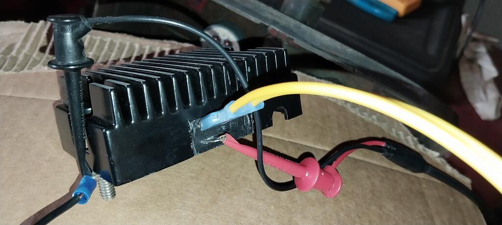

Ok, an update.

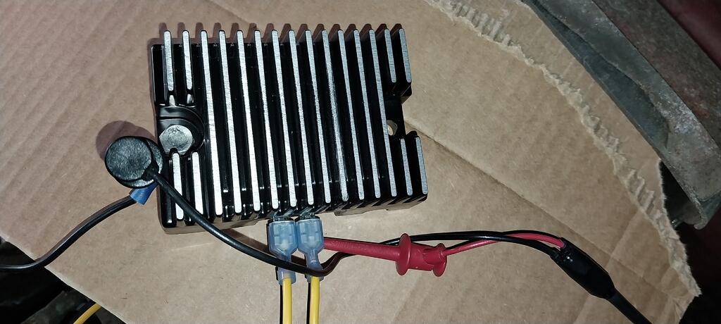

I wired up the old regulator and got nothing, about zero VDC. A new regulator arrived today from Amazon and after wiring it, all I got out was about negative 2.5 VDC, at full throttle, no load. I slapped a 10 ohm load resistor on it and the voltage went to zero. The negative voltage has got me scratching my head, I double checked my meter connects and they were correct polarity. The DC voltage did vary as the engine speed varied, so there seems to be some correlation with the AC.
The 2 AC leads from the engine read about 20 VAC and are attached to the AC leads on the regulator, I've got a bolt and wire from the regulator case to ground and put the meter across the regulator output and ground at the regulator case, seems pretty straight forward. I suppose the new regulator could be bad, but that would be just bad luck.
Any thoughts? Is 10 ohms too large a load, it would be about 1.2 amps, but this is a 10-15 amp regulator.

I'm not actually that connected at the moment, the regulator is isolated, connected only to the engine AC wires and a voltmeter on the regulator output. Also my key switch doesn't have a "run" position, I have a separate switch for engine (coil) on/off, the key switch just triggers the starter solenoid. Here are a couple pictures of the regulator connections. The yellow wires go to the engine stator and the black wire is grounded to the frame.

As noted earlier, it is MANDATORY to have a 12v battery (even one in not great condition) connected to the DC out terminal for the regulator to function properly. It’s likely that both regulators are working.
10Ω is not a problem as a load, but recognize that as long as it’s connected, it’ll be drawing current from either the stator (if it’s providing enough voltage) via the regulator or else the CONNECTED BATTERY.
Edited by Handy Don
Add a jumper from the DC+ to the battery (+)
Check voltage on that wire with engine not running.
Start engine - voltage should increase indicting it is charging.
The regulator must see battery voltage before it can regulate the charge current. Powers the regulator on so to speak.

I put a jumper to the battery and yup I got 12 volts with the engine off and 13+ something that varied with engine speed when it runs. That's good enough for me to wire it in and mount the rectifier/regulator tomorrow morning.
This has got me to thinking that the rectifier/regulator isn't a voltage regulator at all, but a current regulator, and its not acting like a dedicated battery charger would.
I assume that the rectifier DC output should wire to the coil side of the on/off switch so that the rectifier output is disconnected from the battery when the engine is off.

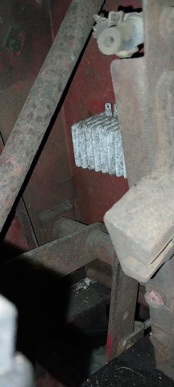

Just to close out this thread, thanks to everyone for their help. I've got everything wired & mounted, time will tell if this keeps my battery up, but the voltmeter indicates it should. The hardest part was working by feel to mount the regulator up under the dash area, I ended up getting some extra long carriage bolts for a better "feel", then used a deep socket.
