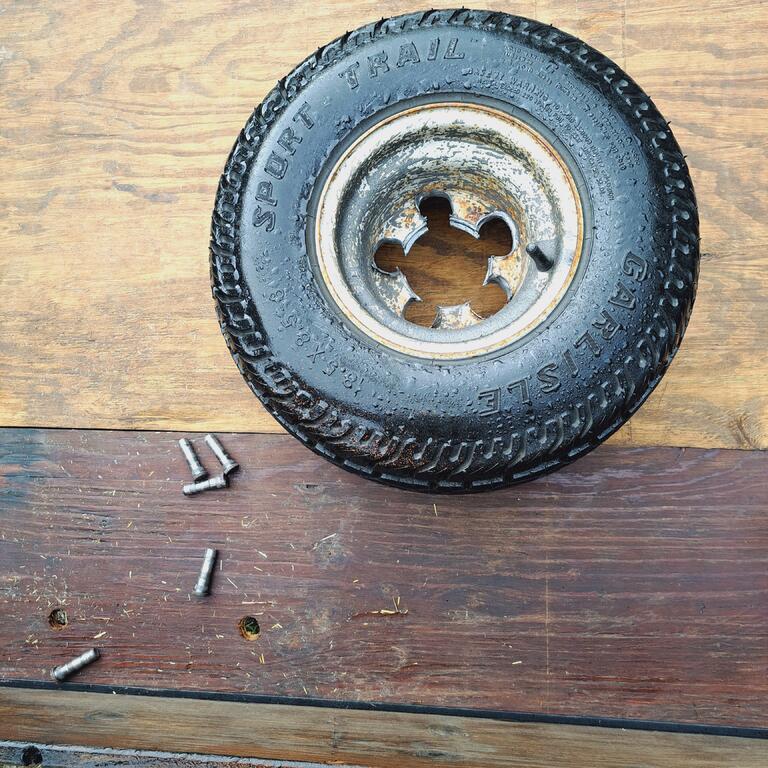

WHX?? 50,740 #1 Posted November 5, 2023 (edited) So 9 at nite this gal comes stumbling up my driveway phone flash lite just a blazing. Do you mind if we park our trailer in your driveway? Tire issues. Sure... pull it on in. Hubby pulls ahead a foot and tire falls right off. Wonder why? Lug studs all over the road. Pull it in the ditch I got another hub and get some tools. Oh no she says that won't do we have no time. We need to get to the tavern for their fish fry... I says I guess you didn’t have time to check your wheels then either. You couldn't hear this thing rattling 50 miles ago? No hubby snores pretty loud...Well I bet this woke him up! OK I says pull it well off the road then busy stretch here. He barely gets it off the asphalt. Yep you come and get it in the morning then. Edited November 5, 2023 by WHX?? 1 8 Share this post Link to post Share on other sites
Pullstart 64,573 #2 Posted November 5, 2023 Snowmobile trailer. They were probably spinning that poor thing thrice the recommended speed too! 5 Share this post Link to post Share on other sites
953 nut 57,932 #3 Posted November 5, 2023 Guess the crew chief and tire changer should have ti sit out the next two races like in NASCAR. 5 Share this post Link to post Share on other sites
WHX?? 50,740 #4 Posted November 6, 2023 (edited) So the next morning I hear some French and grunting coming from the ditch. So I tool down ther on the FEL and see what's goin on. Here hubby and his bro were trying to lift it on blocks had no jack. It was a lighter empty sno trailer Kev. My back hurt just watching them. First thing I says we need to get it off the road ... idiots fly through here at eighty. You guys ain't from around here are ya I says as I spy the fib plates. Well we figured it would be easier to work on pavement. Obviously no concern for ther own safety. So I pull it well in to the ditch, turn around and lift the side of the trailer up with the FEL so they can put their blocks in. Come git me when you get it fixed I'll get it back down. After some more French one comes stumbling up the drive. Did you say you had a hub? Oh balls here they thought they could put th old mangled studs back in with the splines gone and no threads left! Bearing cavity packed with dirt. Who knows what the splines looked like in the hub... they were packed full of dirt too. I says dude you gonna need a new hub. Lemme see what I got... I scrounge and find a POS. That I was saving for God knows what. No Timkens bro and innner races are shot I says but chrome don't git ya home. Being the nice guy I am I suggested they get a new assembly when you back to wherever you belong. How was the fish fry? Best I ever seen he says. Didn't have the heart to tell him the cook was out on work release. Least the guy asks whadda I owe ya. Nothing I says it was on the scrap pile...on the scrap pile did not register with him. Couple hours later I hear a bang. Musta been them pulling it off the blocks with the car. Good riddance I mumbled. Now you know the REST of the story! Edited November 6, 2023 by WHX?? 10 1 Share this post Link to post Share on other sites
953 nut 57,932 #5 Posted November 6, 2023 7 minutes ago, WHX?? said: Couple hours later I hear a bang. Musta been them pulling it off the blocks with the car. Good riddance I mumbled. Now you know the REST of the story! Not even a thank you or "I will be right back with a six pack"? 1 Share this post Link to post Share on other sites
lynnmor 7,566 #6 Posted November 6, 2023 Always, always keep some distance from any trailer, I think what you saw is the new norm. 3 Share this post Link to post Share on other sites
WHX?? 50,740 #7 Posted November 6, 2023 (edited) 30 minutes ago, 953 nut said: Not even a thank you or "I will be right back with a six pack"? Oh yes thank yous but no six pack as of this writing. Then again I didn’t do much to warrant it. I think I might have mentioned I drink Busch Latte when I handed him the scrap hub but??? I think I thanked him more for an otherwise boring Friday nite and the Saturday cartoons... So the thing was they had a spare bolted on the tongue but appeared to be flat. I mentioned I have two air compressors ... Edited November 6, 2023 by WHX?? 4 Share this post Link to post Share on other sites
WHX?? 50,740 #8 Posted November 6, 2023 (edited) 42 minutes ago, lynnmor said: Always, always keep some distance from any trailer, I think what you saw is the new norm. Exactly what I told the stony... I says your lucky that didn't come off on a major highway and go bouncing up thru mom's wind shield. Went in one ear and out the other me thinks. Edited November 6, 2023 by WHX?? 1 Share this post Link to post Share on other sites

Handy Don 13,340 #14 Posted November 7, 2023 Had it drummed into me by the dealer service manager when I bought a pop-up camper trailer years ago. He was seriously intense telling me "EVERY SINGLE TIME you stop for a leak or to change drivers, check the trailer wheels. Wiggle ‘em and check for bearing heat. Check the lugs and pressure before setting out (and if you find a loose lug, don’t just tighten it, find out WHY is is loose)." I was a noob so I listened and so far have never had a towing issue. 🤞 2 1 Share this post Link to post Share on other sites
WHX?? 50,740 #15 Posted November 7, 2023 I hear ya Don. Went to Horror Fright and bought cheapy torque wrench and some sockets. Permanent resident in the camper truck. Gets checked before every show and when packing up after show. Been known to offer it to bros in camp too. 1 Share this post Link to post Share on other sites
lynnmor 7,566 #16 Posted November 8, 2023 You can do everything right with trailer maintenance but the quality of the parts may still cause a breakdown. For example; I had brand new hubs, brakes and bearings that began to fail on the first revolution, the bearings were made poorly, I replaced them with Timken. Brakes are a joke as well, I have had 7" brakes fail in several ways and 10" brakes with numerous magnet issues. I could write a book on snowmobile, utility, popup, enclosed and travel trailers, they are all junk. Share this post Link to post Share on other sites
wh500special 2,249 #17 Posted November 8, 2023 (edited) 1 hour ago, lynnmor said: You can do everything right with trailer maintenance but the quality of the parts may still cause a breakdown. For example; I had brand new hubs, brakes and bearings that began to fail on the first revolution, the bearings were made poorly, I replaced them with Timken. Brakes are a joke as well, I have had 7" brakes fail in several ways and 10" brakes with numerous magnet issues. I could write a book on snowmobile, utility, popup, enclosed and travel trailers, they are all junk. Agreed. On a small trailer with 12” wheels I had brand new noisy bearings that I threw away after about 25 miles. Repacked them twice and no improvement. New ones were silent as they should be. I’ve never heard anything good about 7” brakes. Apparently almost universally problematic. I don’t do it yet, but eventually will get a complete replacement hub with bearings to carry with me for the boat trailer. Even with regular maintenance I always feel like I’m on borrowed time and destined for a breakdown on a dark, lonely, cold interstate highway. I carry extra bearings and a grease seal but can imagine something not working out that keeps me from making the repair. steve Edited November 8, 2023 by wh500special Share this post Link to post Share on other sites
