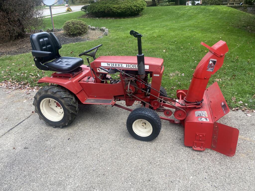

TonyBer 71 #1 Posted November 5, 2023 This is my first year with this snow thrower on this C-160. Today I was backing in the garage....back wheels up and over 1.75 inch lip and I happened to stop as the front wheels came into contact with the garage floor lip. From a dead stop, the transmission wouldn't pull the front wheels up and over the lip. Never had an issue with the transmission slipping or leaking and with the mower deck the machine works great. Obviously, with a little momentum (pulled forward and then back without stopping)...right up and over. Would anyone be concerned with the transmission slipping or is it unreasonable with weight of the thrower to pull the front wheels up and over garage floor lip from a dead stop and resting against the lip (about 1.75")? Is there any transmission adjustment? Thanks!!! Share this post Link to post Share on other sites

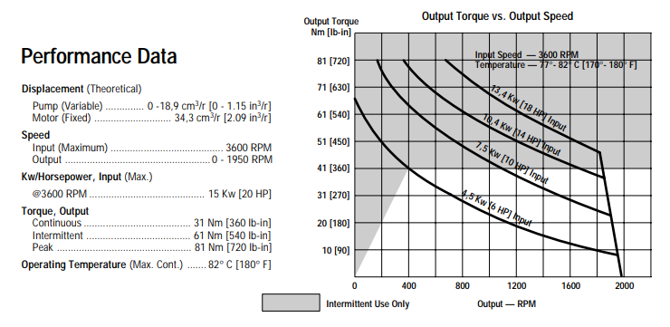

Handy Don 13,148 #5 Posted November 5, 2023 (edited) 35 minutes ago, JoeM said: remember the hydro only strokes about 2/3 rds in reverse. I’m not sure how the Sunstrands work internally, or how their linkages are set up. The Eaton 1100 gives nearly full torque even at the “slowest” speed.The motion control linkage geometry makes reverse a little less sensitive and not have the full range compared to forward. (Note that the pump/motor itself is symmetric with equal speed/power in both directions!) Edited November 5, 2023 by Handy Don 1 Share this post Link to post Share on other sites

JoeM 7,889 #7 Posted November 6, 2023 3 hours ago, Handy Don said: The Eaton 1100 gives nearly full torque even at the “slowest” speed Yes, but that is somewhat misleading. think about this, the manual says tie it to a tree to test the hydro. by setting the engine rpm to half and moving the control valve fully forward. The rear wheels should break loose and spin. If that is all that is needed to achieve max torque there would be no need to increase the lever toward the full stroke position. The wheels would spin at just the slightest control movement. By increasing the stroke we apply torque. That is why the engine governors grunt when we stroke the control lever. Remember hydro is a conduit to take the power from the engine to the rear wheels. In reverse we limit the stroke to control the speed. And subsequently limit the torque. that and 2 bucks might get you cup of coffee. 1 Share this post Link to post Share on other sites
