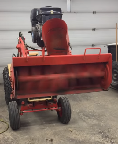

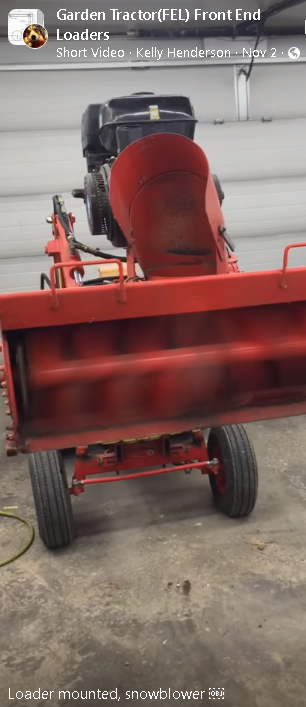

JoeM 7,924 #1 Posted November 3, 2023 (edited) I like this https://www.facebook.com/reel/705978611421978 Edited November 3, 2023 by JoeM 5 Share this post Link to post Share on other sites
rjg854 11,879 #2 Posted November 3, 2023 Nice build! Would work nice getting rid of snowbanks, seems like it would be hard to see around it though. 2 1 Share this post Link to post Share on other sites
JoeM 7,924 #3 Posted November 3, 2023 2 minutes ago, rjg854 said: Nice build! I thought so too. I know some have adapted push blades to the their bucket and this in big snow country might just be the bomb. It was posted by Kelly Henderson over on my FB FEL Group Share this post Link to post Share on other sites

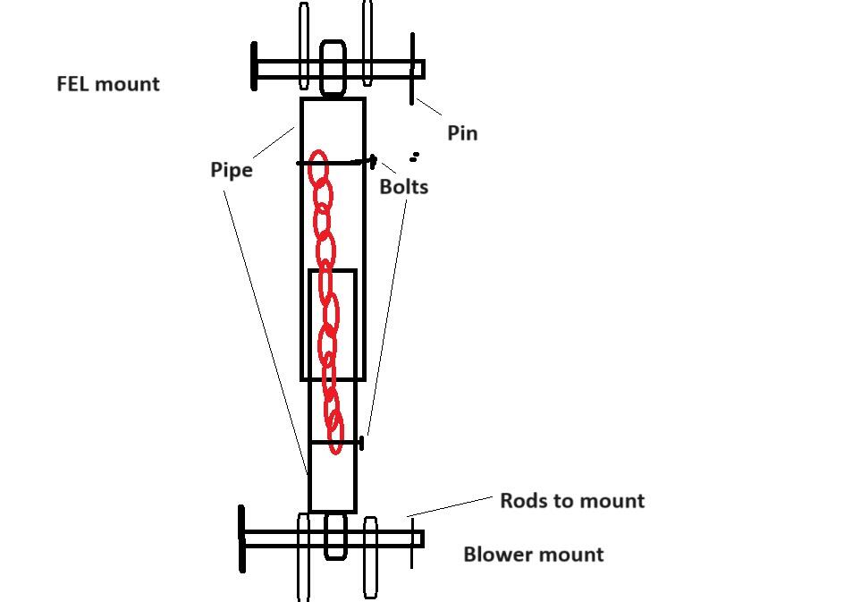

wallfish 17,487 #4 Posted November 3, 2023 I like the ingenuity but it needs to be much wider unless it's only blowing in straight lines. That far out front will leave the 1/2 the tractor out in the snow as it turns. It definitely has it's place depending upon the situation. I hand mine connected directly to the tractor as normal and used the FEL to lift and lower it. The FEL made it so quick and easy to install and disconnect that the bucket could still be used. Quick attach, belt and 1 pin. Connect the pin for the lift, lift the blower to easily snap into the quick attach and connect the belt. About 2 minutes on or off. I wanted down pressure instead of just using a lift chain so put a chain inside of pipes to allow for some float without the FEL weight on it but could also add the FEL weight for scraping ice/packed snow. A solid link could just use the float on the FEL but that's a lot weight all the time. Just a chain and no FEL down pressure on it 4 1 Share this post Link to post Share on other sites

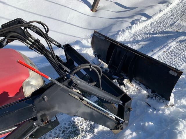

ebinmaine 70,718 #5 Posted November 3, 2023 1 hour ago, rjg854 said: Nice build! Would work nice getting rid of snowbanks, seems like it would be hard to see around it though. Agreed!! I can see your logic about the line of sight but it really wouldn't be as bad as you think, particularly once you got used to understanding where everything is. 1 hour ago, JoeM said: I thought so too. I know some have adapted push blades to the their bucket and this in big snow country might just be the bomb. Thanks for sharing this. I got the push blade that goes with the Front End Loader from @wallfish Not to put words in John's mouth but I think he told me he just left the bucket on because he found it functioned about the same as a snow plow blade. Having used the machine for some snow removal last winter, I agree. I've considered turning the push blade frame into a small set of forks. 1 Share this post Link to post Share on other sites

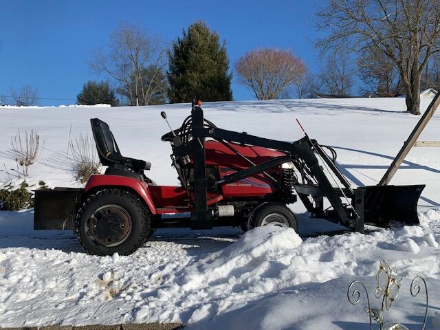

JoeM 7,924 #6 Posted November 3, 2023 I don't have a blower but use a blade that is swiveled by hydraulics. Angling of the blade worked best. My bucket it easy connect and use a trailer hitch square tube as a receiver for the blade when the bucket is removed. 3 Share this post Link to post Share on other sites
