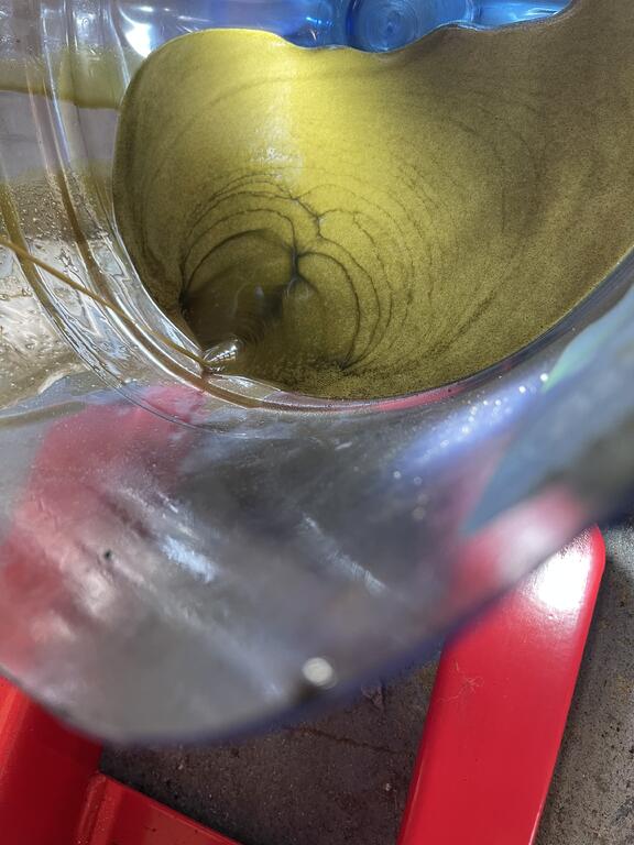

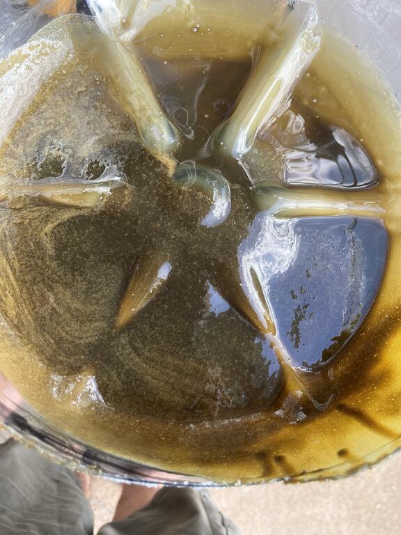

Wheelhorse#1 1,761 #26 Posted October 28, 2023 WHX correct about ACR.I didn’t know this until I looked through the manual. I was a only getting 30# reading with the bad head gasket. Today I ran it,went through all the gears with no problems. cleaned the tank, replaced the gas lines and changed the oil. Now I’m draining the last bit of devil snot out of the tranny. I raised the front to get the last bit of gunk out. 1 Share this post Link to post Share on other sites
kpinnc 13,732 #27 Posted October 28, 2023 13 minutes ago, Wheelhorse#1 said: Now I’m draining the last bit of devil snot out of the tranny. Actually not too bad. Probably the same oil that it left the dealership with... When it looks like chocolate milk, that's when I'd be concerned. That just looks like mostly old gear oil. 2 Share this post Link to post Share on other sites
ebinmaine 70,742 #28 Posted October 28, 2023 1 hour ago, kpinnc said: Actually not too bad. Probably the same oil that it left the dealership with... When it looks like chocolate milk, that's when I'd be concerned. That just looks like mostly old gear oil. Seconded. Chocolate milk or delicious thick coffee. 1 Share this post Link to post Share on other sites
Wheelhorse#1 1,761 #29 Posted October 28, 2023 2 hours ago, kpinnc said: Actually not too bad. Probably the same oil that it left the dealership with... When it looks like chocolate milk, that's when I'd be concerned. That just looks like mostly old gear oil. I agree. No water in it all far as I could tell or metal flakes. There’s nothing like the smell of ancient gear oil. 1 Share this post Link to post Share on other sites
