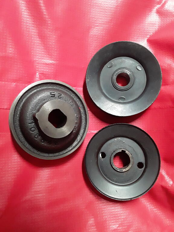

76c12091520h 3,747 #8 Posted October 20, 2023 These are your options for 42" side discharge outer pulleys . ALL are dimensionally the same except the center hole. There is no other option from Toro/ Wheel Horse unless you start swapping pulleys from other decks, and even then the center hole choices are the same, just the outer diameter is different. 1 Share this post Link to post Share on other sites

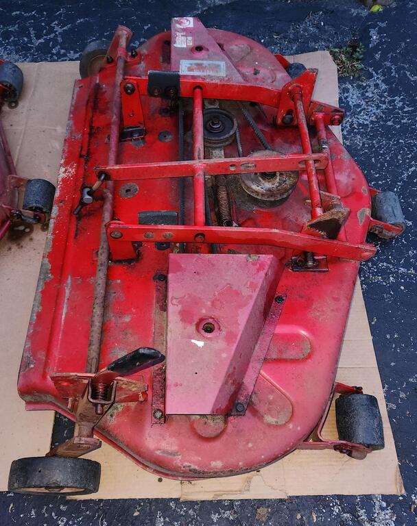

Brockport Bill 1,815 #10 Posted October 20, 2023 3 hours ago, peter lena said: @Brockport Bill how do related BEARINGS FEEL ? spindle bearing failure / increased rotational drag , is the killer of belt driven anything . my decks spin / move by hand at the PTO / MUEL BELT DRIVE AREA . good opportunity for a bearing , clean out and a re grease . 540 deg drop temp , with LUCAS EXTRA HD , GREEN CHASSIS GREASE . quiet bearings , smooth easy rotation . you are in the area . make the problem go away , Pete thanks Pete -- doing as you prescribe -- doing rehab now of 42 s.d. deck -- including rebuild of spindles including using your bearing suggestions I have read over the past couple years -- i just did another deck a 42" rear discharge over past few weeks -- came out terrific - of course its a nightmare getting the old pulleys off the shafts - here are some before and after photos of deck i just finished 1 Share this post Link to post Share on other sites
peter lena 9,051 #11 Posted October 20, 2023 @Brockport Bill very nice job on that ! never had a pulley hang on like that one ! was always taking advantage of a common failure on the decks . once I got it zeroed in , did that to the other 2 decks . your under deck finish looks very good ,your 2nd down picture is how I prop them up to the sun after inspection , metal gets hot , breaks the grunge cycle , think thats the extra help on the decks , have also experimented with the IDLER PULLEY SPRING ,and its reaction to different tensions , has changed to a very solid / smooth action , with practically no bounce to it at all. having worked on many linkage areas , they really lacked a detail , operational tune up .spend time on any problem , with a look / see ,change / improvement trial . basically when you firm things up ,washers , etc. And change out the lubricant , the movement goes from a rock in a garbage can , to smooth / solid . always looking for another tweak area , to see what I can improve , love making a problem into a bombproof action of the horse ,shout back anytime , pete Share this post Link to post Share on other sites
Brockport Bill 1,815 #12 Posted October 20, 2023 49 minutes ago, peter lena said: @Brockport Bill very nice job on that ! never had a pulley hang on like that one ! was always taking advantage of a common failure on the decks . once I got it zeroed in , did that to the other 2 decks . your under deck finish looks very good ,your 2nd down picture is how I prop them up to the sun after inspection , metal gets hot , breaks the grunge cycle , think thats the extra help on the decks , have also experimented with the IDLER PULLEY SPRING ,and its reaction to different tensions , has changed to a very solid / smooth action , with practically no bounce to it at all. having worked on many linkage areas , they really lacked a detail , operational tune up .spend time on any problem , with a look / see ,change / improvement trial . basically when you firm things up ,washers , etc. And change out the lubricant , the movement goes from a rock in a garbage can , to smooth / solid . always looking for another tweak area , to see what I can improve , love making a problem into a bombproof action of the horse ,shout back anytime , pete i rescued that 42 rd mower deck which had been left outdoors by prior owner -- i tried EVERYTHING to get off the pulleys -- they were rusted on there like super glue -- I used one week of repeated penetrant - plus heat, plus pry bars, etc -- nothing worked so Red SQ folks said cut them off - which is real challenge to do without damage to spindle shaft - in one case i got off with no damage but damaged the other - UGH !! 1 Share this post Link to post Share on other sites
