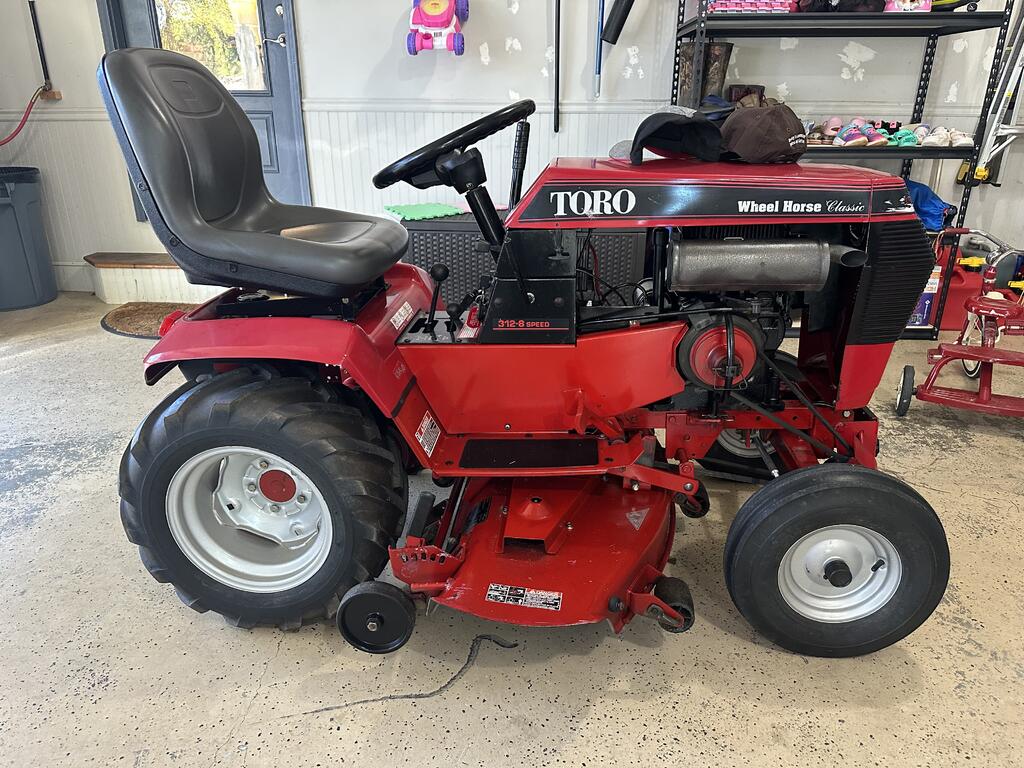

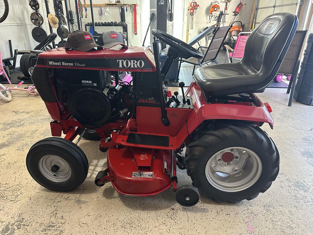

Sailman 1,299 #35 Posted October 21, 2023 Wow! That looks to be in GREAT condition. Congratulations on a good find. Enjoy. 1 Share this post Link to post Share on other sites
Ed Kennell 40,531 #36 Posted October 21, 2023 She looks great. You made the right choice. 3 Share this post Link to post Share on other sites
peter lena 9,093 #37 Posted October 21, 2023 @KVustrud agree on the looks / condition , make the thought to maintain that look / condition . would personally stay away from a bagger , basically a rot box on wheels , rarely looked at / serviced / cleaned out . recent experience with a bagger / horse , sold the " bagger / rotted deck " for parts .just my own thought on a recovery. experiment with deck cutting height ,the higher the better discharge , and less build up under the deck .good looking unit , Pete 1 Share this post Link to post Share on other sites
KVustrud 92 #38 Posted October 21, 2023 The tire wheel combo looks so good! I can’t believe how smoothly the deck runs! 3 Share this post Link to post Share on other sites
peter lena 9,093 #39 Posted October 21, 2023 @KVustrud SMOOTH RUNNING DECK ? wow , sounds like past owner stayed after it , correct lubricants . you might ask past owner what he used / did for easy deck operation . good looking belts , says a lot . also note washed up TRUNNION on PTO lever rod end. no sloppy play , the details are telling you about care , stay after what ever he did , Pete 1 Share this post Link to post Share on other sites
