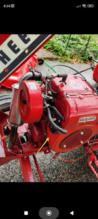

carlosking450 155 #6 Posted October 28, 2023 Hello again, I have looked at photos of other Wheel Horses and I noticed this fuel pump, could it be fitted to any engine? What do they need for it to work? Thanks again, greetings from Spain! 1 Share this post Link to post Share on other sites
953 nut 57,998 #7 Posted October 28, 2023 5 hours ago, carlosking450 said: Hello again, I have looked at photos of other Wheel Horses and I noticed this fuel pump, could it be fitted to any engine? What do they need for it to work? Thanks again, greetings from Spain! A picture would be helpful 1 Share this post Link to post Share on other sites
953 nut 57,998 #9 Posted October 29, 2023 That is a vacuum operated fuel pump which would be connected to the engine block and be operated by the change in pressure in the crankcase. Onans and lots of other engines use them. 1 Share this post Link to post Share on other sites
carlosking450 155 #10 Posted October 29, 2023 On my Kohler K161, it covers the original pump housing. If I put a connection on that cover, could I install a vacuum pump? 1 Share this post Link to post Share on other sites
wallfish 17,514 #11 Posted October 29, 2023 1 hour ago, carlosking450 said: On my Kohler K161, it covers the original pump housing. If I put a connection on that cover, could I install a vacuum pump? Yes Share this post Link to post Share on other sites
Handy Don 13,340 #12 Posted October 29, 2023 10 hours ago, carlosking450 said: On my Kohler K161, it covers the original pump housing. If I put a connection on that cover, could I install a vacuum pump? 8 hours ago, wallfish said: Yes Be sure to use sturdy-walled tubing between the cover connector and the pump 1 Share this post Link to post Share on other sites
